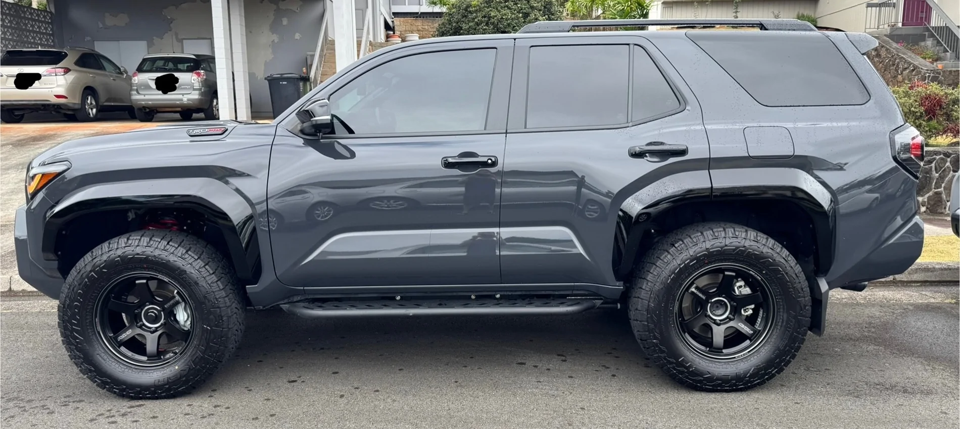

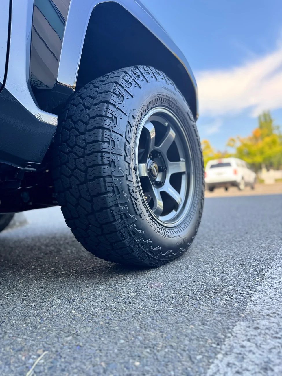

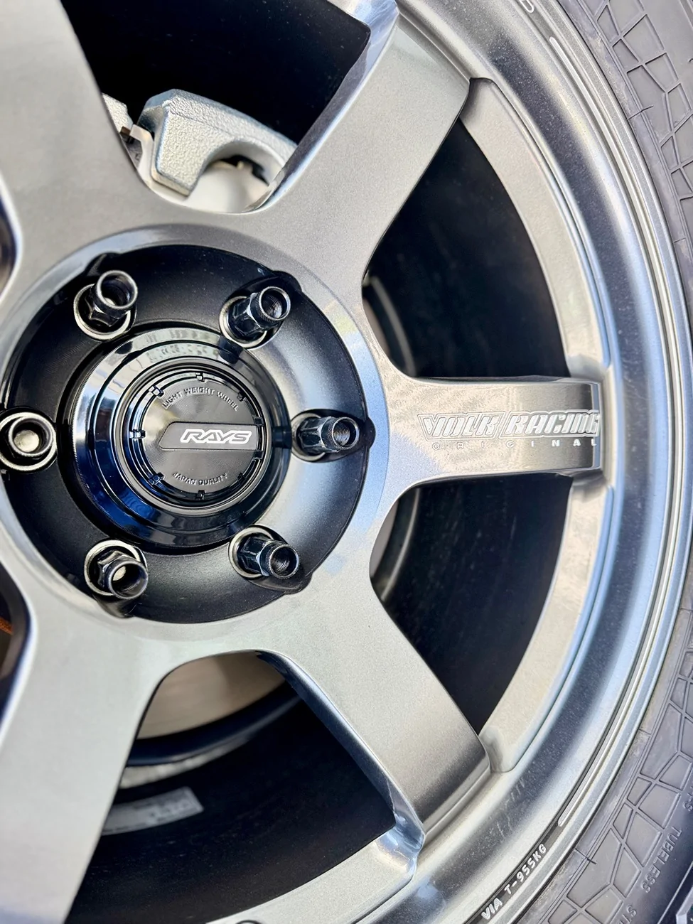

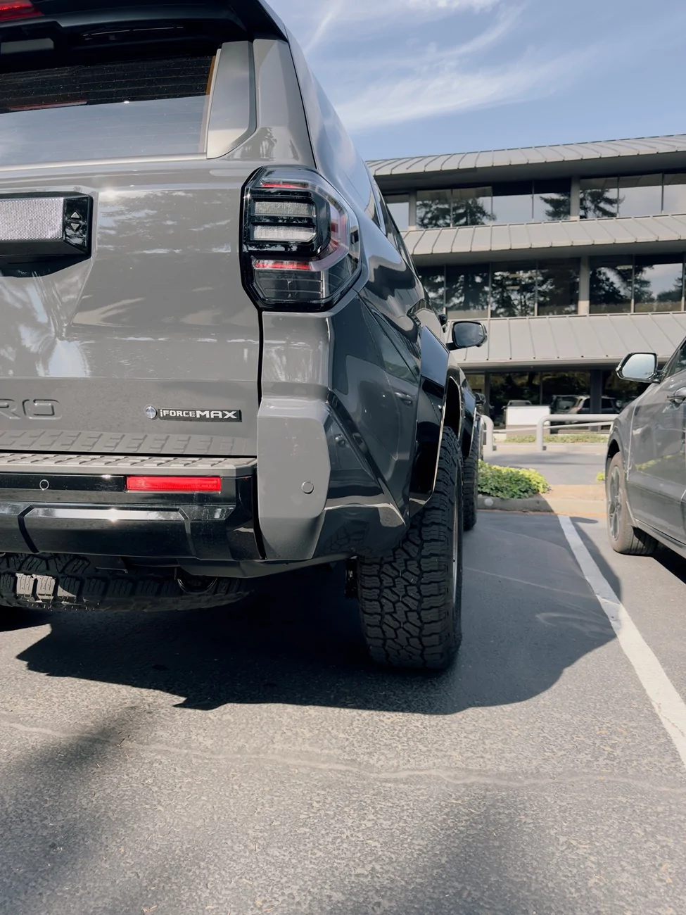

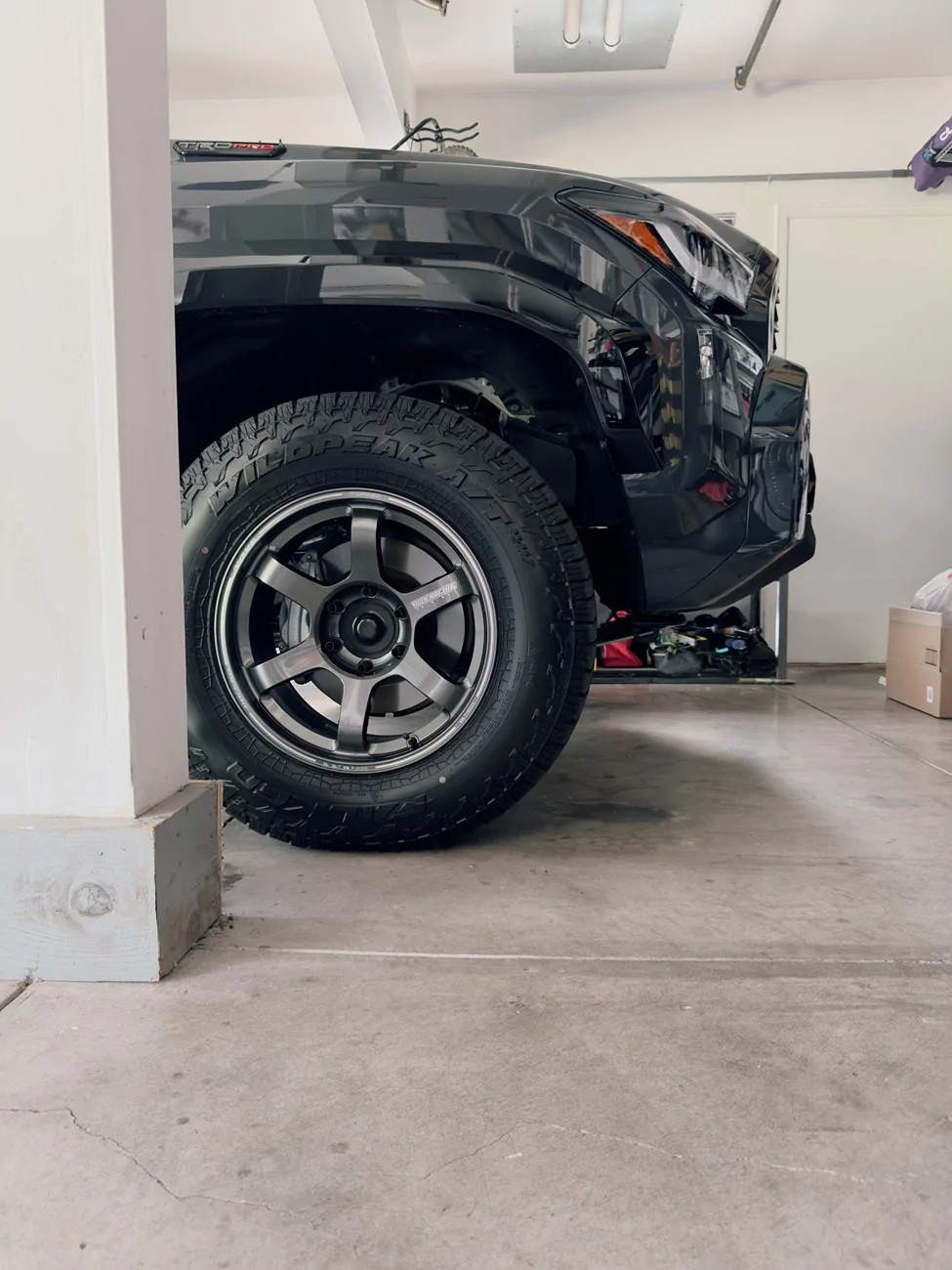

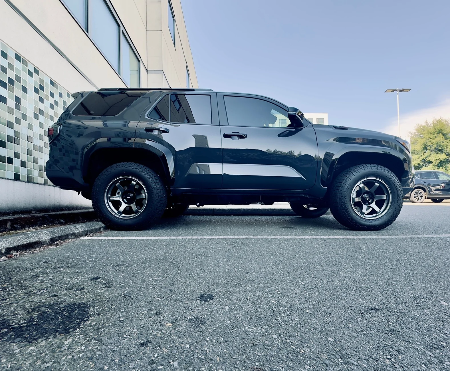

2025 Underground Pro
Tires: Falken AT4W 285/70r18 C-rated
Wheels: Volks TE37SB 18x8.5 +22 in Black Shadow LTD finish (translucent matte)
Lift: Peak suspension 1 inch spacer lift in front
Slider is Greenlane offroad’s aluminium slider (25 lbs each). I don’t offroad so I didn’t want the weight but I did want the shopping cart protection lol.
Install by Autocustoms in Honolulu, HI.

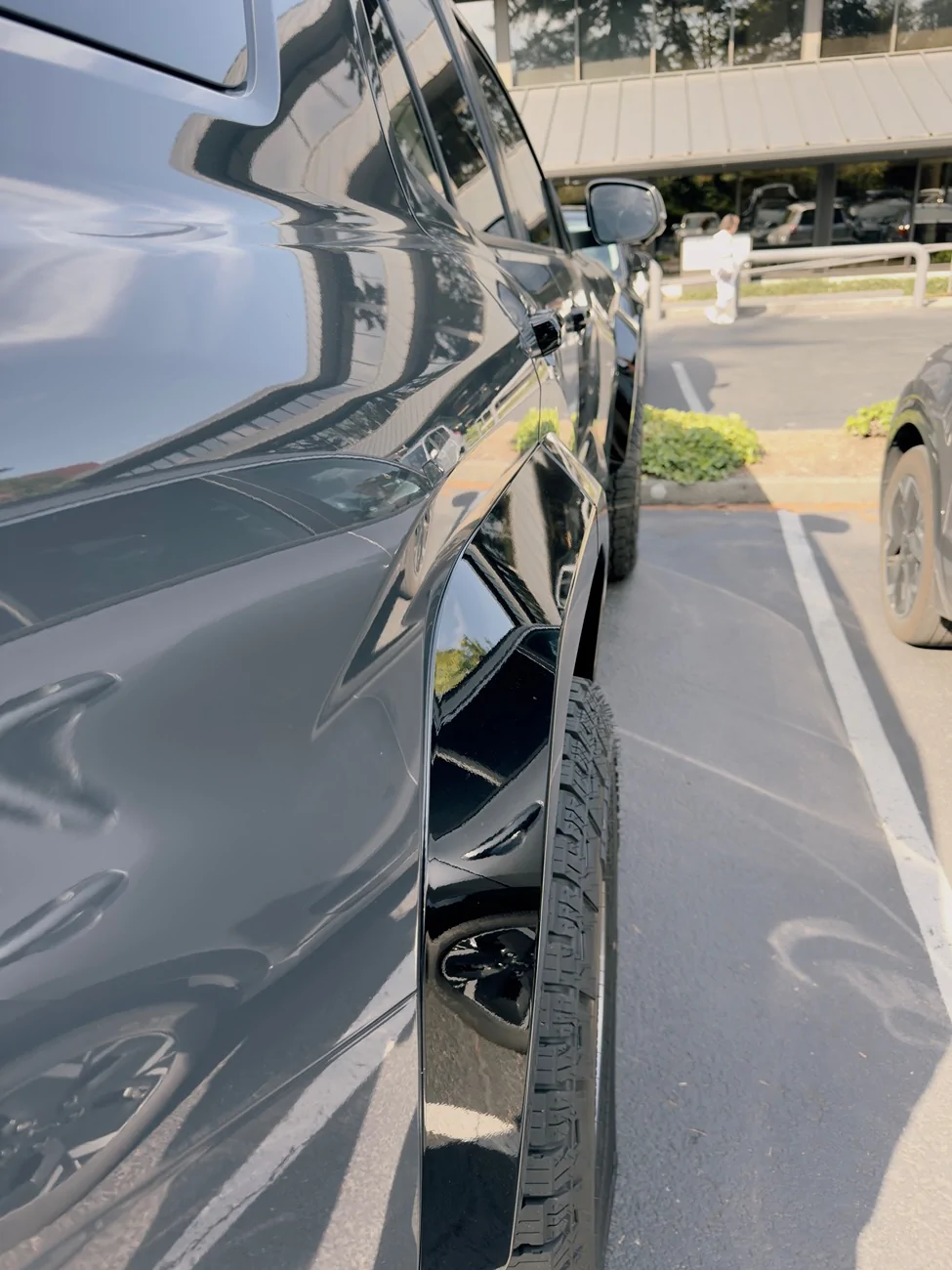

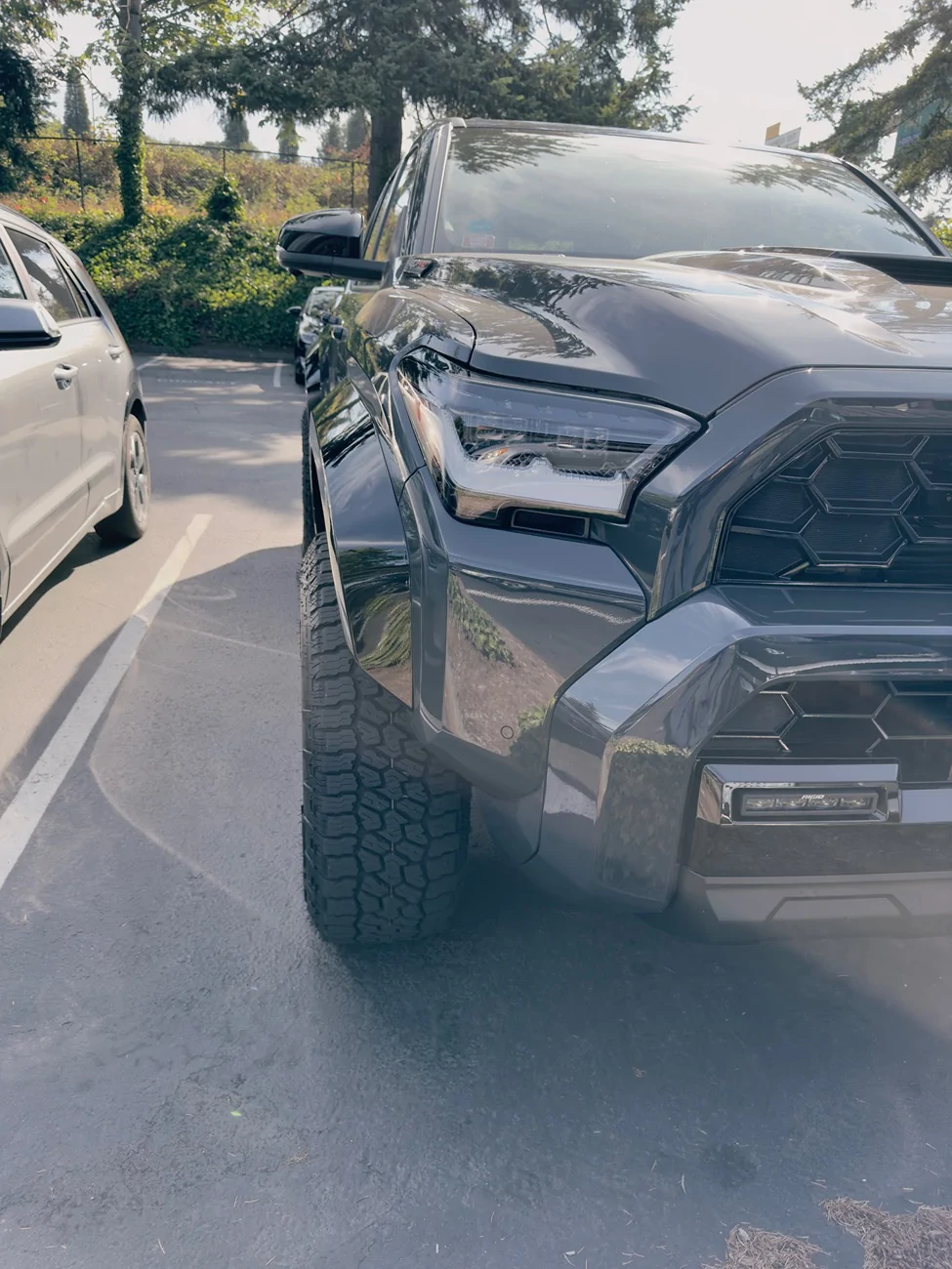

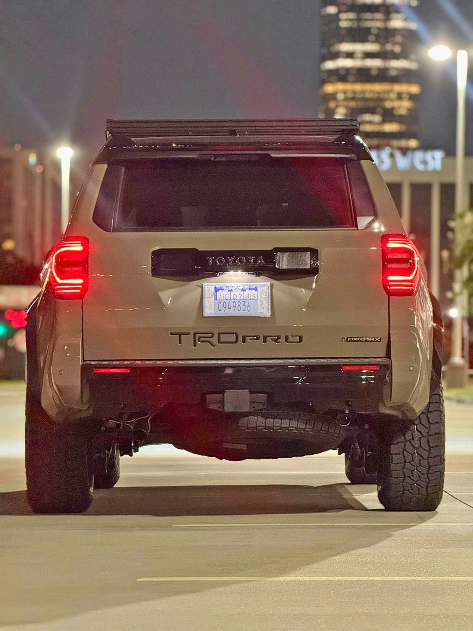

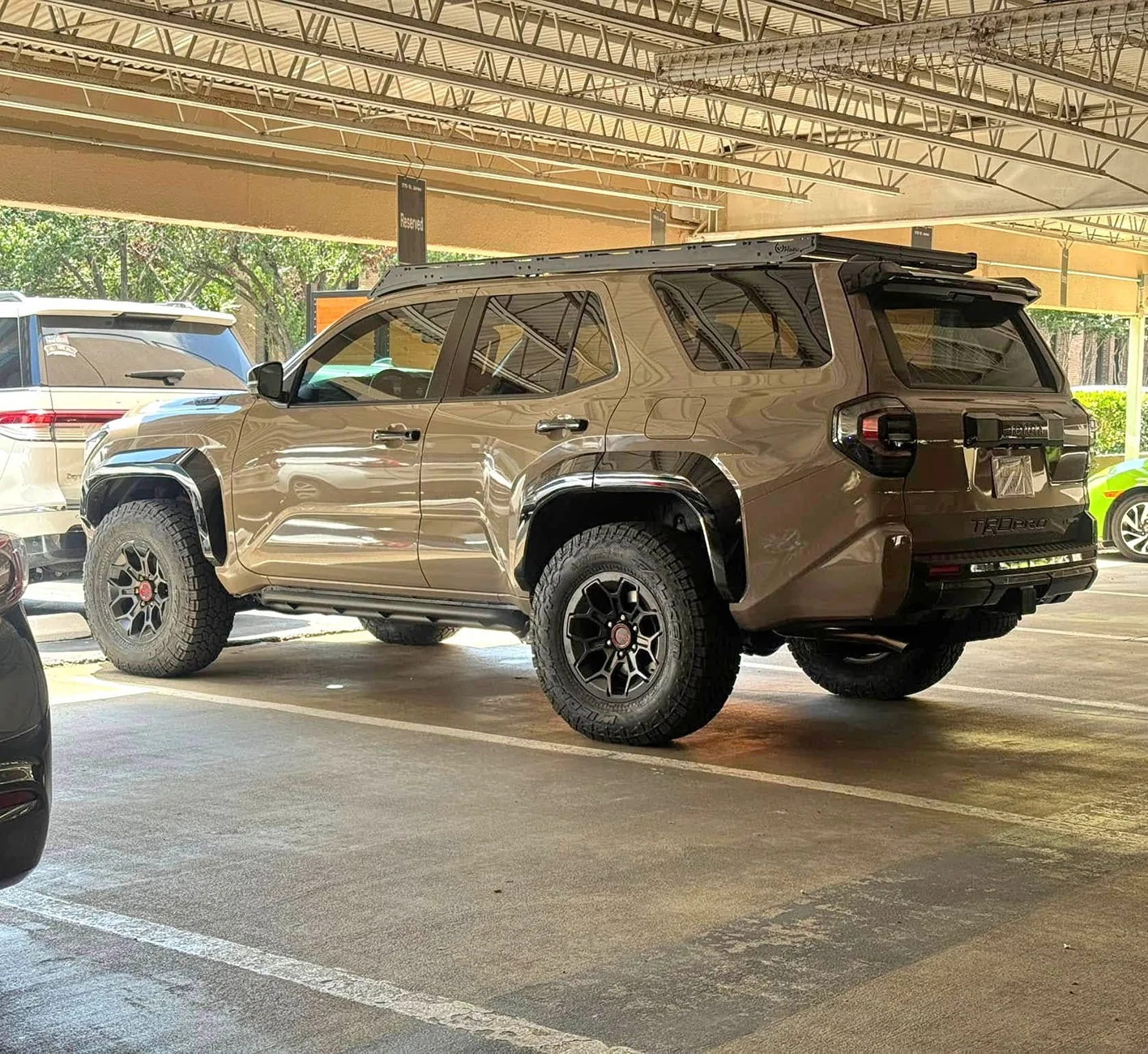

Saw this stock 6th gen TRD Pro posted with Falken Wildpeak AT4W 285/70/18 tires (no lift). The owner Christopher M. said:
285/70/18 are just right on the 6th. No removing of the "crash bar" nonsense to fit tires that don't fit. All fender liners intact. The faintest of rub on the fender liner if turning and hitting a dip at line 5-10mph - but so minor it's not even worth adjusting (removing or cutting) the liner. (y)
The spare tire is still OEM tire, however.

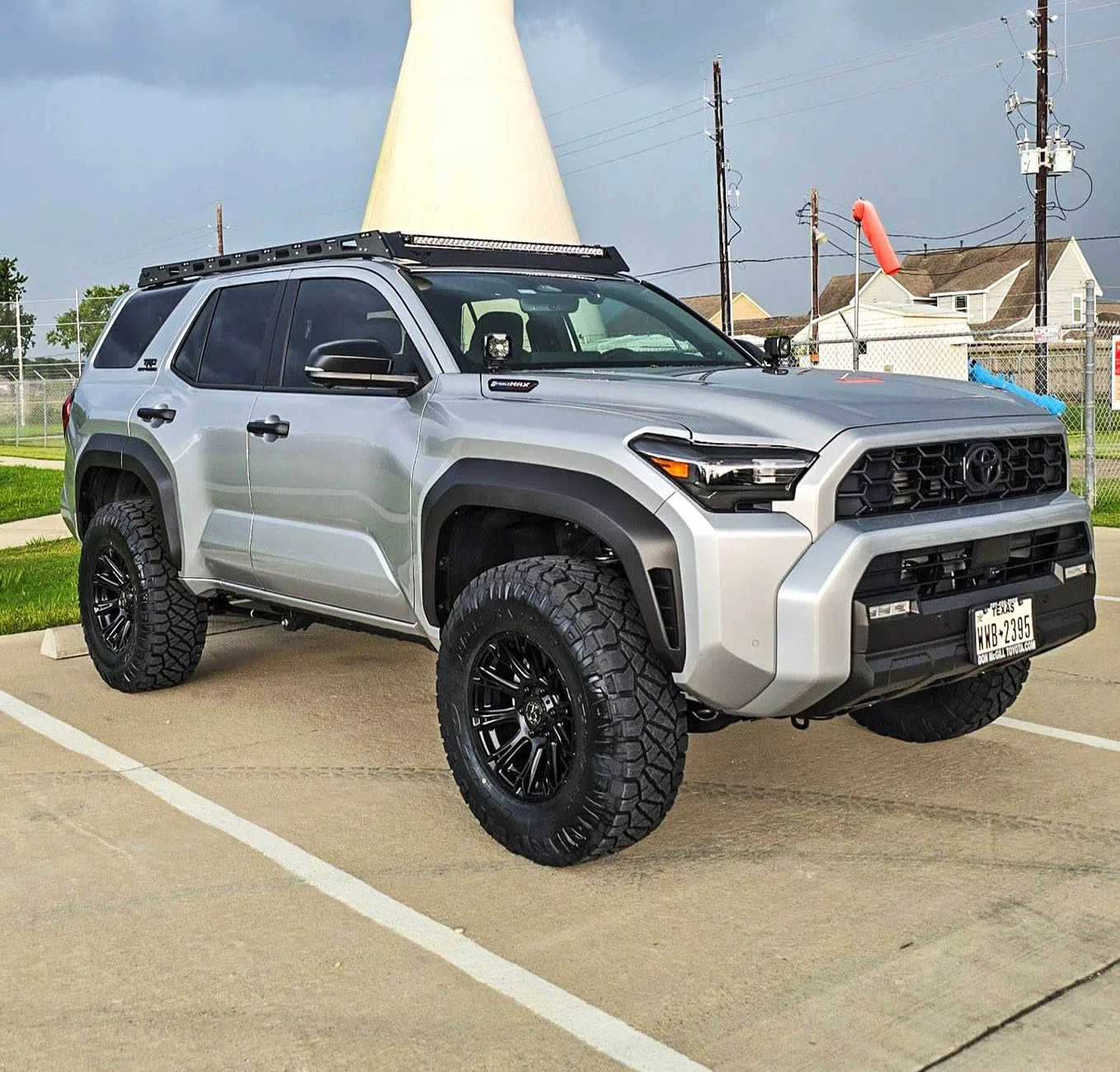

2025 TRD Off-Road 6th Gen on
Lift: 2.5" Ready lift
Wheel: Black Rhino Diamondbac 17x9 (+12 mm offset)
Tire: 285/75/17 Nitto Ridge Grappler
Other mods:
Roof rack: Victory 4x4
Ditch light: Hella Xtreme XT 3"

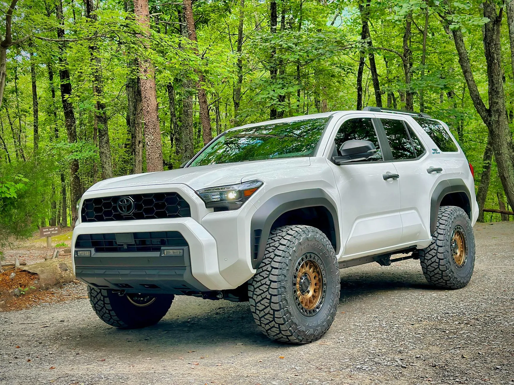

Incoming 2025 4Runner TRD ORP
Ice Cap TRD ORP
Westcott 2.5/.75 lift
KMC IMS 17x8.5 +25 offset bronze wheels
35" Toyo Open Country RT Trail 35x12.5r17 (35's)

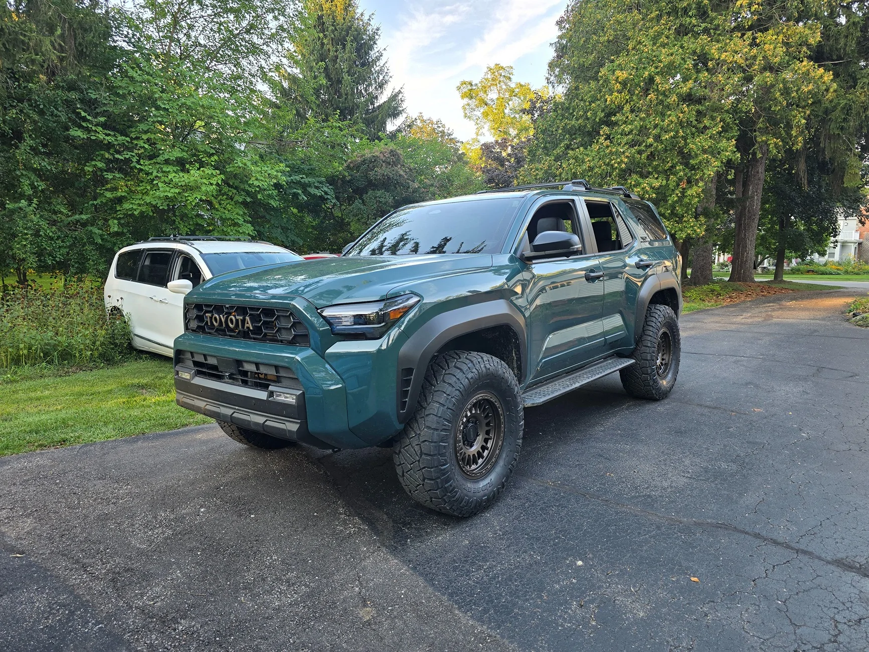

Continental TERRAIN CONTACT A/T LT265/70-17E 121S
LT type, E sidewalls. Has deeper tread depth than the next best available size.
255/75 R17 tread depth 12/32"
LT265/70 R17 tread depth 16/32"
Original SR5 17 inch wheels & stock suspension, no lift, spacers, offset, nothing. Mudflaps still on.
I just wanted a little bigger for looks and better snow & mud tread because the factory geolander were like car tires. And Continental are excellent in rain.
I didn't want to change anything else, no new wheels with a different offset, no lift or spacers etc, and didn't want them actually oversized for the wheel wells, just a bit bigger and more tread.
Completely happy with them, looks and performance.
