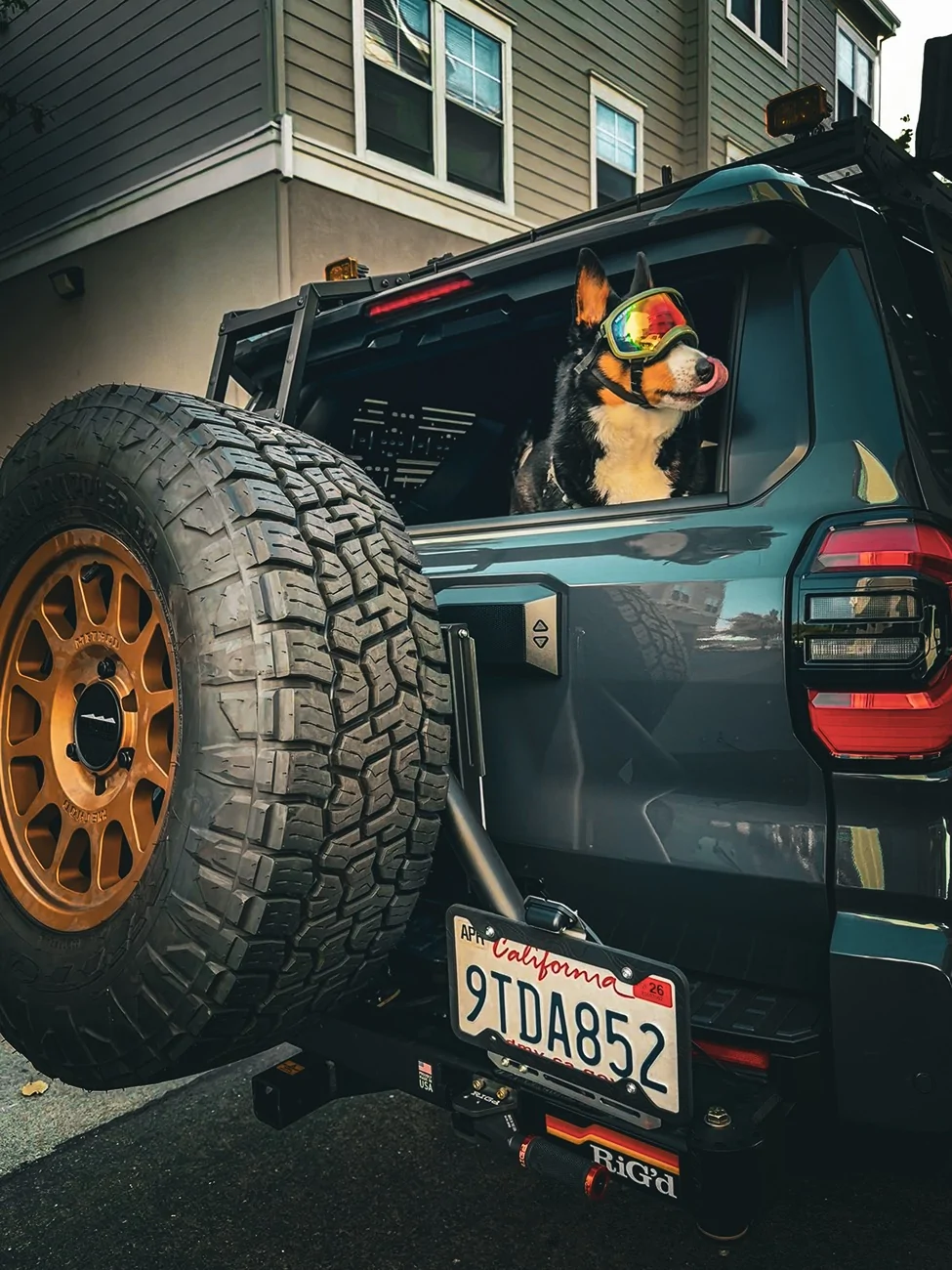

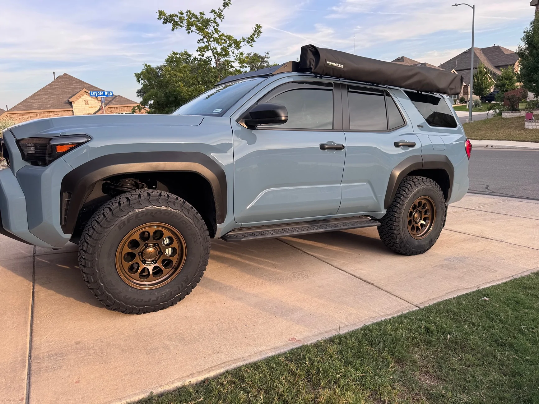

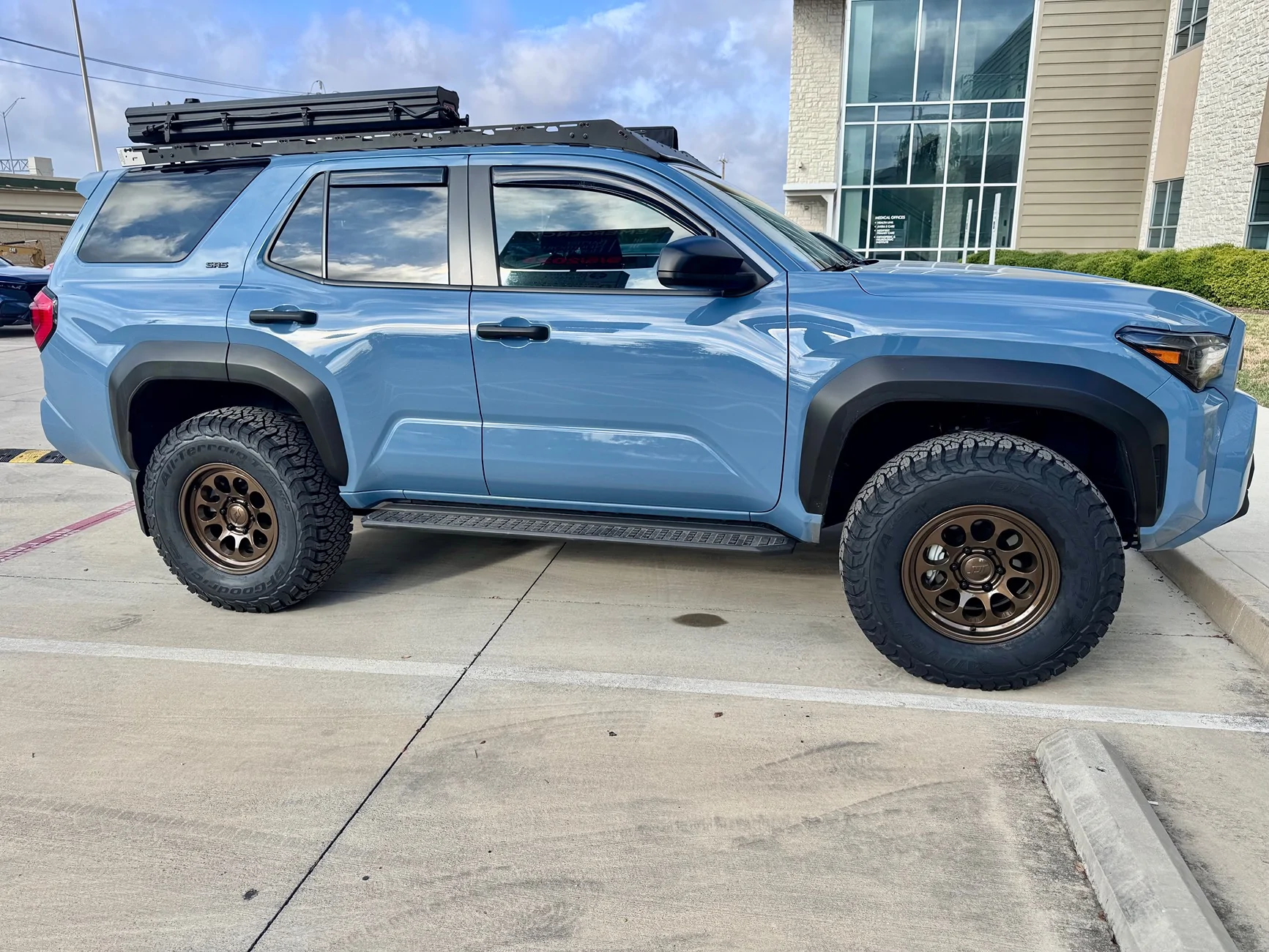

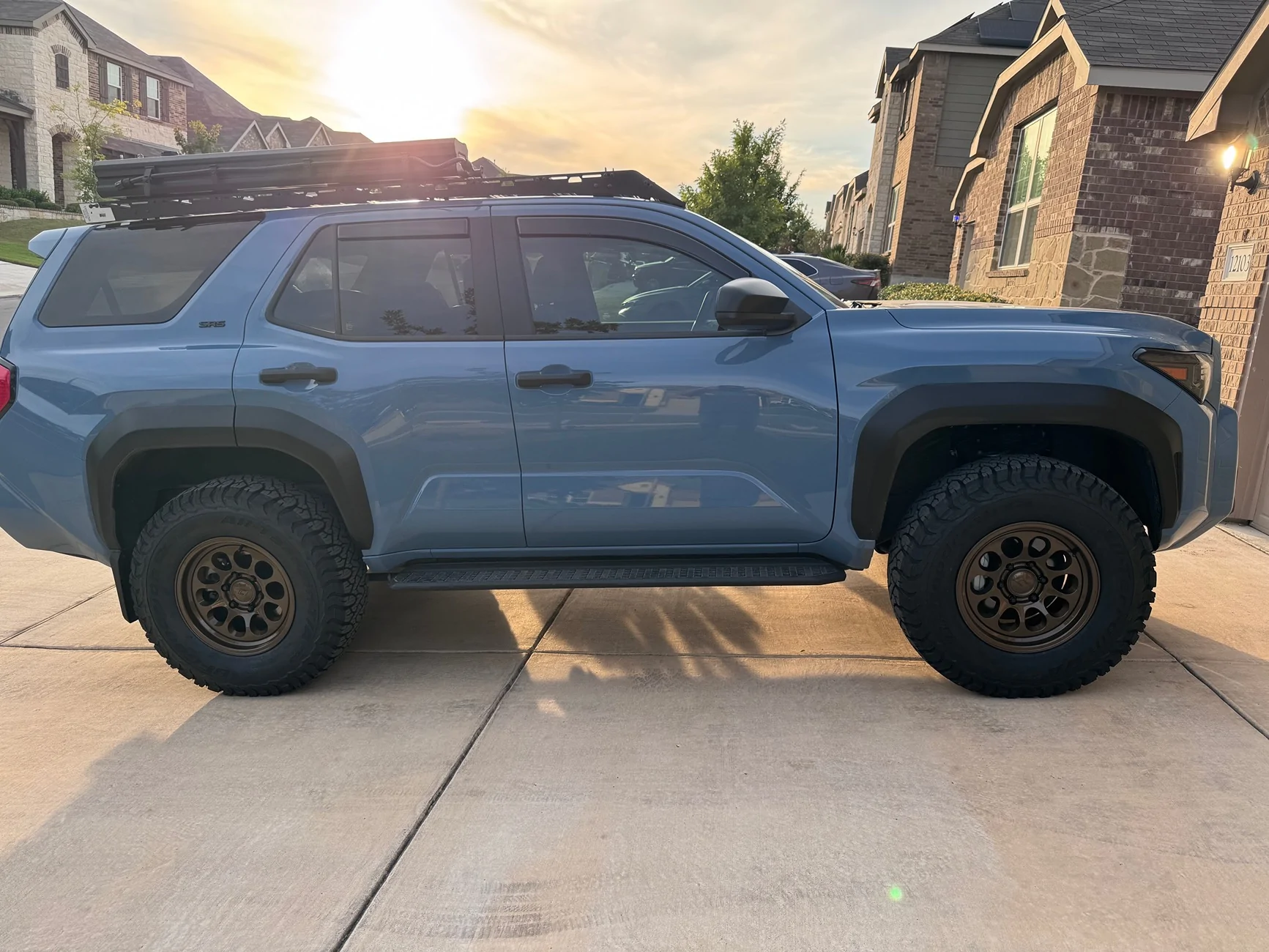

2025 4runner

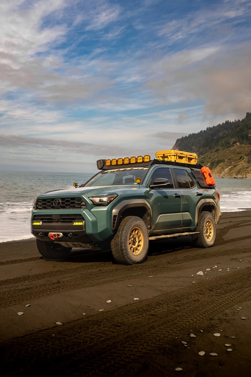

Westcott Designs preload collar lift kit (2.5" front / 0.75" rear)
SCS Stealth Custom Series Blaze10 Bronze Wheels +20 mm offset
BFG KO3 285/75/17 tires
2025 2026 4runner 6th gen Aftermarket Wheels, Bigger Tires, Lift Kits (Compilation) for 2025+ 4Runner 6th Gen -- Add Yours! BFG KO3 285:75:17 SCS Bronze Wheels +20 offset Westcott Designs preload collar lift 2.5 front

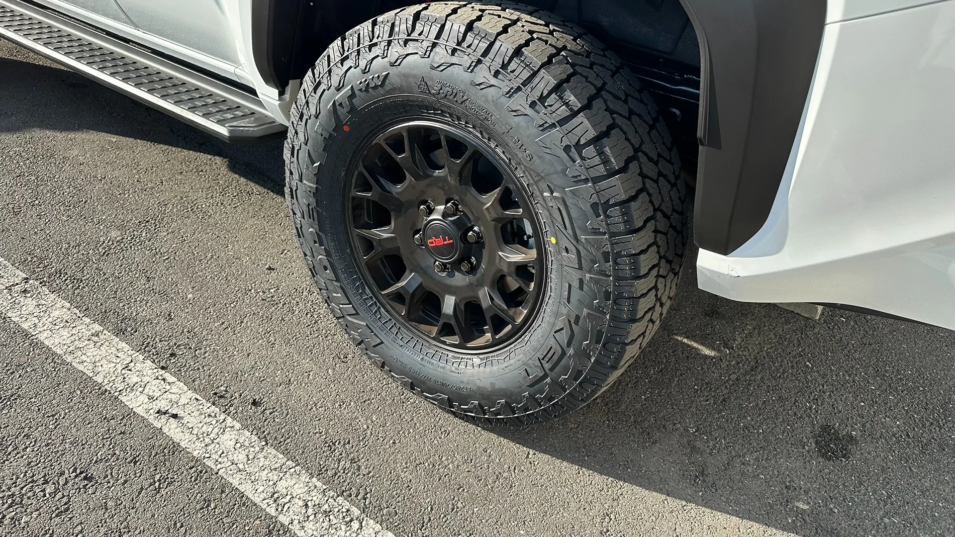

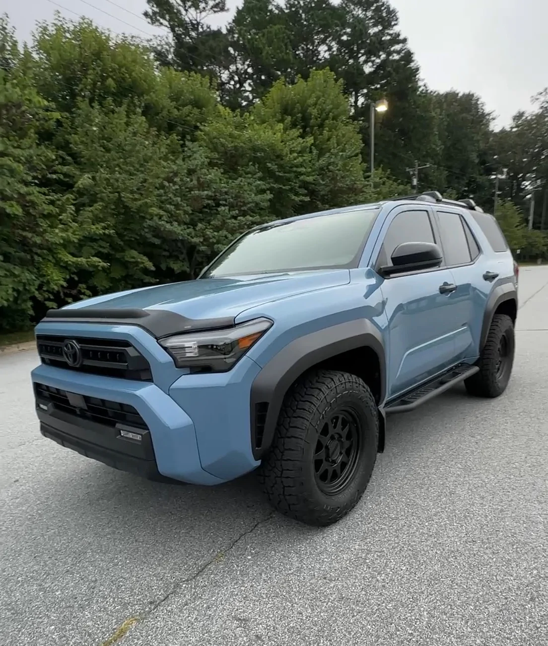

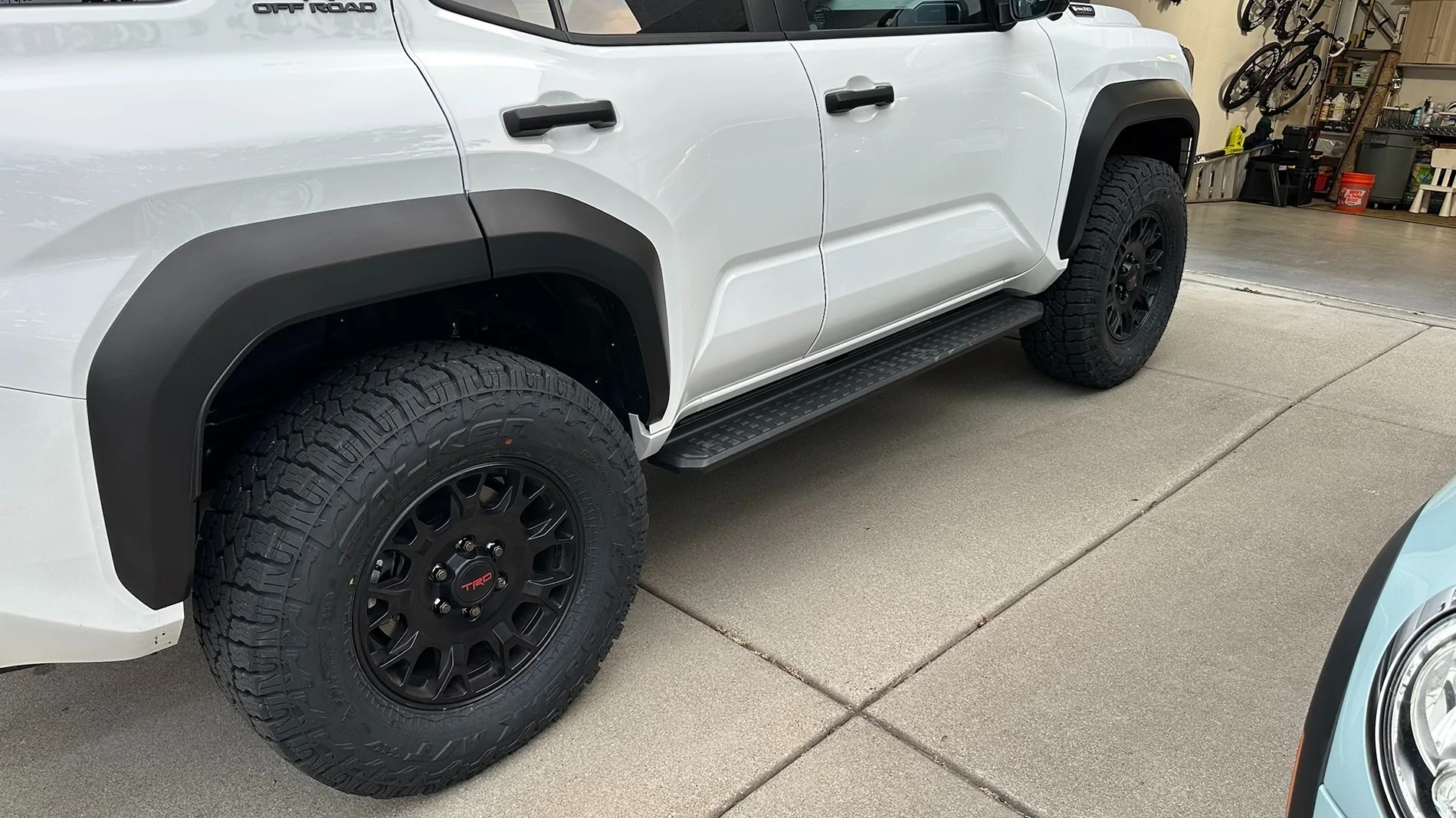

These are 17x8 +25 offset Method MR16 wheels with 275/70/17 Falken Wildpeak AT4 tires.
No rub before and after Westcott 2.5" lift.

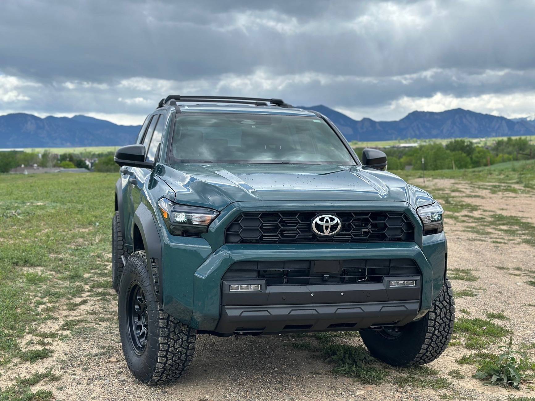

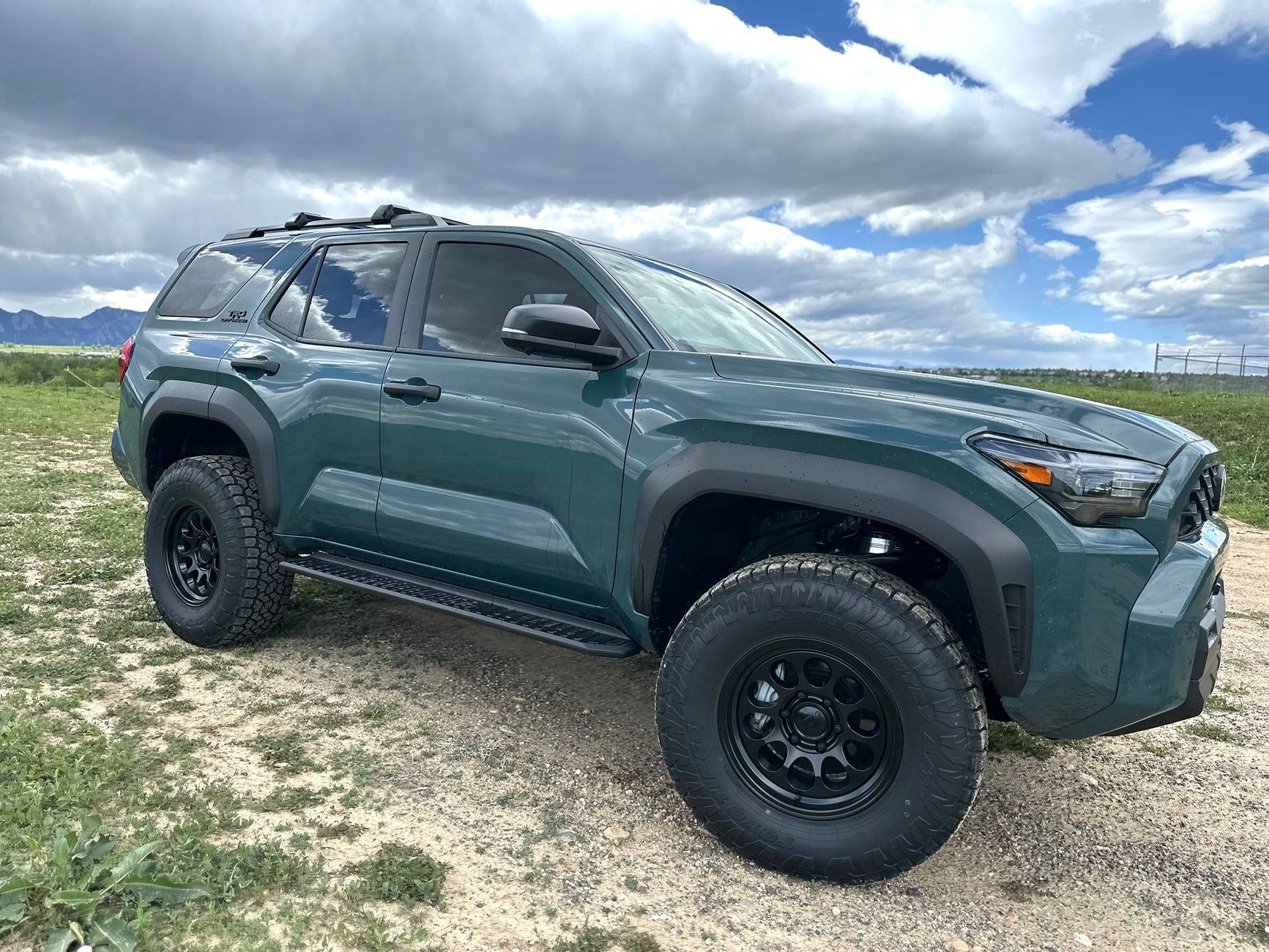

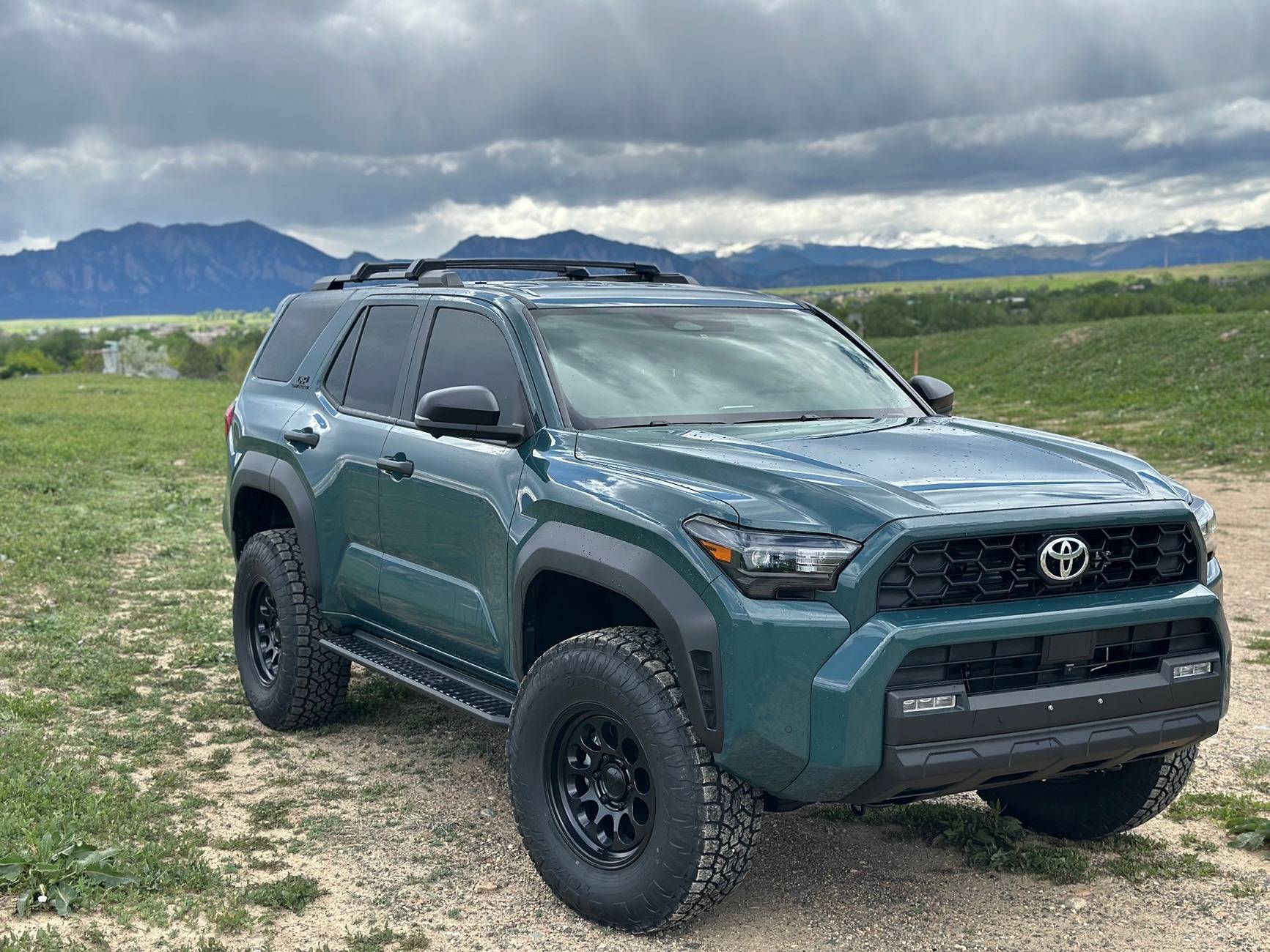

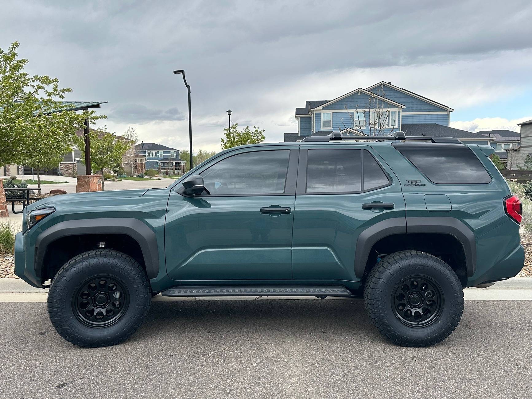

New 2025 Off Road Premium (Everest) - After Market Build.
2.5" ReadyLift
285/75/R17 Toyo Open Country - C Class
SCS Blaze 10 Wheels +20 offset
Tinted front windows
Ready to rock in Boulder, CO and Colorado excursions this summer!
Thanks to Corwin Toyota After Markets Team; Ryan. Highly rec.
Did you have to do any trimming for this set up?

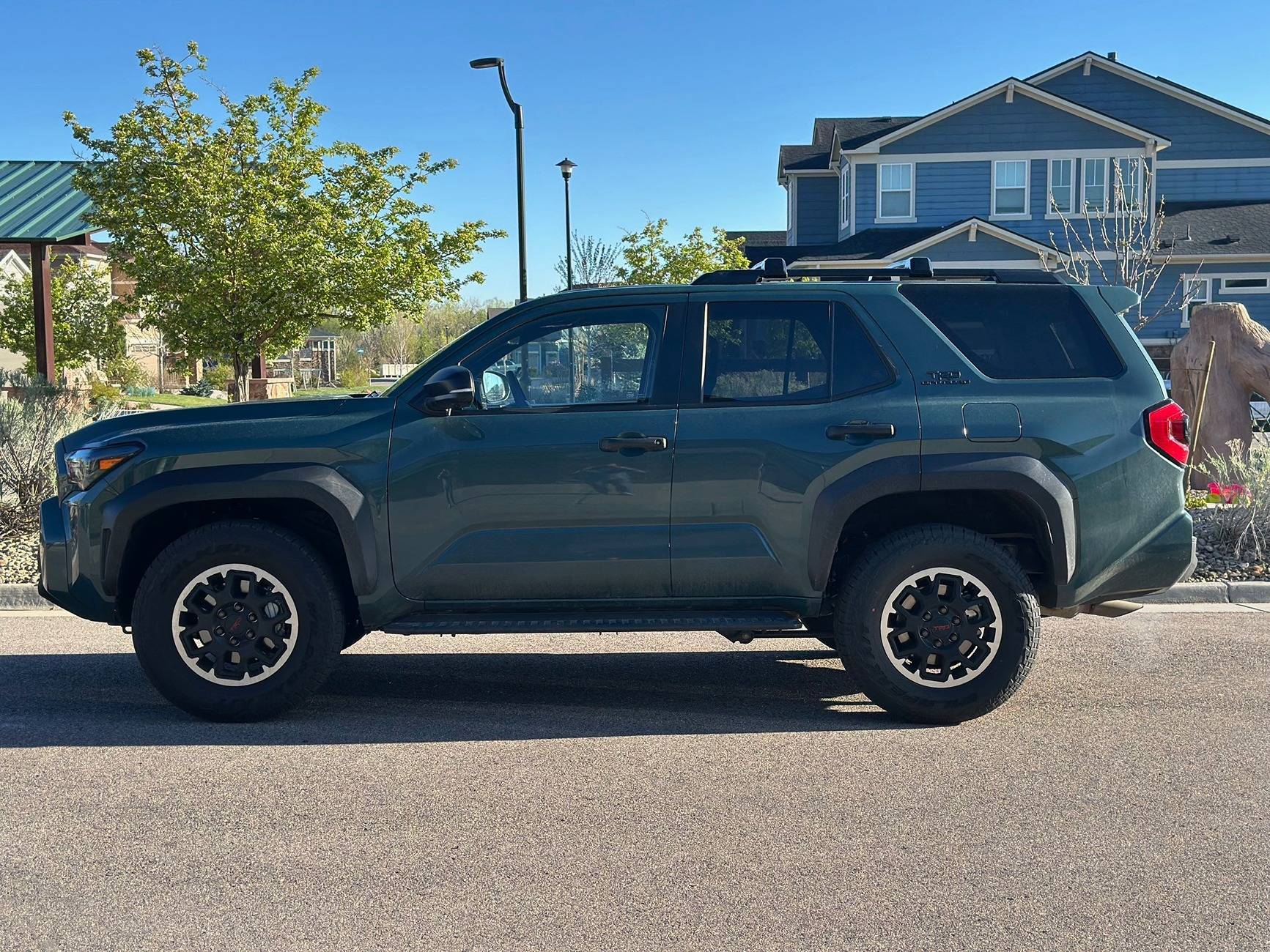

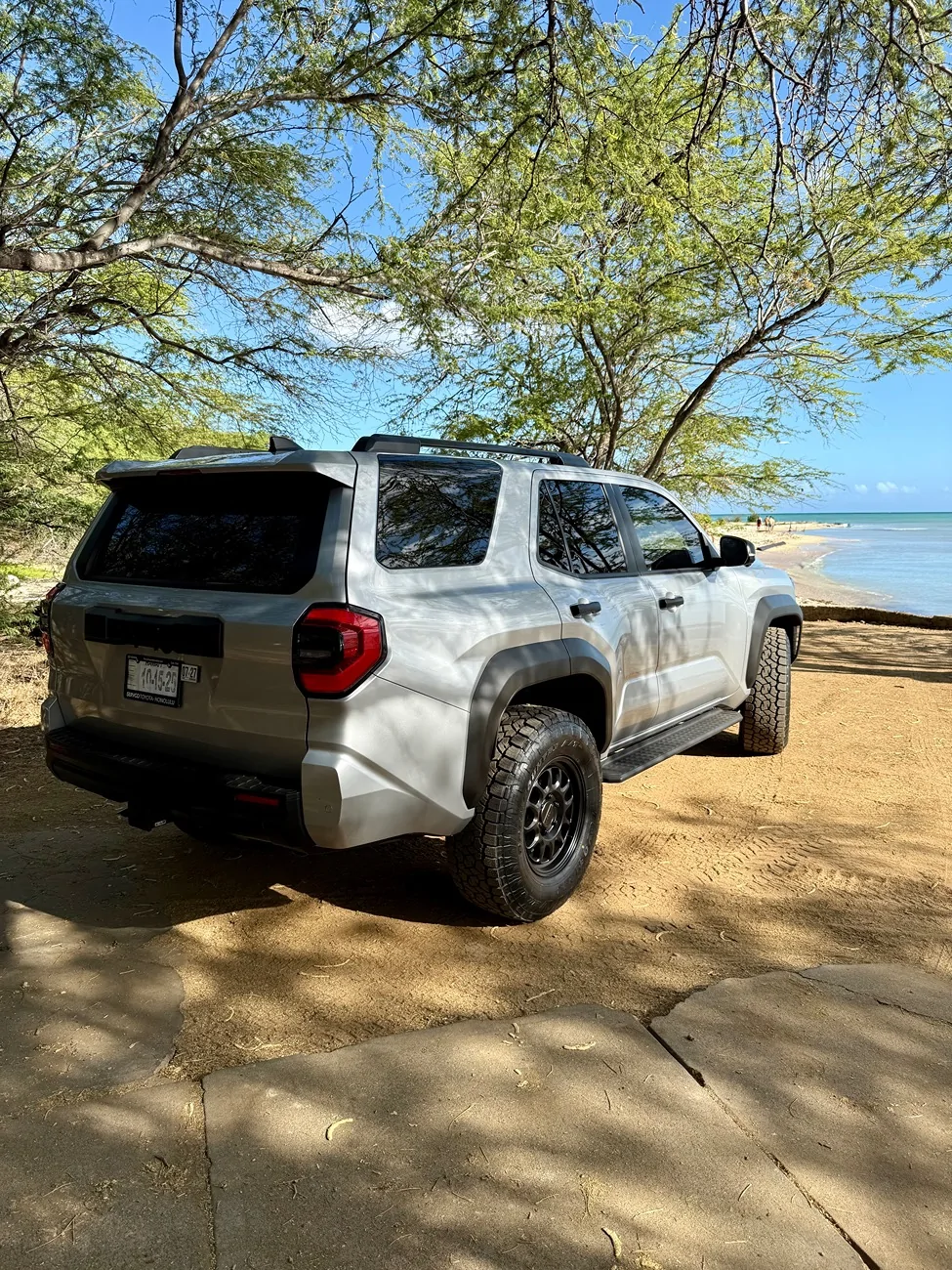

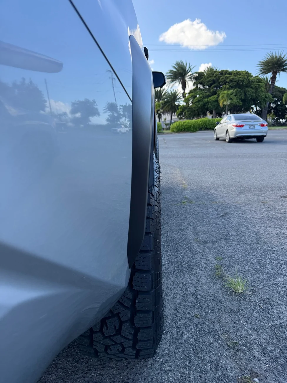

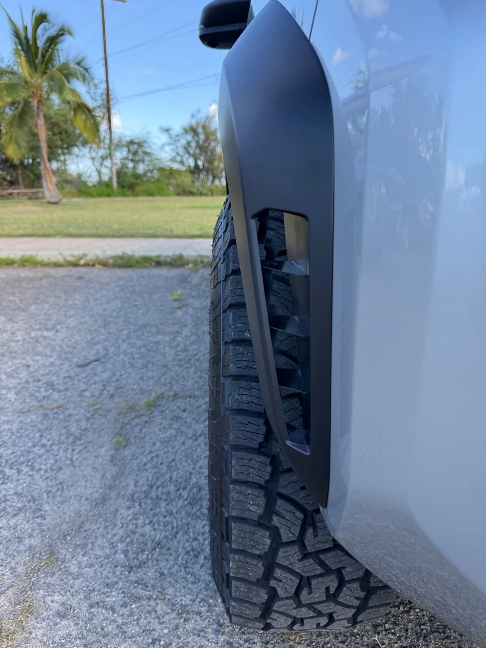

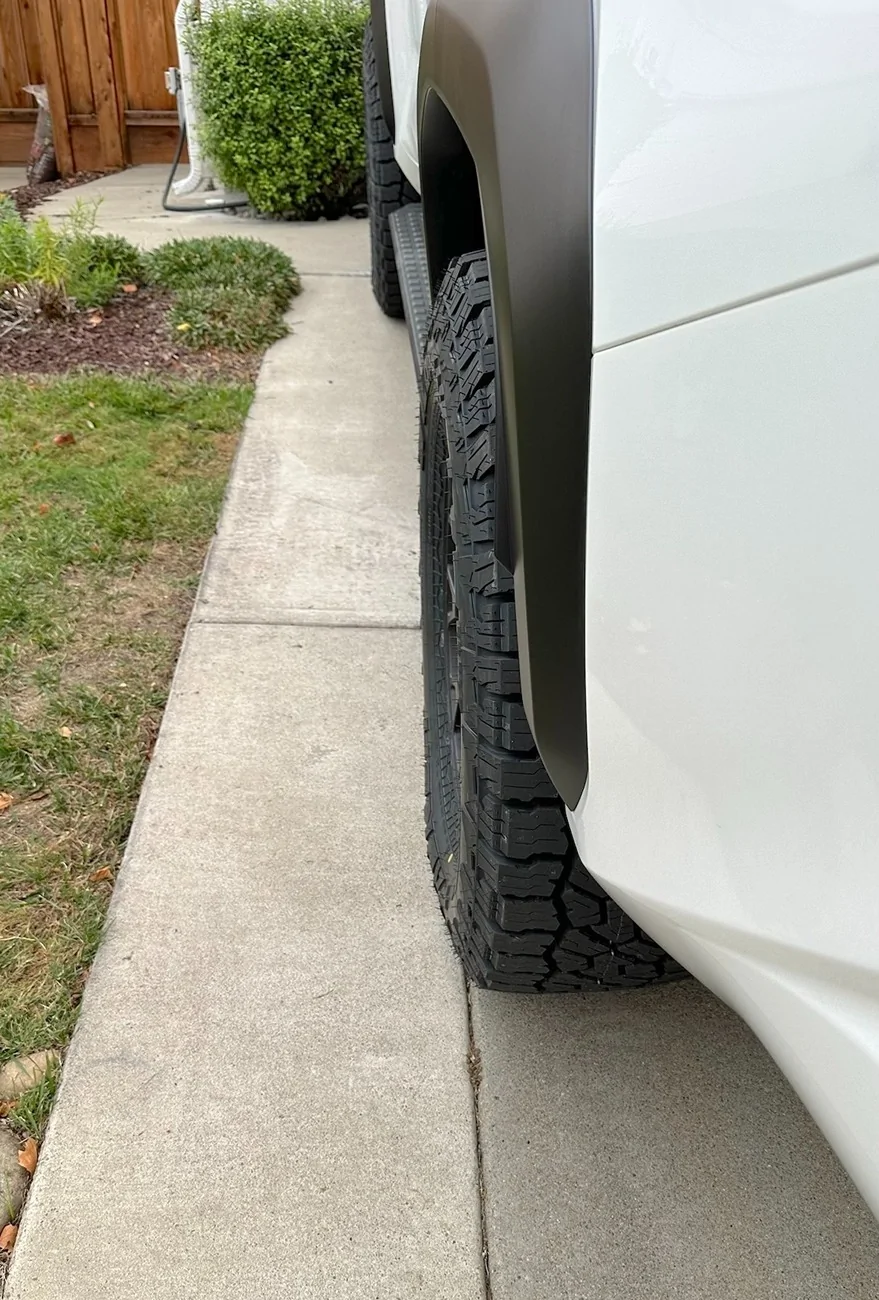

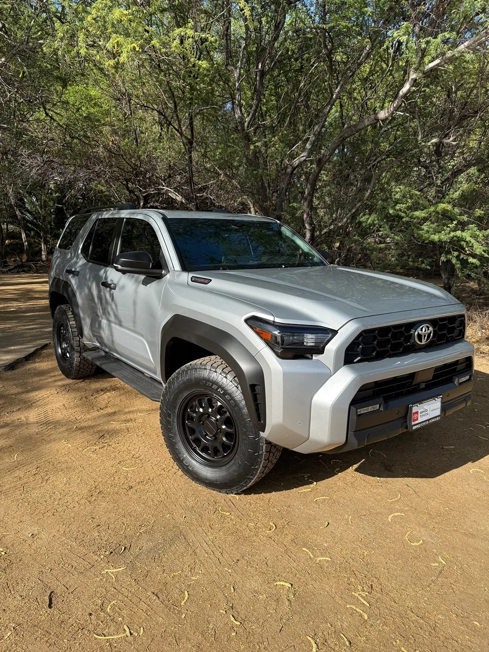

I joined the +35 club. Fretted over +25 or +35. For a while. I didn’t want the thread to stick out because I’m driving dirt road daily. The thread of front and rear tire line up with the inside lip of the plastic fender. The budge sticks out past the fender. I tried to show it on the last pictures because that what I was trying to see when scouring the internet. I’m happy with the outcome.
Here’s the details.
TRD ORP stock height
Raceline Rogue 17x8.5 +35 offset
Toyo AT3 sl 285/70/17

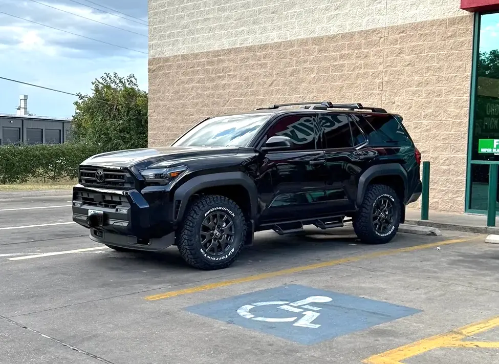

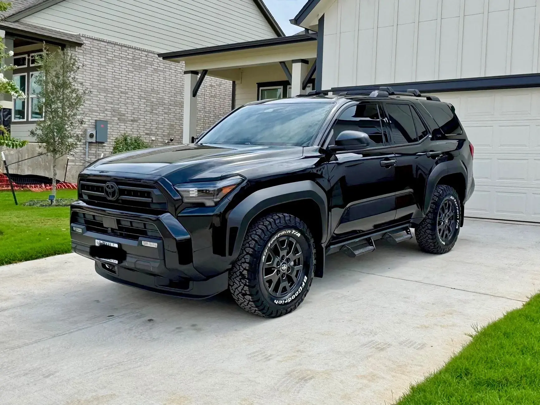

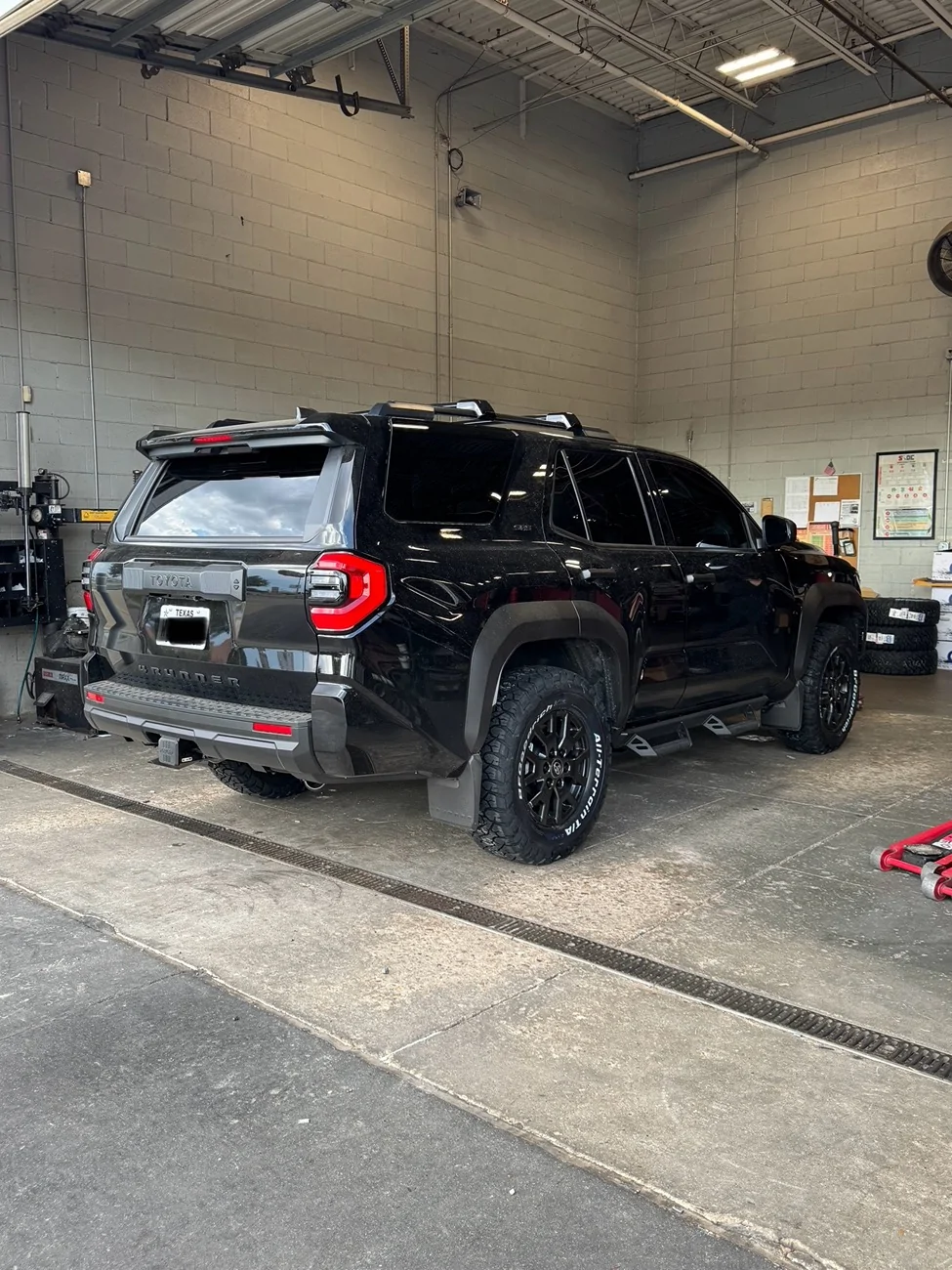

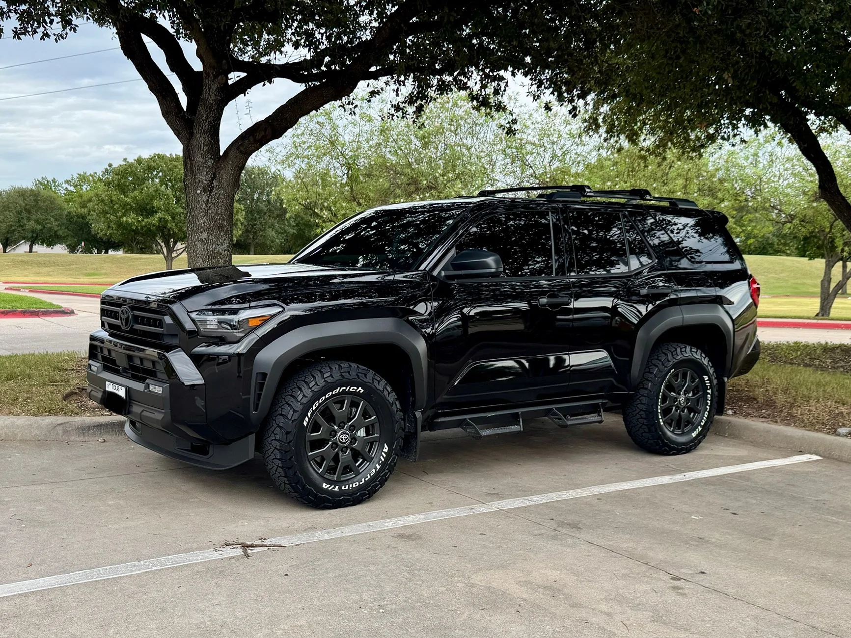

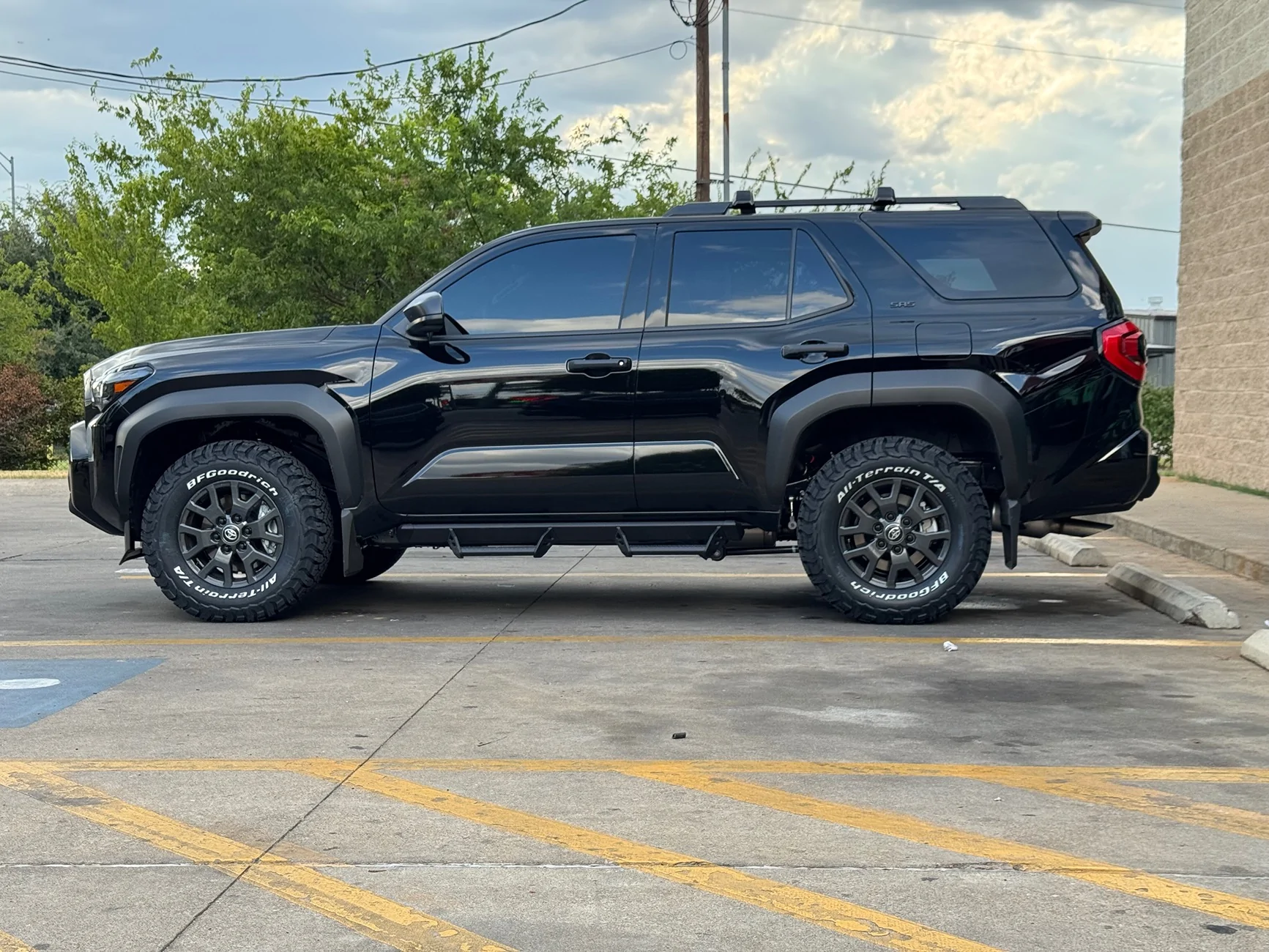

BF Goodrich KO3 265/70/17 on the stock SR5 wheels. Swapped the lug nuts to black.
Ended up with C-Rating, I tried the E-Rated for a week and it was too sluggish off the line. After one day of heavy rain, traction control went off causing the rears to swerve, which prompted me to swap.
See my original thread:
https://www.4runner6g.com/forum/threads/😎-black-sr5-oem-build-on-bfg-ko3-265-70-17-tires-white-lettering-on-stock-wheels.6335/
2025 2026 4runner 6th gen Aftermarket Wheels, Bigger Tires, Lift Kits (Compilation) for 2025+ 4Runner 6th Gen -- Add Yours! IMG_8489
2025 2026 4runner 6th gen Aftermarket Wheels, Bigger Tires, Lift Kits (Compilation) for 2025+ 4Runner 6th Gen -- Add Yours! IMG_8486
2025 2026 4runner 6th gen Aftermarket Wheels, Bigger Tires, Lift Kits (Compilation) for 2025+ 4Runner 6th Gen -- Add Yours! IMG_8485

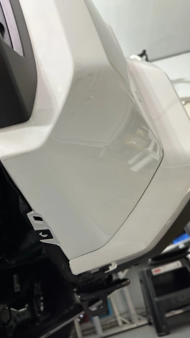

Right now, I do have the air dam still on — but plan on deleting in future.
2025 2026 4runner 6th gen Aftermarket Wheels, Bigger Tires, Lift Kits (Compilation) for 2025+ 4Runner 6th Gen -- Add Yours! IMG_8508
Wasn’t sure how I was going to like the white lettering on all black setup, but i’m digging the contrast at the moment.

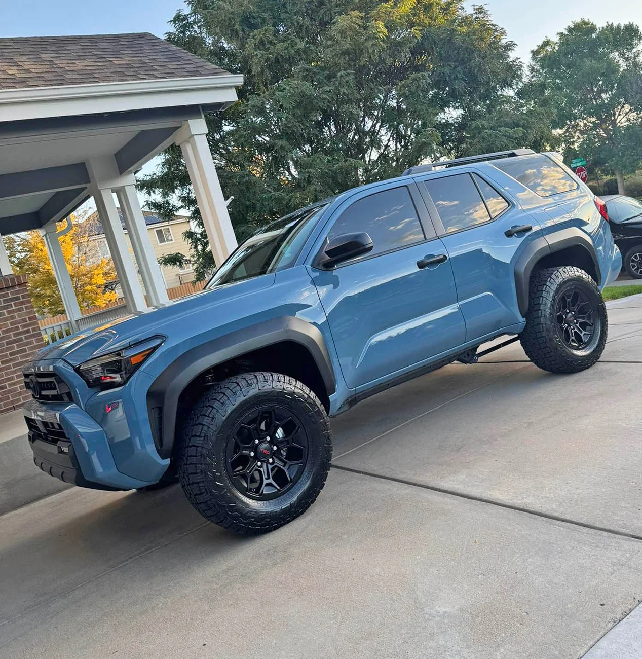

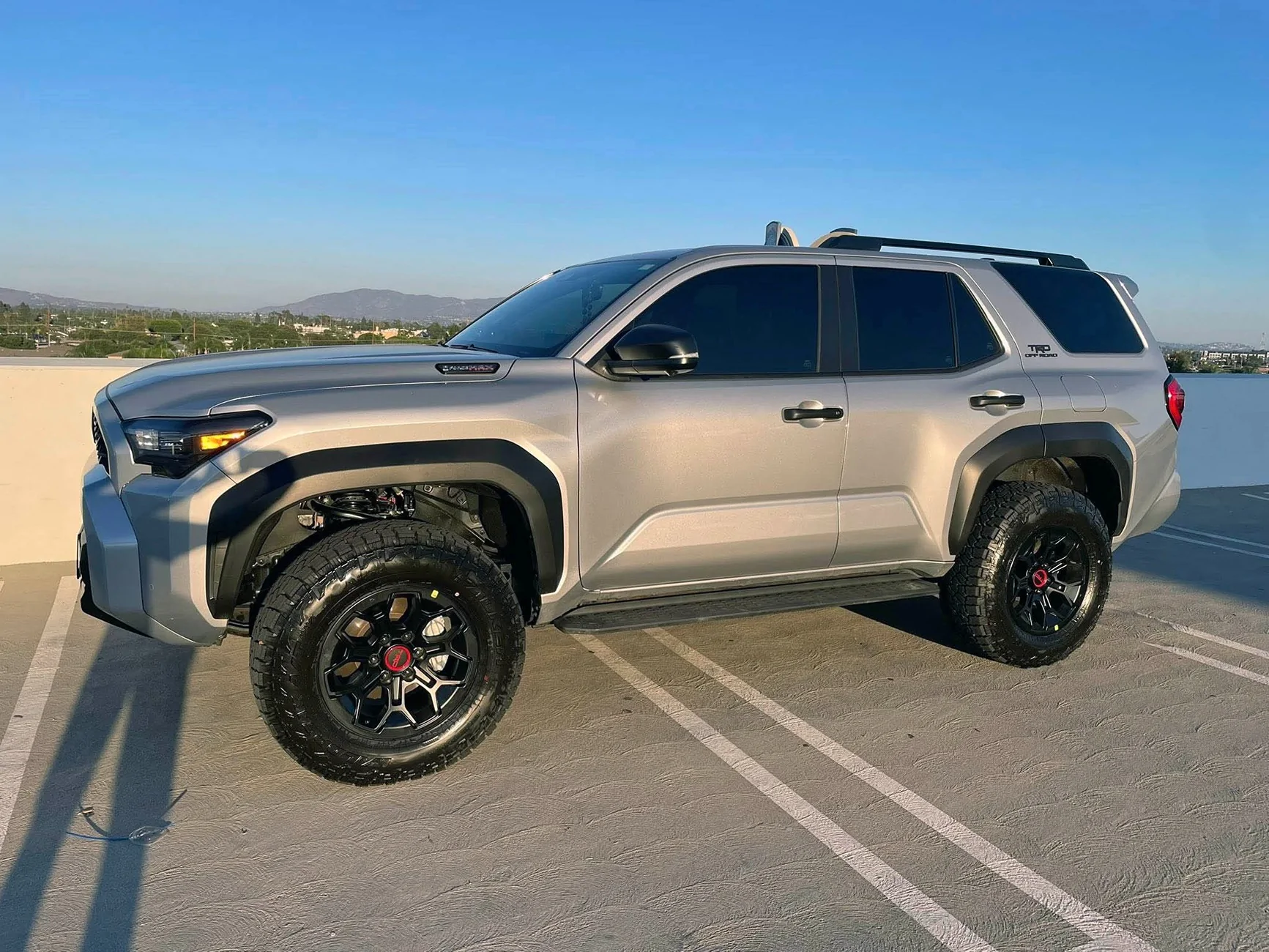

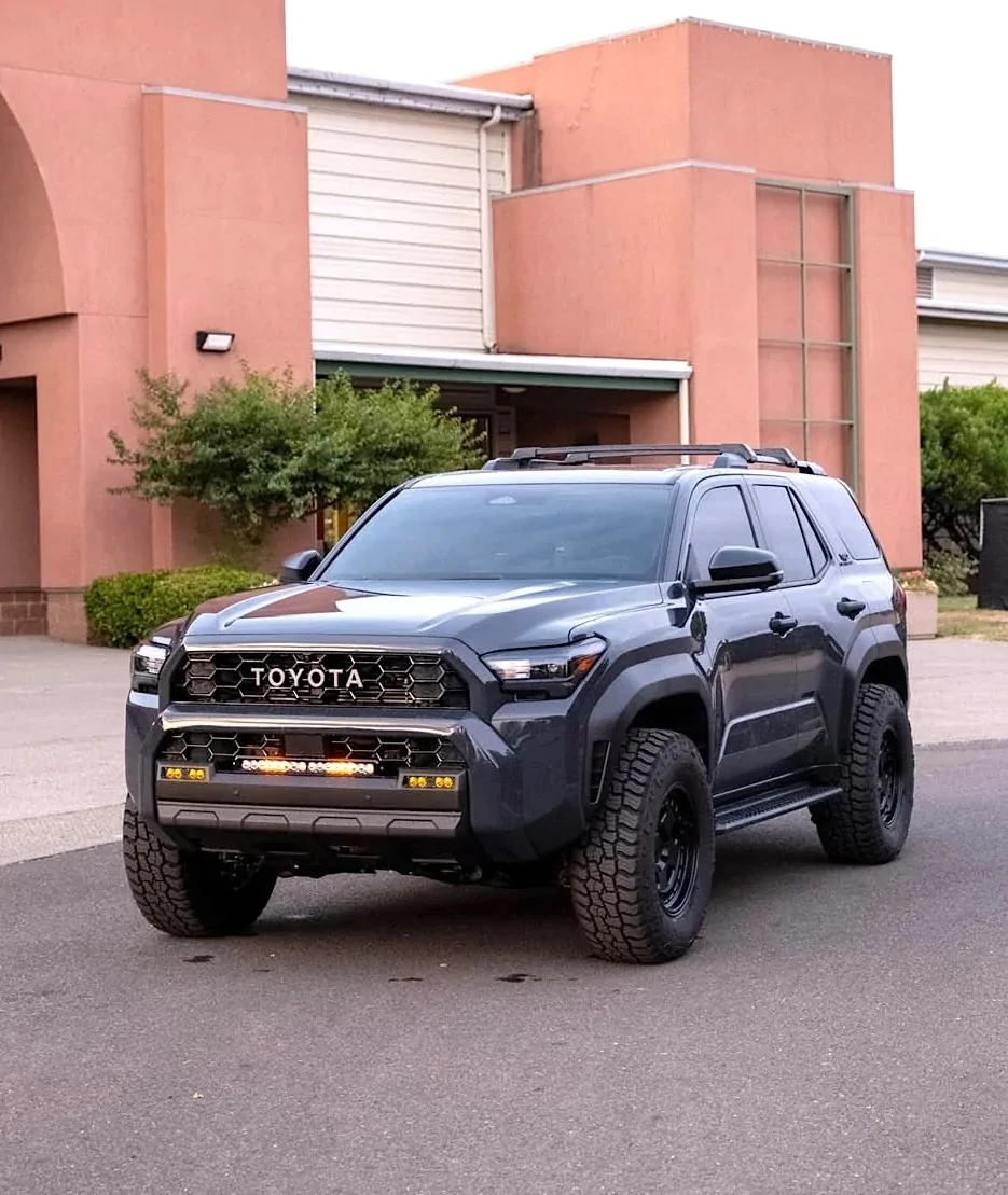

Not mine but really like how this looks: SR5 on TRD Pro Wheels with 285/70/18 Falken Wildpeak and 1" inch ReadyLift spacer lift in the front. No rubbing.

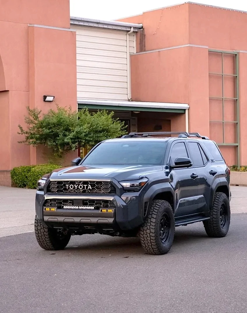

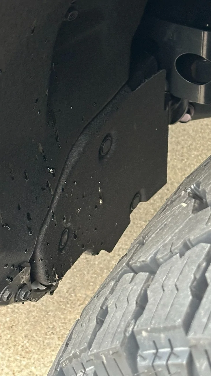

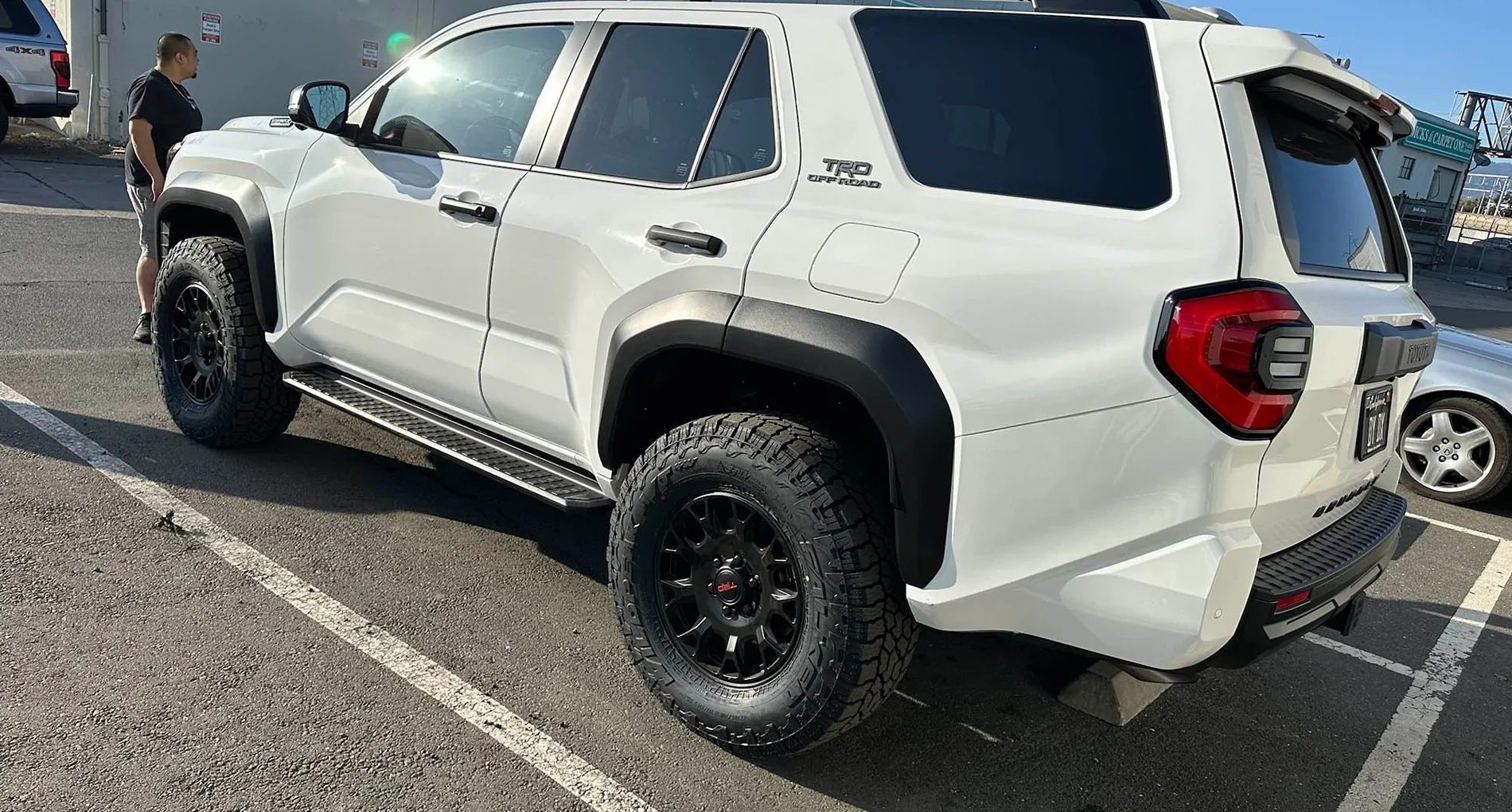

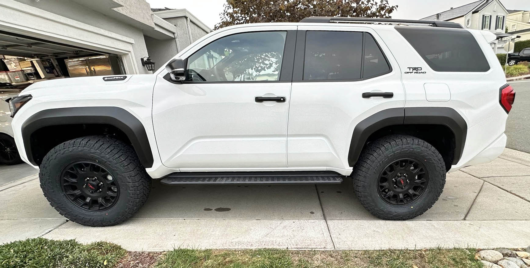

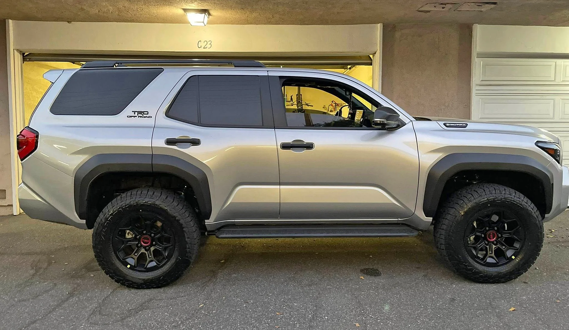

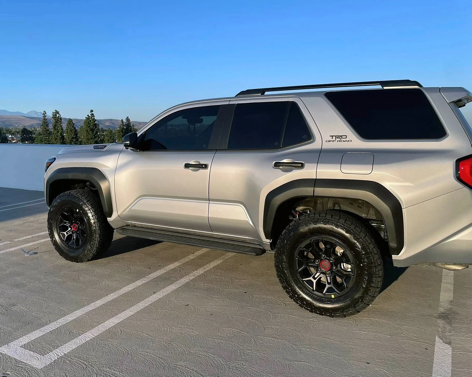

My TRD ORP
  • Wheels: TRD Upgraded wheels - 18x8 +45 offset
  • Tires: 285/70R18 (inflated measures to 34"x11.5") Falken Wildpeak A/T4W C rated (34's)
  • Lift: Westcott 2025 Toyota 4Runner (6th Gen) Preload Collar Lift Kit (2.50” front / .75” rear)
  • Only slight trimming of front felt liner, no removal of crash plate.

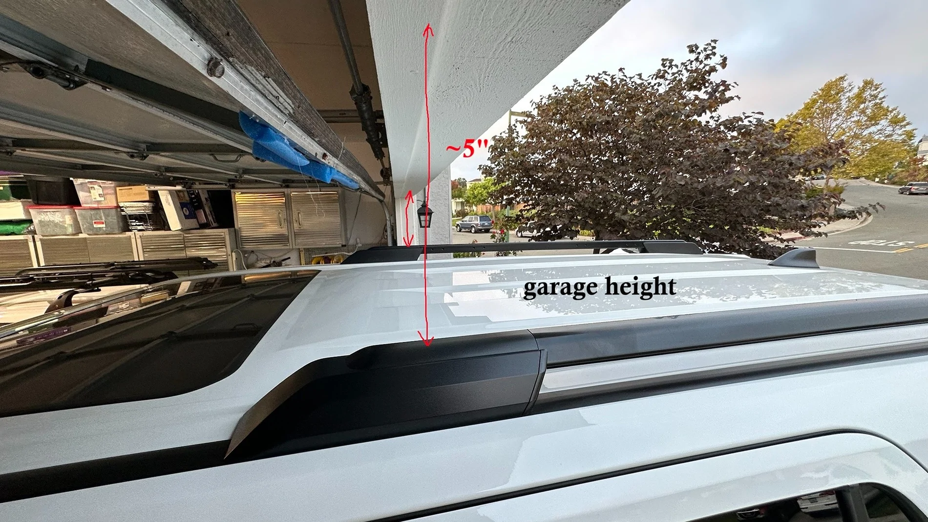

Impressions: Ride feel is about 80% of comfort of stock wheels, definitely noticeable reduction in acceleration, can feel the weight of tires in the "get-up-and-go" from stand still and from 50mph to pass other vehicles, highway "speed maintaining" is about 90% of stock, stopping power about the same. Ample room for roof rack to be able to put car in a standard height garage.

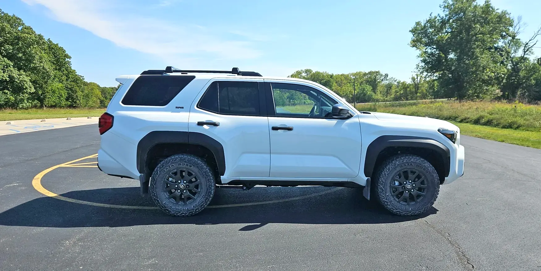

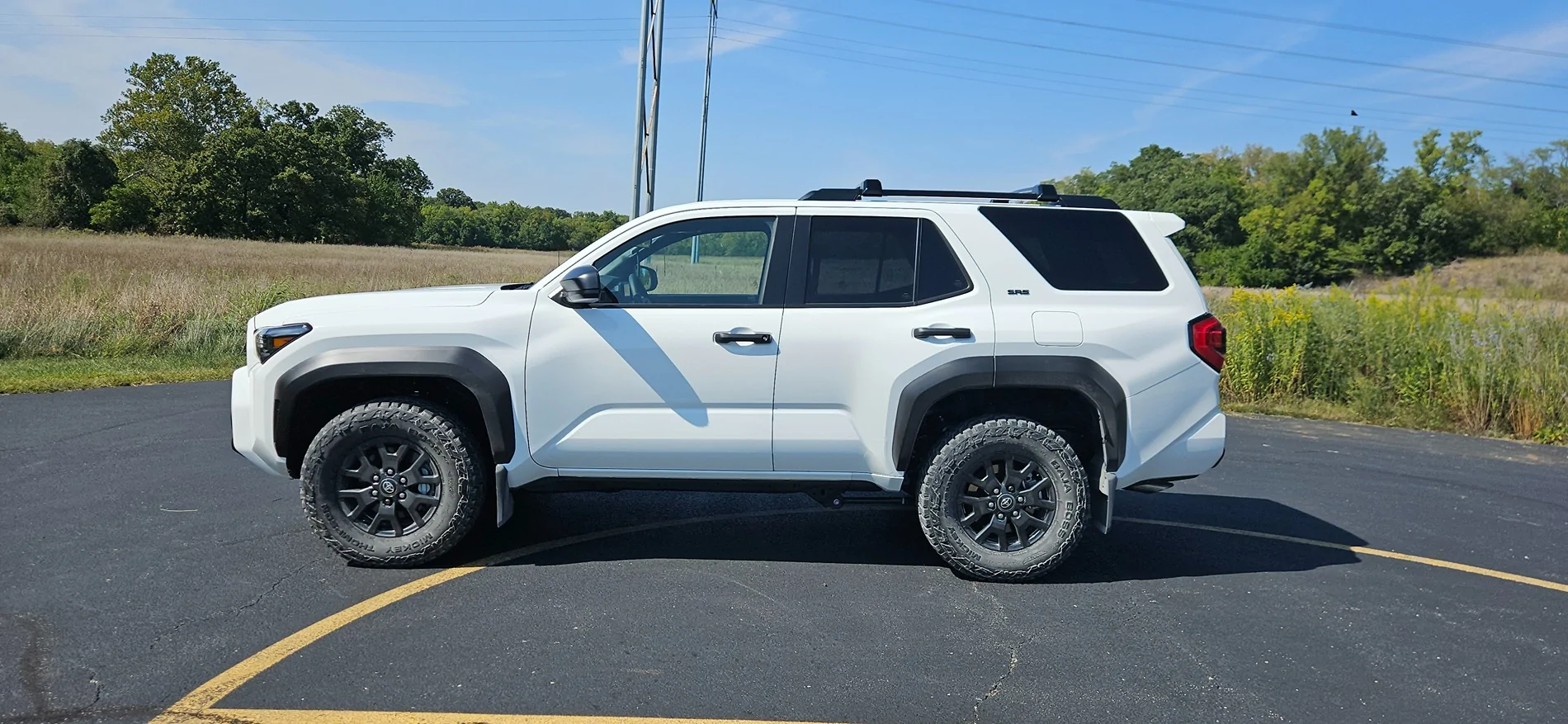

2025 Toyota 4Runner SR5

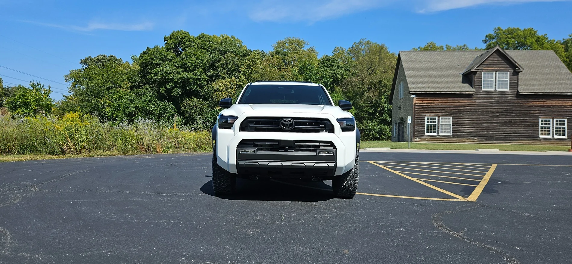

MT Baja Boss 265/70/17 Tires Fitted
Just need to tint the windows and wire up the dashcam...
