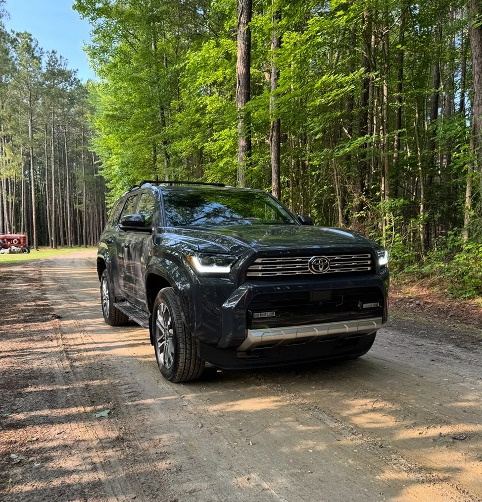

33's installed.
Added TRD Pro cast aluminum running boards and found these 33" tires - Falken Wildpeak A/T4W tires (285/70R18) on Facebook that were taken off a 2025 Tacoma.
No rubbing on stock suspension and I’ve driven it about 300 miles except for today I was backing out of parking lot and it rubbed one little bit on the front right mud flap. C range tires so ride is still normal for me.
Also installed Lasfit liners and LED front blinkers, tinted windows and windshield and installed the Sonic amplifier so far.
Have a Readylift level kit being put on Friday so will post another pic then.

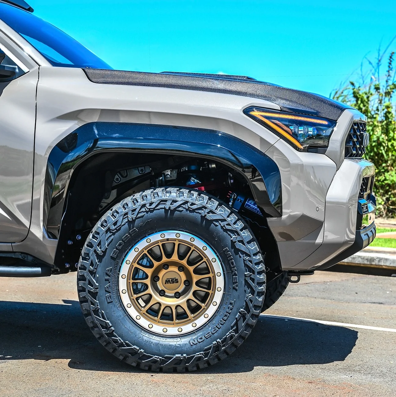

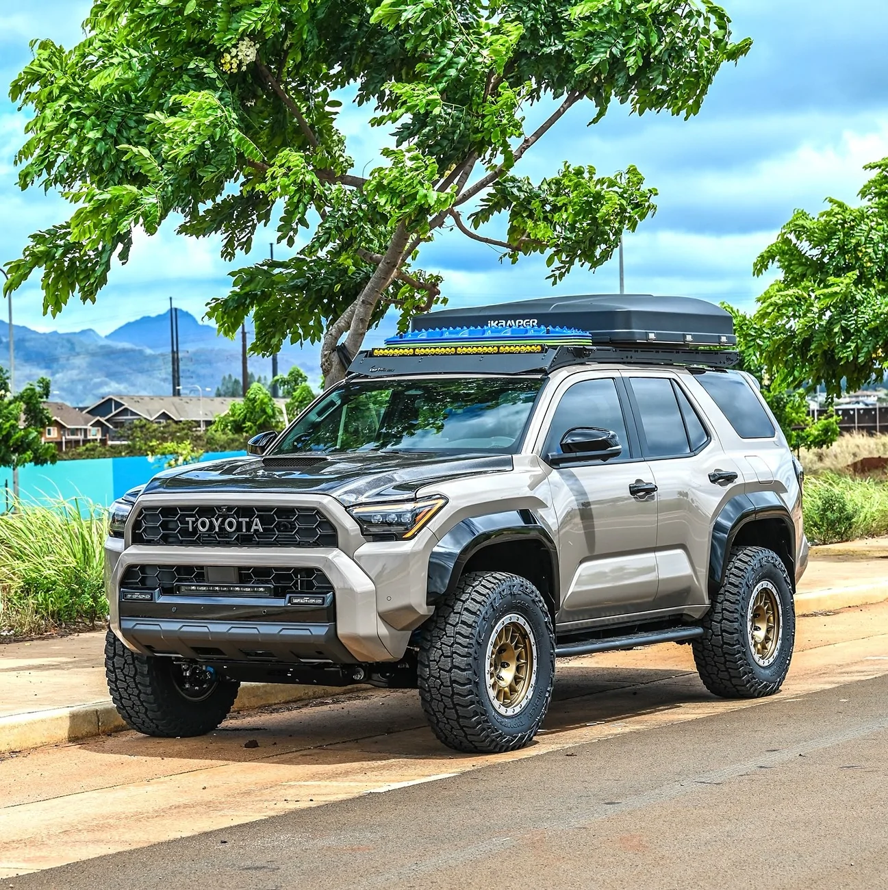

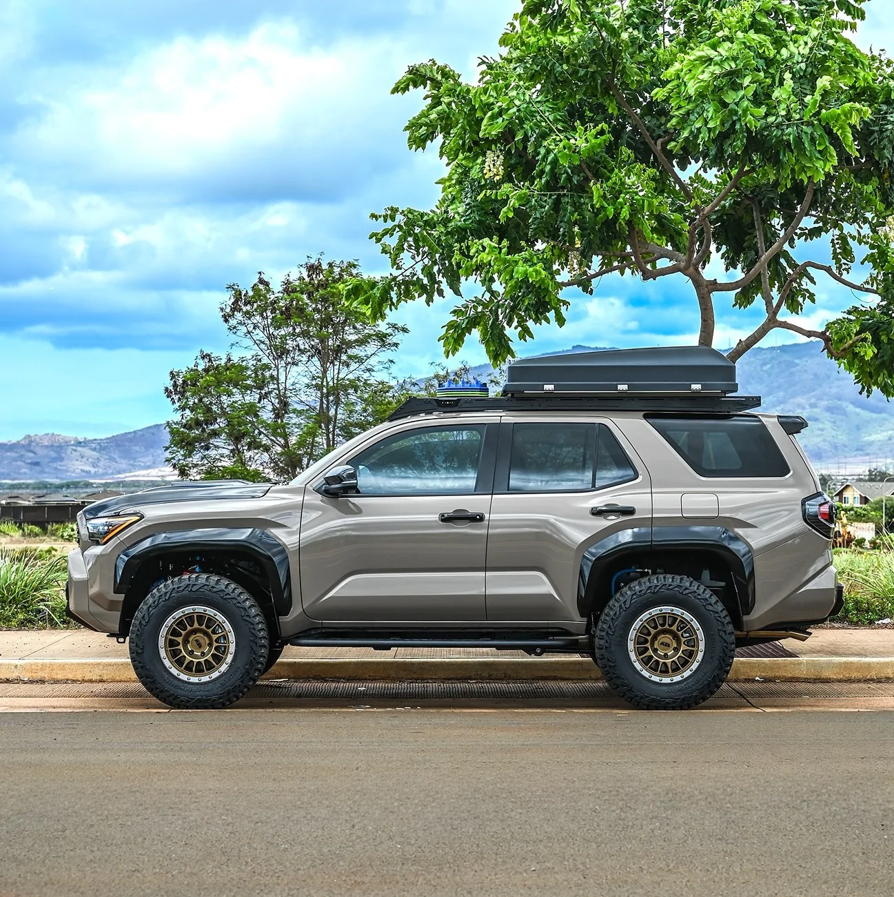

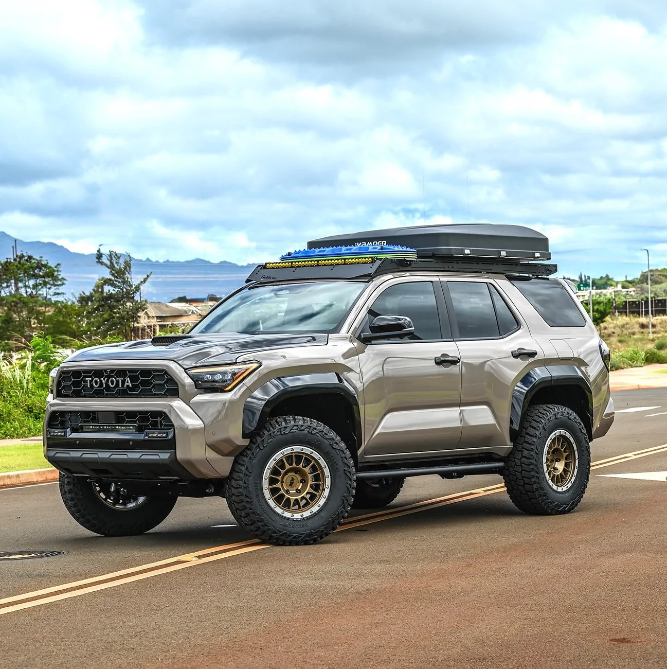

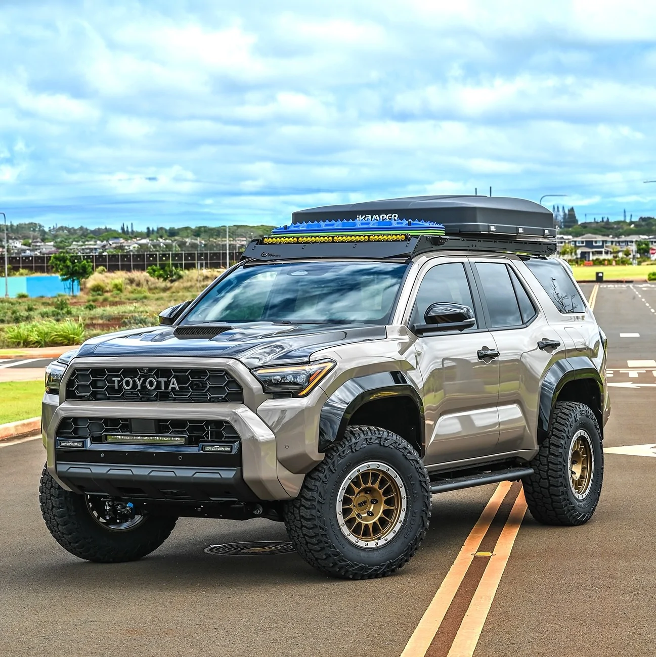

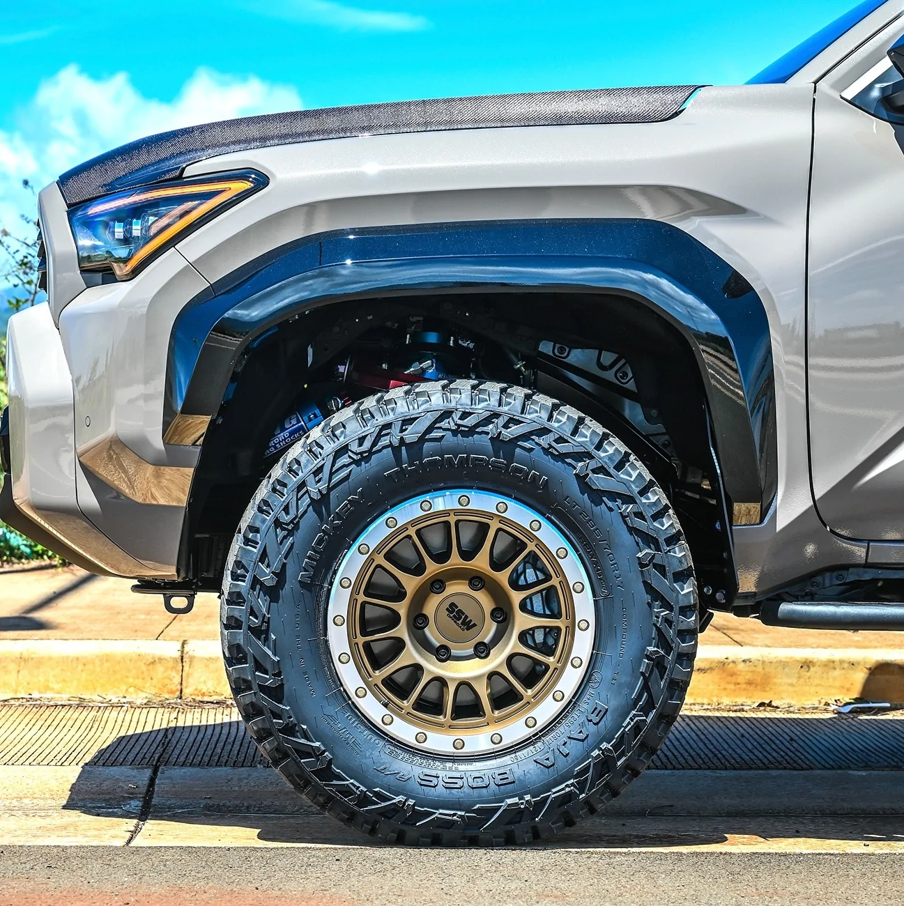

Incoming 2025 4Runner TRD ORP
2025 4Runner TRD Pro Build on
SSW Dakar Evo wheels 17x9 0 Offset Wheels
Mickey Thompson Baja Boss AT 295/70/17 Tires
Other mods:
Kings 2.5 Collovers with 3" inchLift
Eibach 1.5 Rear Springs
Alpharex Nova Headlights
Seibon Carbon Hood TS
ARK Splash Guards
Prinsu Roof Rack
CBI Rock Sliders and Skid Plate
Screen Protech Display Protector

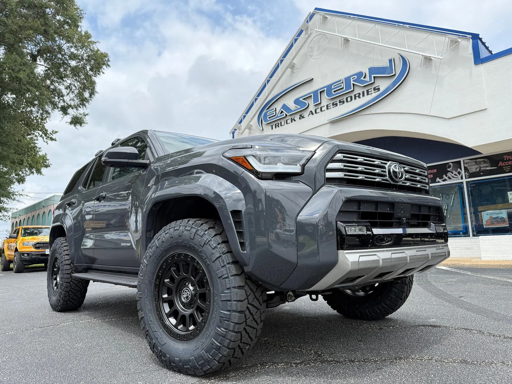

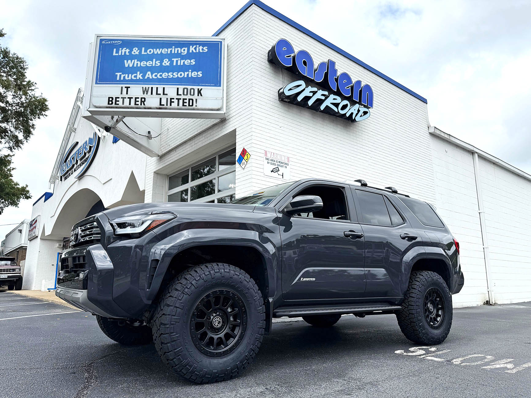

Sooo excited to have my car back! I’ll include one before picture to show the difference.
2.5" inch Westcott lift, LT 285/75/17 Nitto Ridge Grappler tires, +25 offset Icon black wheels, and removed that air dam 🤑

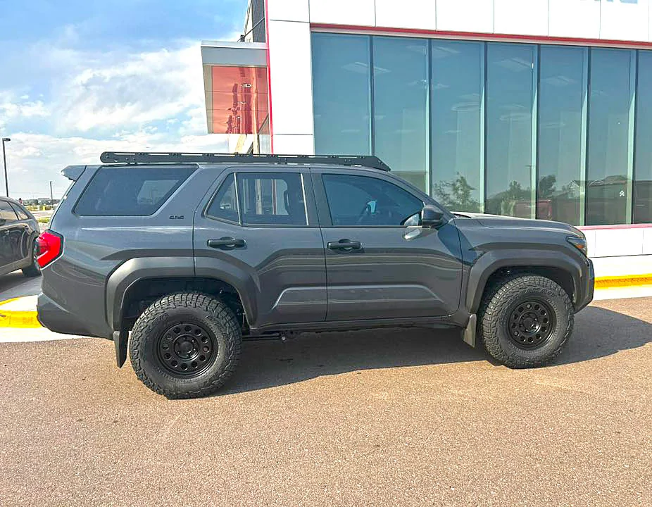

2025 Toyota 4Runner SR5
Wescott Lift 2.5 in front and 0.75 rear
285/75/17 Toyo Open Country AT tires
17x8.5 Method 703 wheels +0 offset

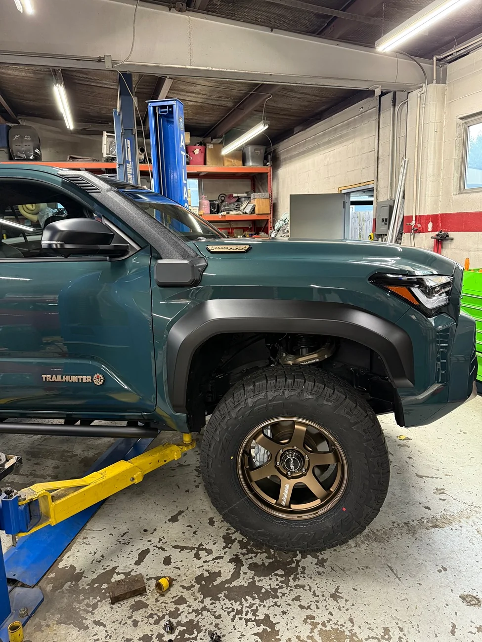

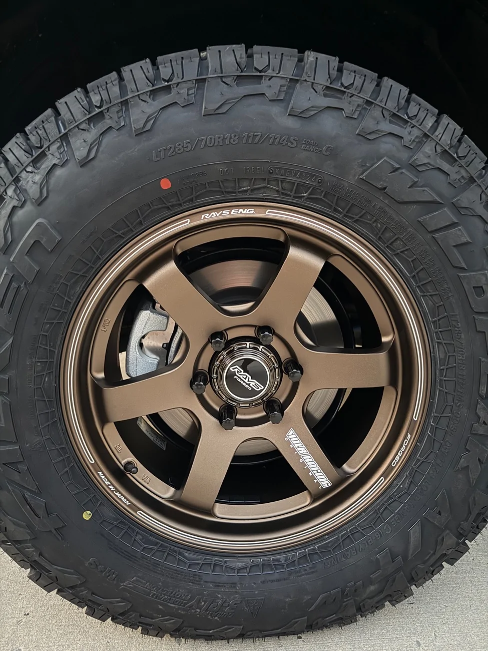

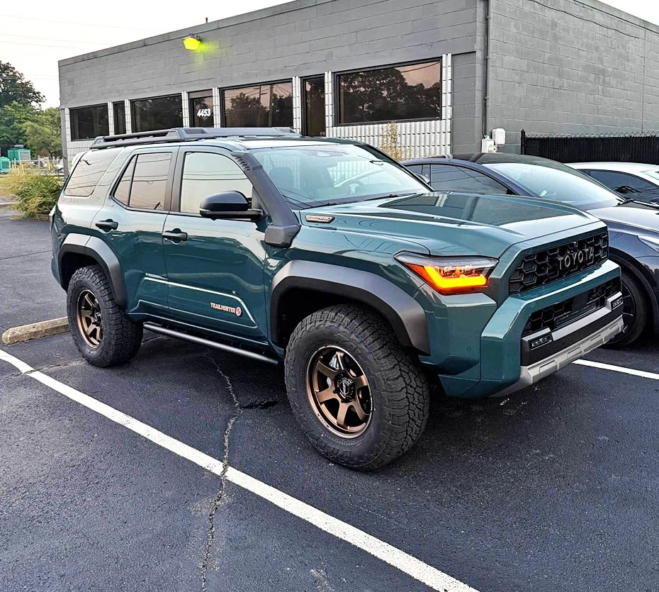

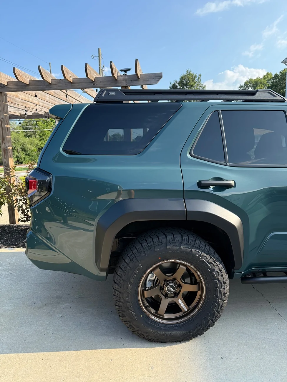

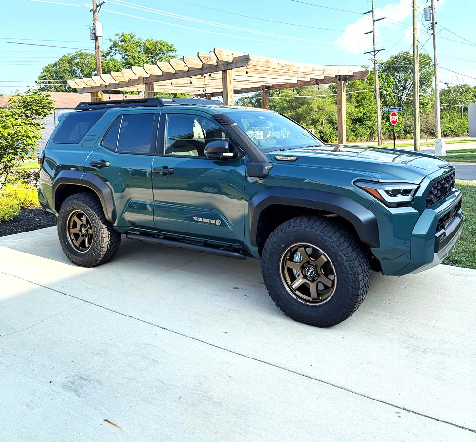

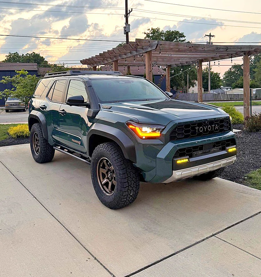

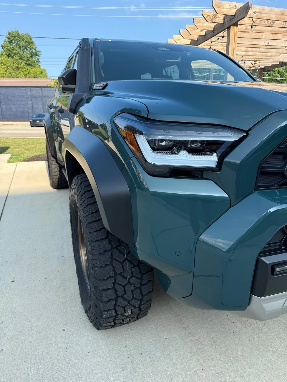

Got the TE’s & Wildpeaks mounted on my TrailHunter last night. No rubbing, removed mudflaps & that is all. Waiting on the Westcott lift, but very happy with the fitment!
Specs are below:
Bronze Volk Racing TE37sb 18x8.5 +22
LT285/70R-18

Hi All,
Have a TRD OR(P) and I just recently mounted a take off set of the bronze trailhunter wheels.
The tire I selected is the Bridgestone Dueler Ascent in 275/70R18 E Load.
Rides very well in the 20mi I've had them, feels very similar to the stock Falken 3WA with the black wheels.
The bronze looks great with the heritage blue, but I did notice some very slight rubbing against the inner edge of the OEM mudguards.
Is there a simple solution to fix this, while leaving the mudguards on? I'd like the rock protection as there is plenty of small stones in CO that hate car paint.
I think I've seen 5G and 4G owners use heat guns to mold the plastic back a bit, but not sure if it's the most elegant solution.
Thanks!
