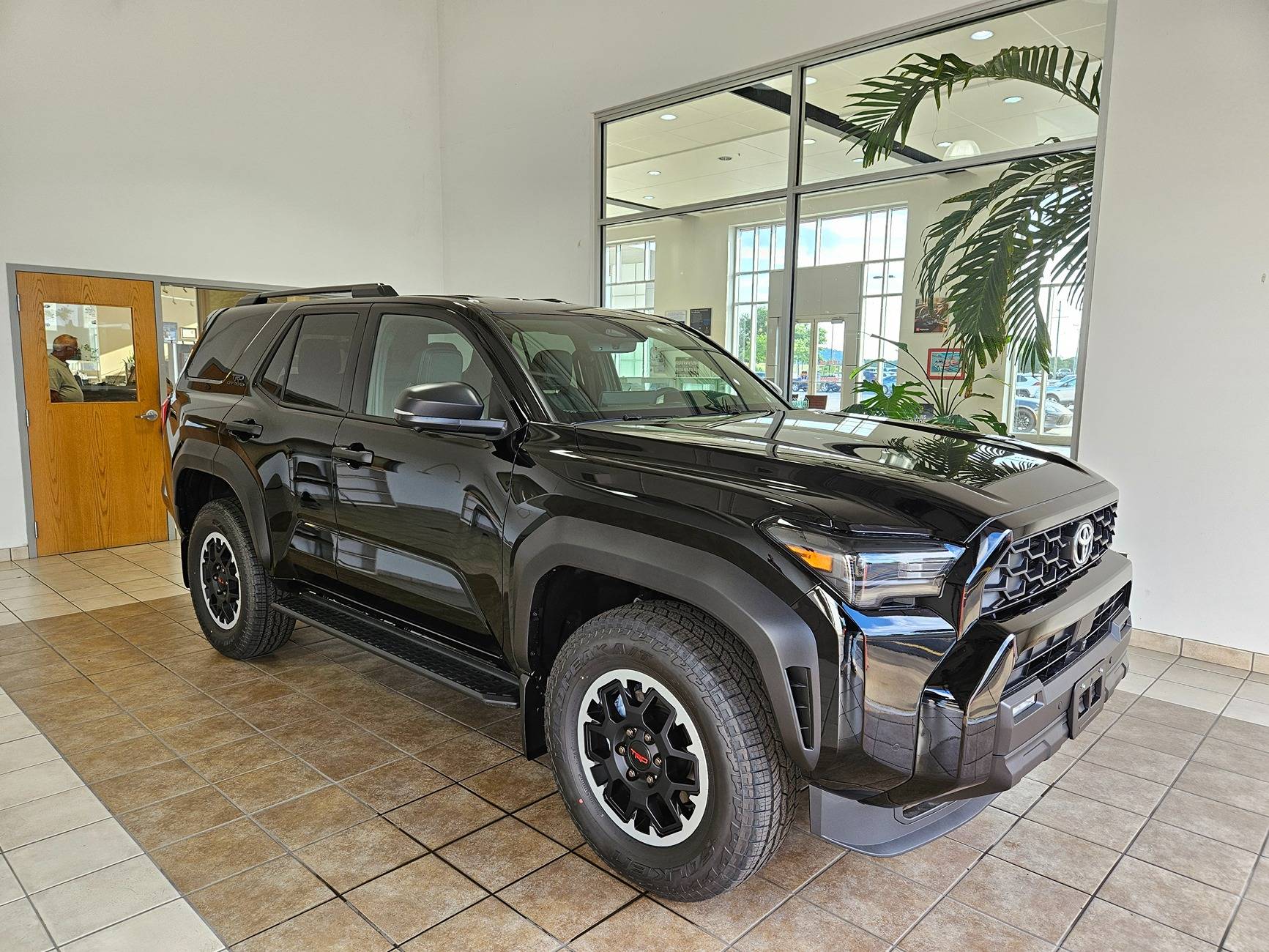

It looks great. Did you have stock 20” wheels? What is the width of those wheels?
J4Runner1
James
Apr 23, 2025
62
Hybrid Off Road Premium
Suspension Mods
Westcott Designs Preload Collar Lift Kit front and back
Wheels - Black Rhino 17" +25 Offset
Tires - Toyo Open Country AT III C load 285/75/17
No rubbing. Suspension a but stiffer than stock. MPG down a few miles so far. All the electronics seem to be working normal - lane assist, cruise, etc.

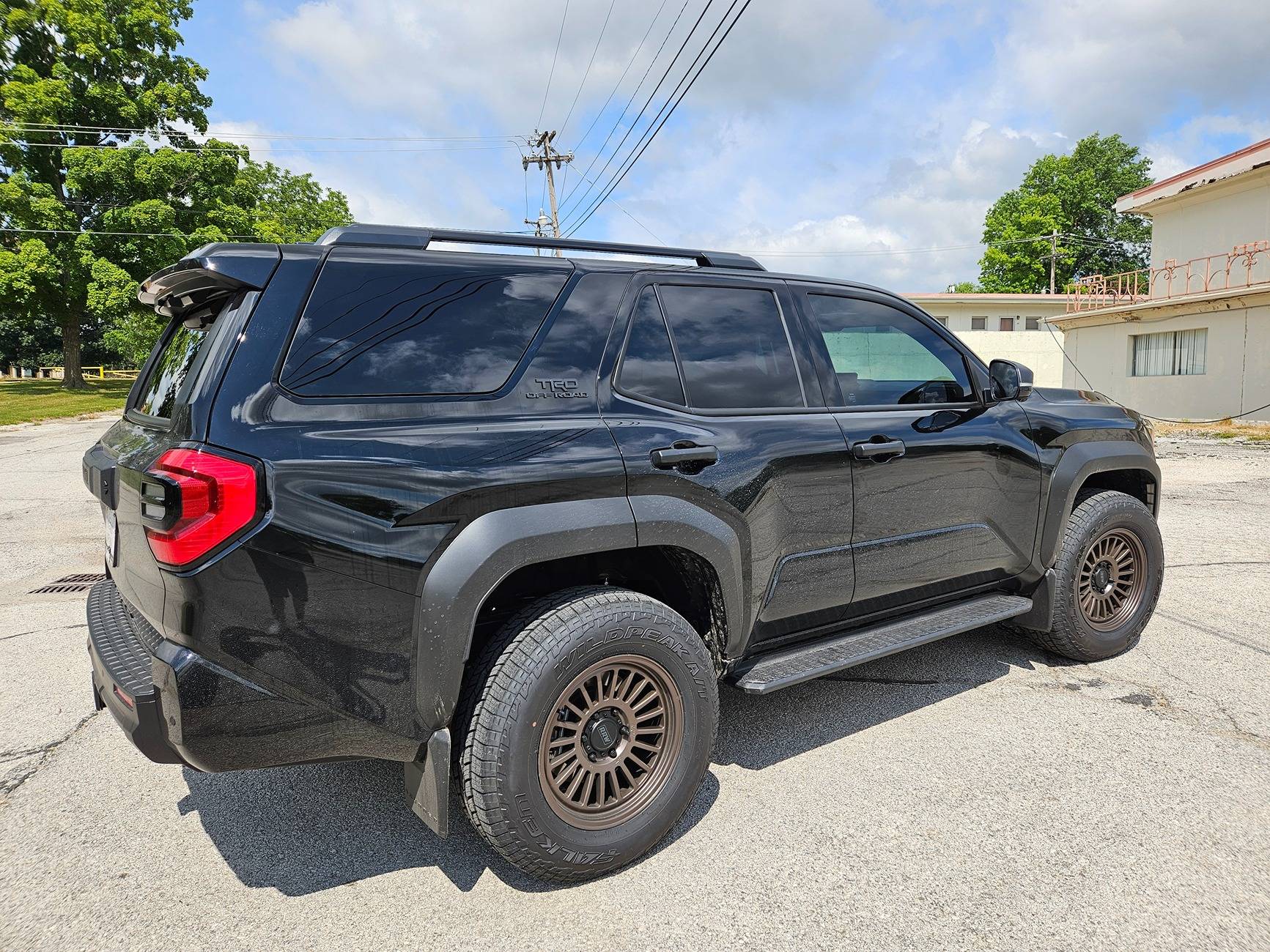

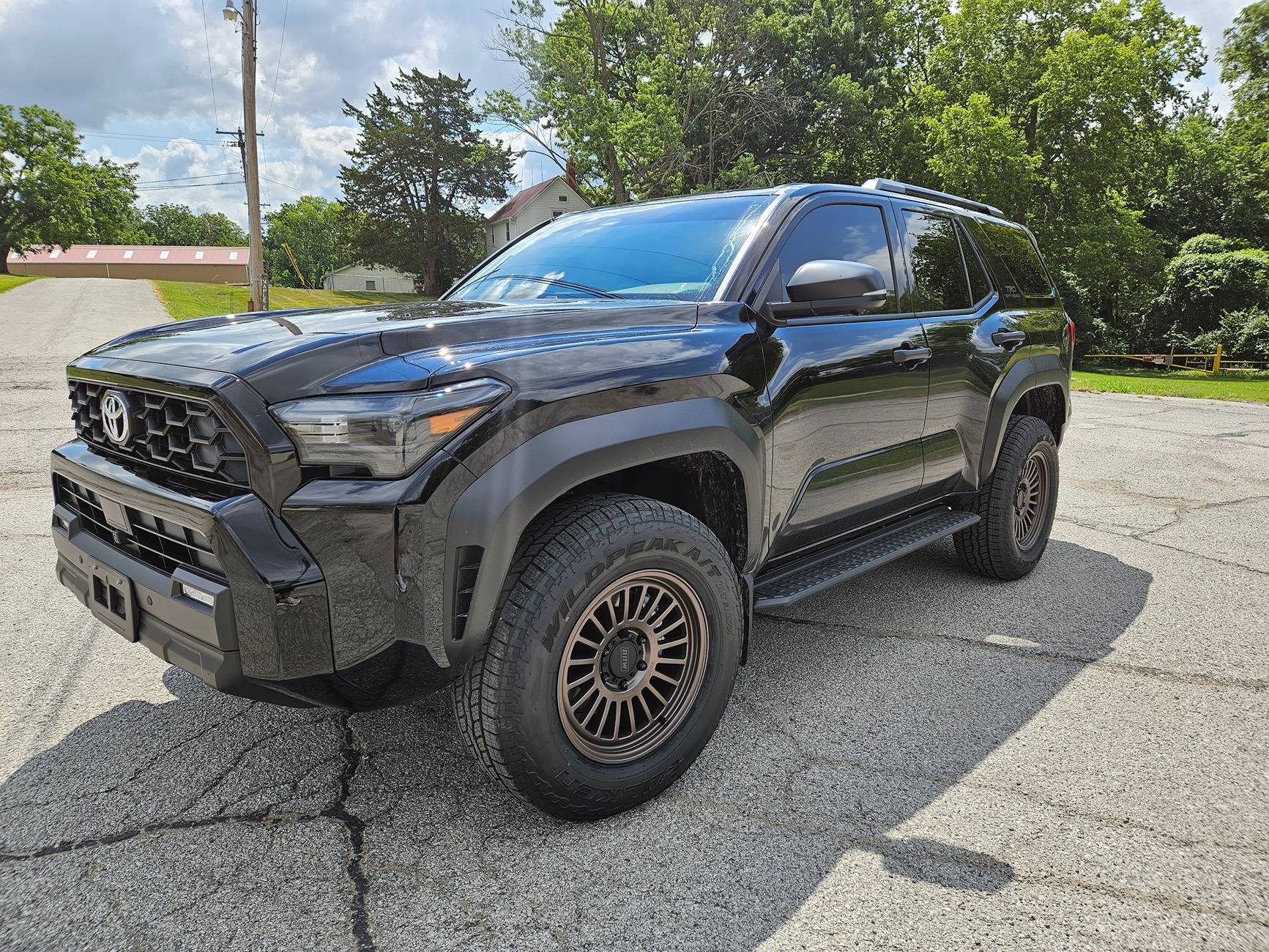

Underground TRD Sport on:
Westcott level kit - 2.5" front lift / 2" rear lift
+25 offset Method 305 wheels
Toyo Open Country R/T tires (295/70/17) - 33's
Barely any trimming required
2025 4runner Underground TRD Sport on 2.5%22 : 2%22 lift, +25 offset Method 305 wheels, Toyo O...jpg
they are only 33.3" tall right? Why would they rub at all at that size in a +25?...or did I read that size wrong? Just considering that 35"s need minimal trim.

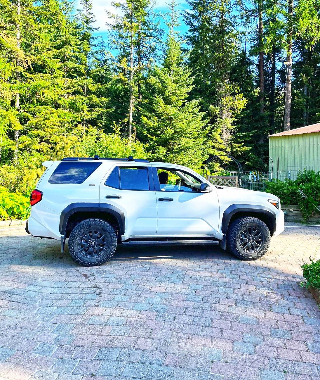

18x9 Method MR701 BLK PAINT rims
LT265/70R-18 BFGoodrich All-Terrain T/A KO3 E
2025 4runner 6th gen Aftermarket Wheels, Bigger Tires, Lift Kits (Compilation) for 2025+ 4Runner 6th Gen -- Add Yours! 4runner trailhunter build

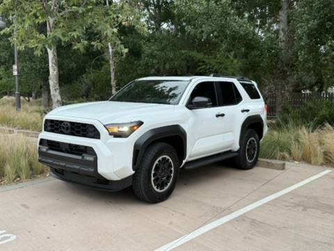

Stock 2025 4Runner SR5 on 265/70/17 Goodyear DuraTrac tires. No lift, no rub according to owner.
2025 4runner 6th gen Aftermarket Wheels, Bigger Tires, Lift Kits (Compilation) for 2025+ 4Runner 6th Gen -- Add Yours! 2025 4runner sr5 on 265:70:17 Goodyear DuraTrac tires

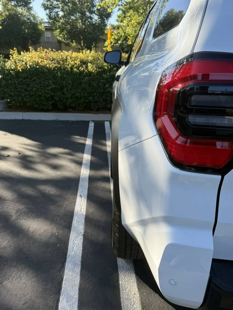

Stock suspension
RRW RS7-H MonoForged +25 wheel
Toyo Open Country A/T 285/75/17
2025 4runner 6th gen Aftermarket Wheels, Bigger Tires, Lift Kits (Compilation) for 2025+ 4Runner 6th Gen -- Add Yours! IMG_2307
2025 4runner 6th gen Aftermarket Wheels, Bigger Tires, Lift Kits (Compilation) for 2025+ 4Runner 6th Gen -- Add Yours! IMG_2310
2025 4runner 6th gen Aftermarket Wheels, Bigger Tires, Lift Kits (Compilation) for 2025+ 4Runner 6th Gen -- Add Yours! IMG_2306
2025 4runner 6th gen Aftermarket Wheels, Bigger Tires, Lift Kits (Compilation) for 2025+ 4Runner 6th Gen -- Add Yours! IMG_2309
2025 4runner 6th gen Aftermarket Wheels, Bigger Tires, Lift Kits (Compilation) for 2025+ 4Runner 6th Gen -- Add Yours! IMG_2308
After Westcott lift kit installed:
