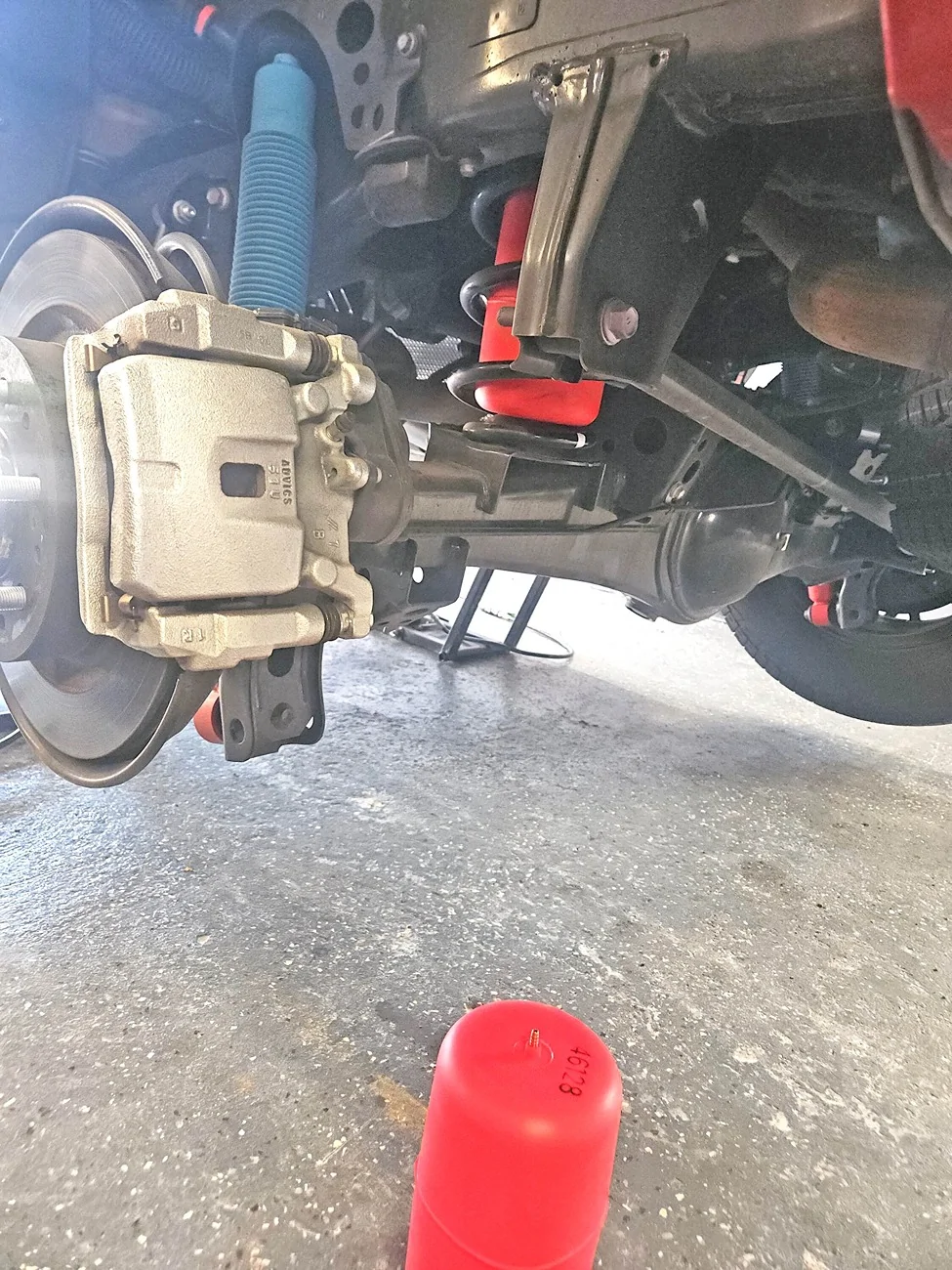

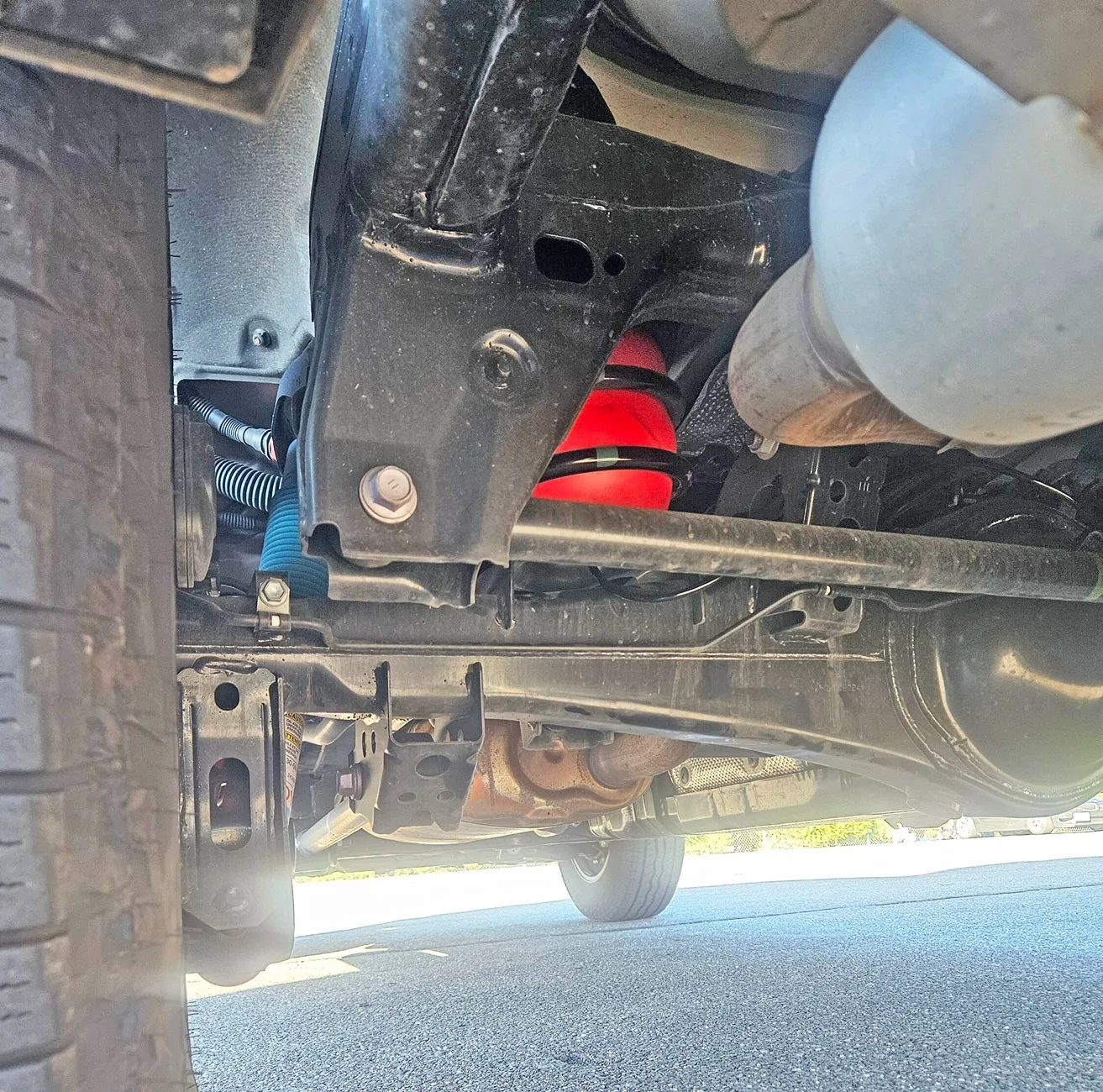

I recently fitted and towed with the airlift kit for the 5th gen in the 6th gen in case anyone is waiting on a kit. Firestone recently shared the same part number for their bags from 5 gen to 6th gen.

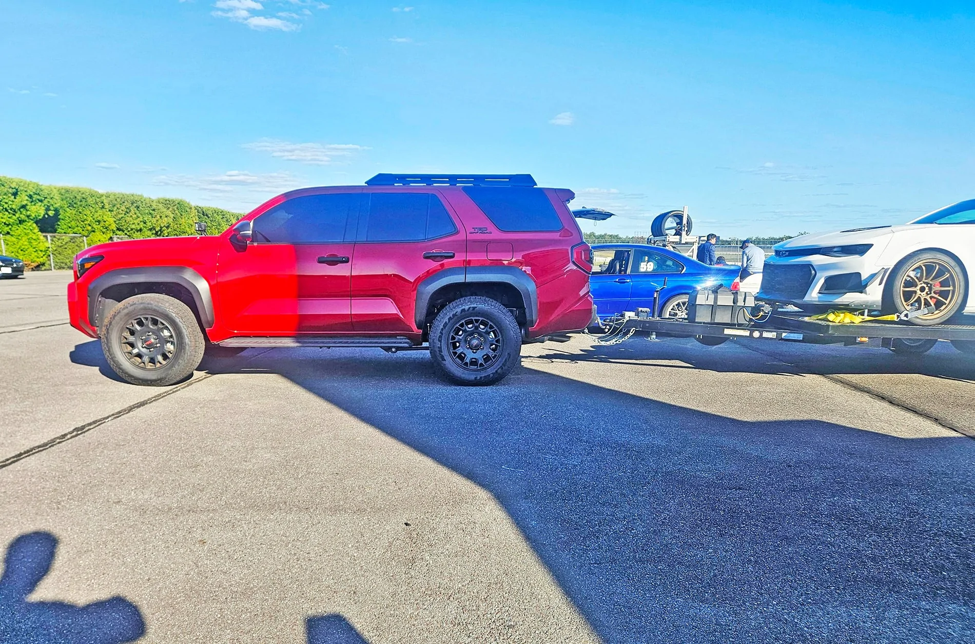

Loaded with a camaro and aired up to 35psi it raised the rear about 1 inch and lowered the front a bit evening the weight across the truck more and prevented bottoming out.
Install is probably 15-30 min if youre good mechanically, you dont even need to take the wheels off, just slip the bag thru the springs, route the lines, use the clamps. The right side bag can be a pain to get a clamp on because of the pan hard rod so I used a small ziptie and ran the schrader to one of the premade square openings near the rear bumper.

with out the trailer i drop it to 5psi and it rides the same as stock, while loaded with a trailer its up to 25-35psi and is better because i dont hit the bump stops anymore, but the Bilstein shocks do great at controlling the trailer or any bouncing.

I wasn't sure either but i couldn't keep hitting bump stops with the trailer haha so far im sitting around 15-20 psi with the car loaded to balance the ride height and ride quality with the bags

Just wedge them thru with the car lifted of course, since we dont have the bump stops to cut out its easy, don't even have to pull the wheels off

Thanks for the help Joey, I installed mine today however mine didn’t go on in 30 minutes 🫣. My brain couldn’t get over the nipple and hose clamp getting bound up inside of the coil so I ended up removing the springs and drilling out the top hole to allow adequate space for the nipple and clamp. Installation was fairly straightforward even though the directions were for a generation 5 4 Runner, the differences are obvious and they work great.

I don’t know what the instructions say, but, it looks like the OP installed his with the schrader pointing down. My brain tells me to point it down so it can be drained if need be due to moisture that is inherent in compressing air

I have had airlift airbags in the last three or four vehicles and most of them installed with the Schrader valve up.
