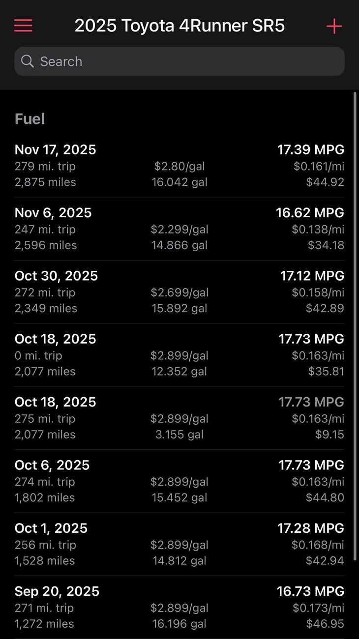

From what i’ve experienced, 17.26 MPG. However, my commute is mostly side streets with some highway driving on weekends.
The estimated mileage is definitely based on your driving habit, and not counting our reserve.
Reserve tank seems to be at 2-3 gallons, I’m tempted to run an experiment on what the reserve level is after the fuel bar disappears. Lol
Trying to make sense of things, quick math is take your current MPG and multiply that by 2.5 for your “safety net” miles. Add that to your estimated miles left and thats our actual total based on latest driving habits.
I record my fuel fill ups with “Road Trip” and like looking at the data trends.
