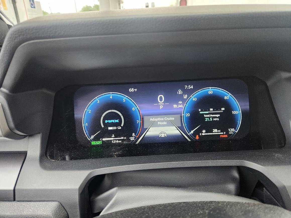

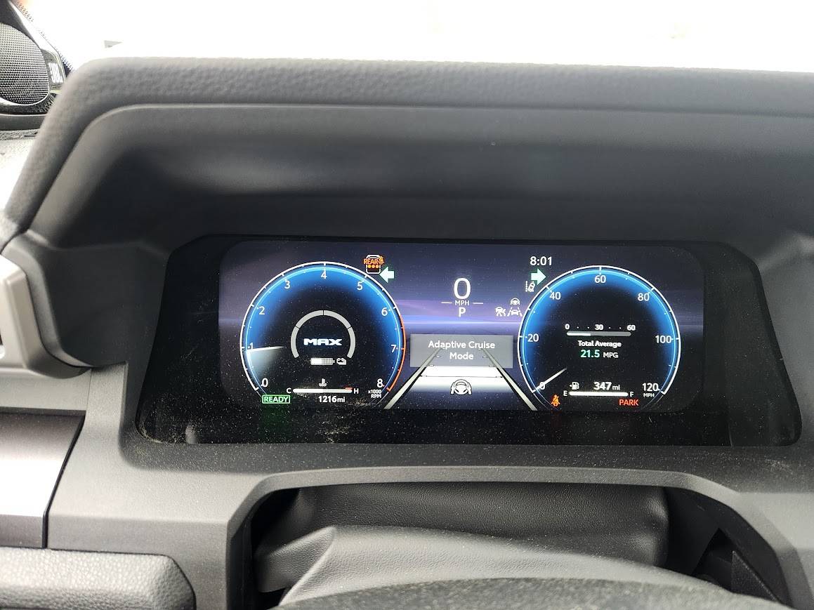

Your post got me wondering so I finally recorded the data on my 4th fill up. Before the fill the dash said 28 miles to go (fuel gage was at about 1/10 tank) after having driven 362 miles. After the fill the gauge read 347 miles. And that third tank got by far the best milage to date: 22.5 MPG (mix of highway and "city". The actual miles to go based on 19 gal capacity minus the 16.07 gallons I put in @ 22.5 MPG was 66 (vs. 28 displayed). So zero miles to go on the dash would be about 2 gallons/45 miles in the tank. So, like others have experienced, I think it would easily go 400 miles on a tank if mostly highway.
Caveat: this is iForce Max so hybrid might help some but based on what I've seen the non-hybrid has a real advantage on the highway. (And for my short "city" commute I'm getting nowhere near the Hybrid quoted city MPG of 23 - more like 14:>) (but I did just get 27 MPG on a 34 mile trip - much of it going 45 on a 2 lane highway behind a slow moving trailer.)

Proof that the "miles to go" adjusts as the tank depletes: I've driven 191 miles (1407-1216) since last fill, and its now showing 184 miles left in the tank - for 375 total vs. the 347 it said right after fill. And with the expected 2 gallon (~45 miles) of reserve it should be easy to break the 400 miles/tank barrier, with a gallon or so in reserve. Hope the OP is seeing similar improvement over time.

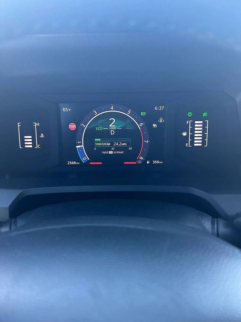

Trip to CO from Dallas. First leg. See pic. When I filled up the tank I got just 24 plus miles on full to empty. The MPG went up but still puzzled. I will see if in my way back which will be from higher altitude to about 700 ft anything will change. Hopefully I will get better MPG due to the altitude changes.

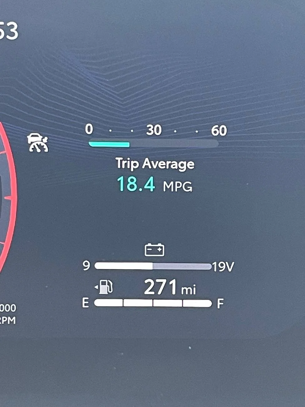

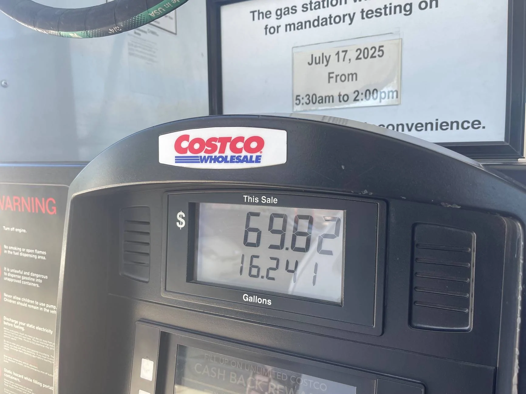

I really dont understand this... car says "refuel" and pump stops at 16 something gallons in a 19 gallon tank??? maybe toyota left Tacoma's smaller tank size coded in software... since both cars are essentially the same.
Check out this thread: https://www.4runner6g.com/forum/thr...gas-indicator-accurate.2652/page-2#post-65870
And note that the owners manual specifies that the "Low fuel level warning light ... Indicates that remaining fuel is approximately 2.8 gal. or less."
Looks like you put just over 19-2.8=16.2 gallons in. So exactly what is to be expected.
Also, your MPGs and distance to empty are kind of low, but if this is your first tank then I believe you can look forward to improvement over time - at least that is what I experienced:

Update…. Back from Colorado. I pulled 25 mpg with a 401 miles full to empty tank. So yes. It is all about resetting the mpg dial.
