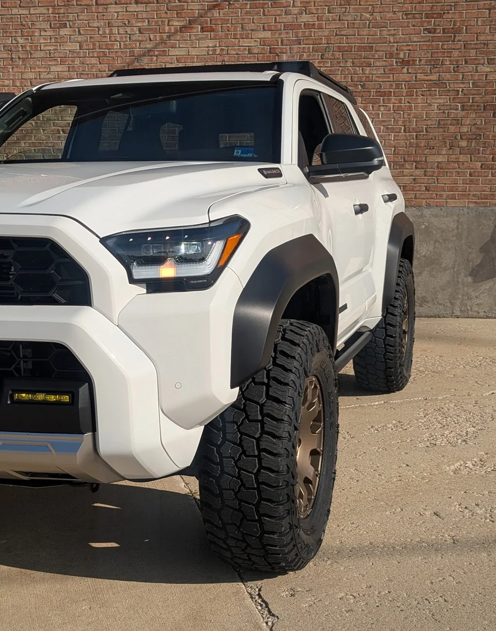

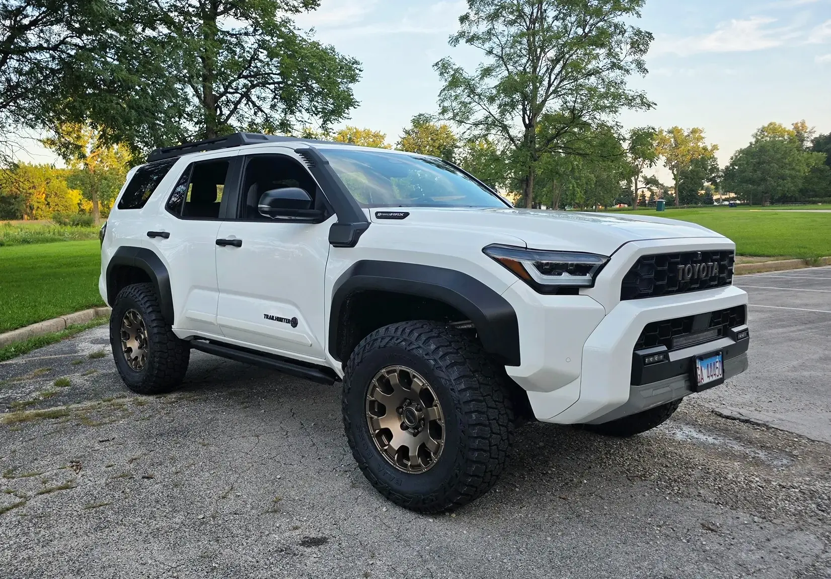

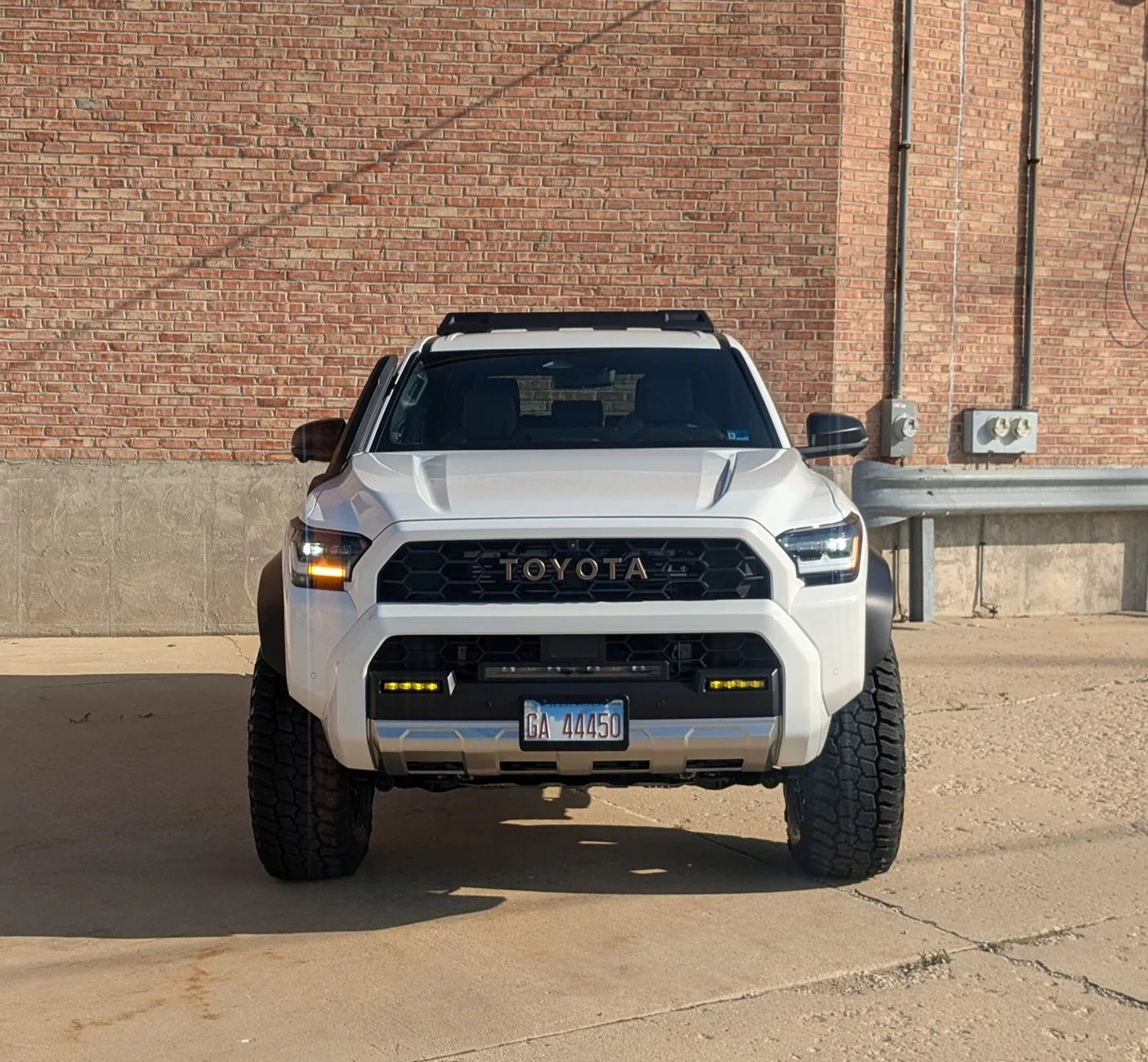

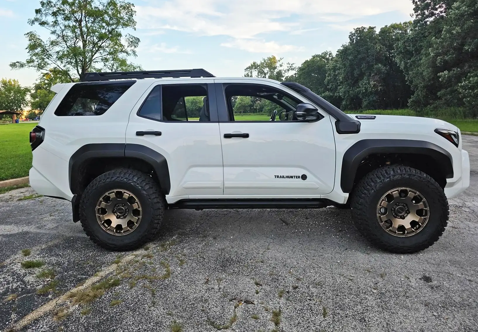

Finally finished the Westcott front preload collar lift, OME rear spring, and 35x12.5x18 Baja Boss AT tires.
Very surprised how well this rides compared to my 5th gen, even with the D-rated tires, it's very smooth.

Looks amazing! So you did you just install the Pre Collar kit up front? Which spring did you use in the rear? Was that to level it or was it for additional weight?

How is your gas mileage now? Also did you trim anything so there’s no rub?

Why the preload collar? Is it suppose to level the front with rear?
I tow a little trailer, so I wanted the springs instead of the puck. OME med. rate spring.

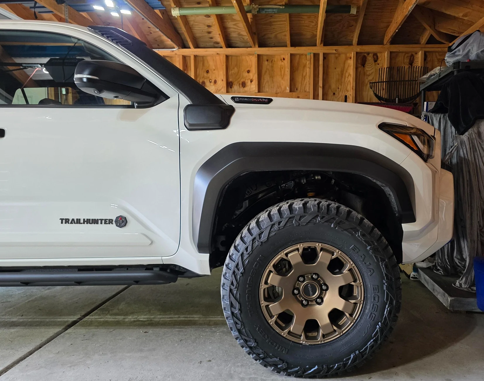

No trimming at all, at the moment I didn't even remove the "crash bar"... I'll remove them this weekend, so far they're not even rubbing them.
Gas mileage is hanging around 15.5.
Preload gives 2.5 front lift and 1.5 -2" lift in the rear with the OME springs.

ok so this is a more for looks and tire clearance.
Aside from cost or lack of... why use a collars wouldn't this eventually prevent some travel limits of suspension? It would make more sense if it wasn't a trail hunter this seem like kind of limiting the trail hunters suspension...I'm genuinely curious not just poking holes in your build.

Like it a lot! Which OME spring did you use in the rear?
