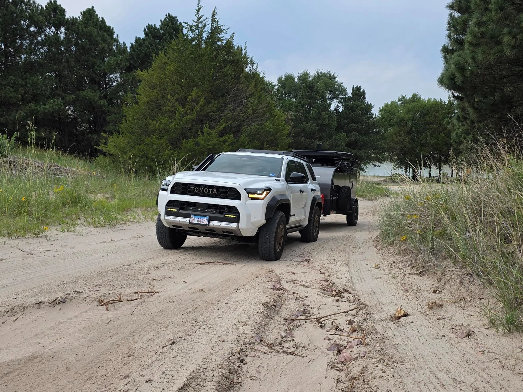

Nice! We just got back from the Ozarks. It’s kinda fun opening OnX, looking at an area and then heading out. The TH has handled everything great, you won’t be disappointed. Enjoy!

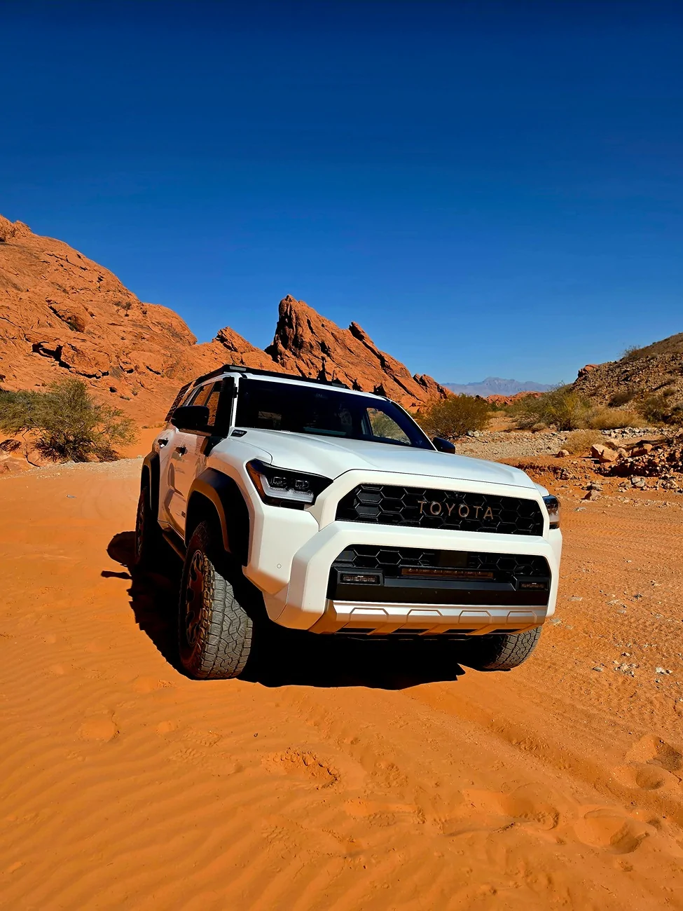

Your Trailhunter looks awesome! Just picked up mine last week. Going with Dobinson springs for lift.

That trailer looks like an Intech Flyer, been looking at thoes and the Intech Luna.
