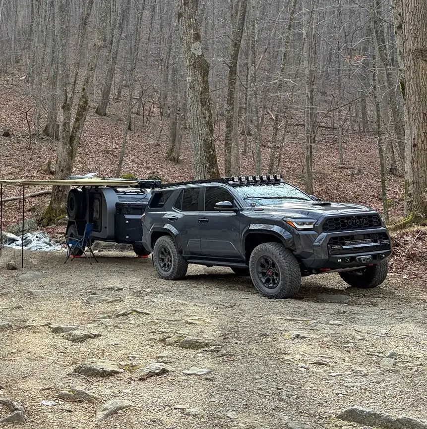

Changed my suspension up - Dobinsons rear springs (C59-817V) and a Westcott Designs front preload collar only lift. Last pic is were I currently am right now in it haha.
I’ve added a CBI stealth front bumper and a Westcott Designs low pro roof rack with Baja Designs LP8s on it as well as S2 Pro ditch lights.
2025 2026 4runner 6th gen Underground TRD Pro on Dobinsons Rear Springs + Westcott Preload Collar Lift Kit + 35" Tires (Nitto Recon Grappler 295/70R18) IMG_0085
2025 2026 4runner 6th gen Underground TRD Pro on Dobinsons Rear Springs + Westcott Preload Collar Lift Kit + 35" Tires (Nitto Recon Grappler 295/70R18) 7CA44F81-A2E8-44CF-AC9A-E1990C3F7183
2025 2026 4runner 6th gen Underground TRD Pro on Dobinsons Rear Springs + Westcott Preload Collar Lift Kit + 35" Tires (Nitto Recon Grappler 295/70R18) IMG_0192
2025 2026 4runner 6th gen Underground TRD Pro on Dobinsons Rear Springs + Westcott Preload Collar Lift Kit + 35" Tires (Nitto Recon Grappler 295/70R18) 28162-f2ee3510ac6b5a0250af65fdd774db8c

Which Dobinsons springs did you go with? I’ve been considering this exact setup with the C59-885V coil on my non-hybrid ORP.

I think mine are C59-817V

Nice looking setup. How's the ride quality with Westcott + Dobinsons compared to stock and your previous Peak Suspension 1" lift?

no change in ride quality

Love this. What's your current MPG? Also, where did you get the TRD Pro front TOYOTA grille?

in the winter I was seeing about 20 mpg around town while taking it easy. Seems like the summer heat affects it though and I’m seeing closer to 15 now.
as for the grill, the truck is a TRD pro, that’s how it came.

Any plans for matching spare? 295/70R18 look great
