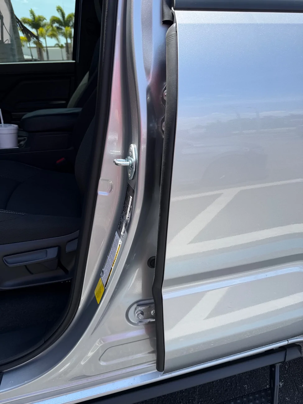

I don't know why they stopped installing this on vehicles, but you'll still find it on Lexus and other higher end car. It was a simple install that only took a few minutes. There is a noticable exterior sound dampening differece with wind/air noise. Totol cost of the mod was $11.99 on Amazon. 2 pc 2.62 Ft is all you'll need. You will have to trim a few inches off. Start from the top of the door and install moving downward. Note- the link below says "does not fit 2025-2026 4Runner". But it worked perfectly. Link for Amazon below photo
2025 2026 4runner 6th gen Door Seal Rubber Edge Trim - cheap mod to reduce wind / air noise IMG_0590

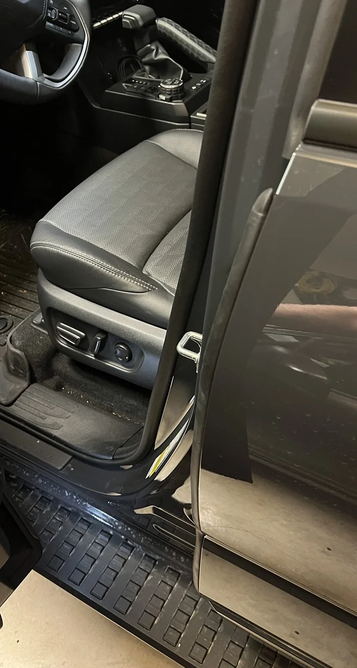

I want to order this seal, but the picture shows it on the leading edge of a sliding side door on a van. Any pictures with this seal installed on your SR5 FloridaPhotog?
It would install exactly the same way on your rear door.

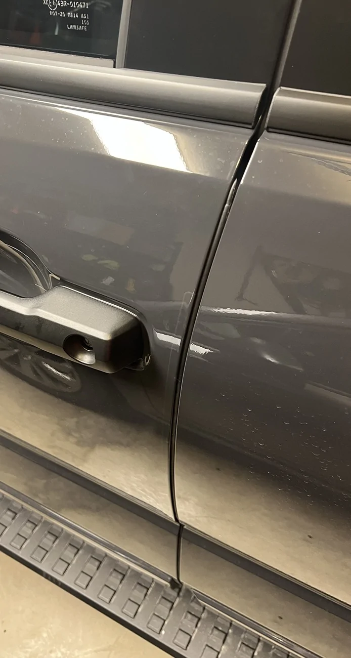

Push it on the groove and cut the excess off the bottom.
