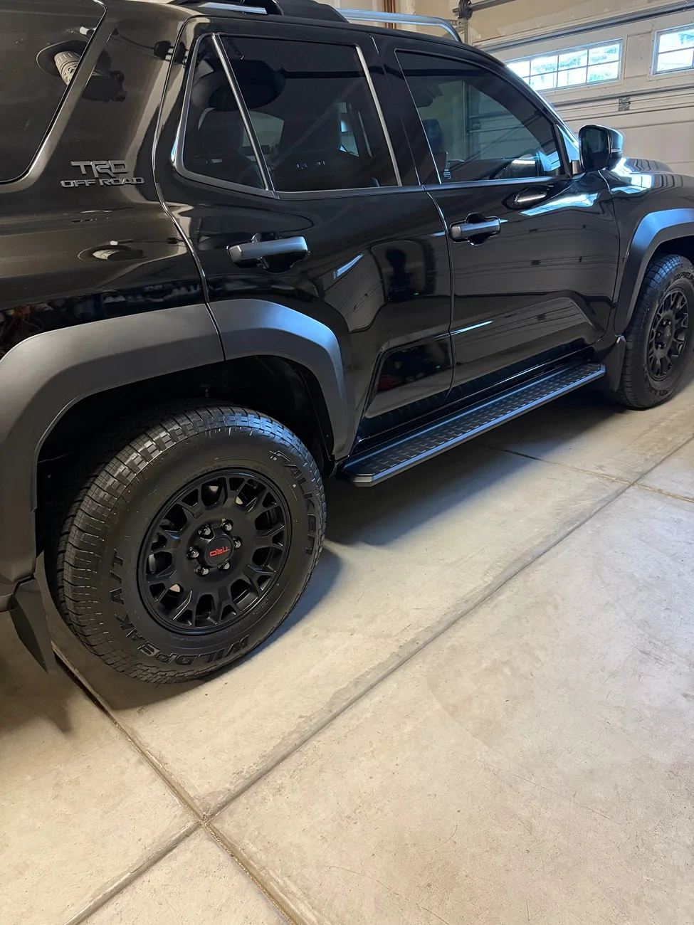

They came installed front and rear doors on my ORP and seem totally pointless, even as someone who spends a lot of time getting in and out of the 4R with dirty shoes and boots. IMVHO.

Those are the "Door Panel Scuff Protectors". The door edge guards are the body colored strips on the edge of door.
I was thinking about ordering the door edge guards but had only saw they came as 2 so wanted to make sure there wasnt a back set, which sounds like there isnt.

Oops sorry. Mine came with those as well on all 4 doors too. It’s just a thin strip of clear PPF, and again seemed pointless to me so I took them off asap while it was still easy to do so. Just collects dust and dirt on the edges and makes detailing a bit more of a hassle. If you have to park a lot in tight parking spaces in a garage or something maybe it’s more worthwhile, but for my uses not worth it.
Again IMVHO.

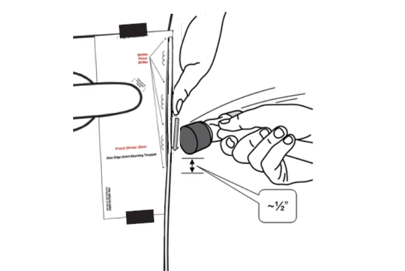

front doors only. they are metal and perfectly match the paint,
and are hammered on. I suspect paint damage if i try to remove them.
here are the Tacoma instructions, it's exactly the same procedure for 4runner
https://toyotaparts.sparkstoyota.com/install/PT936-35241inst.pdf
....WHAM!

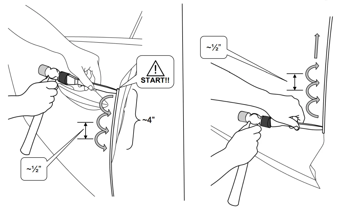

To remove them, you need a nylon removal tool (trim tool designed to be used with a mallet) and pound down in 1/2" increments for 4 inches, then start again at the bottom and pound up in 1/2" increments

I figured they were hammered on there. What I might try is to pry the inside edge open allowing it to slip off more easily. I do have the nylon removal tools that I could use, but I figure maybe opening it up like a tin can would reduce the chance of damage to the door paint.
