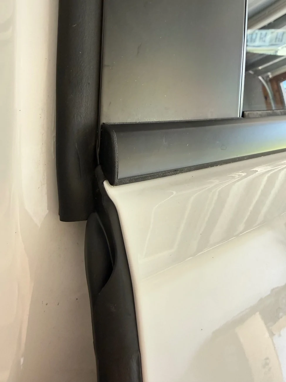

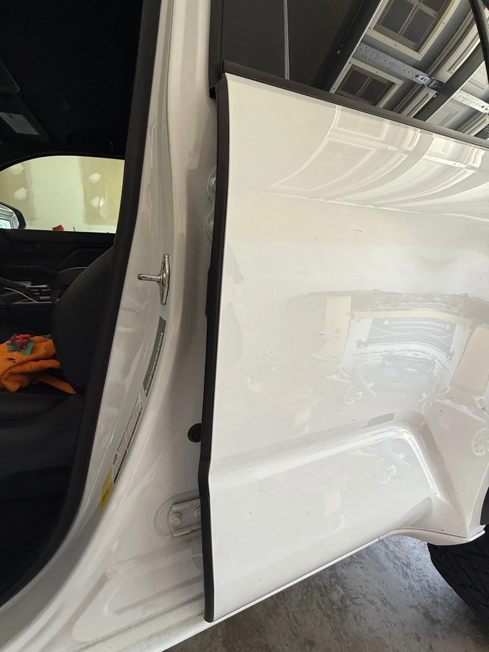

I don't know why they stopped installing this on vehicles, but you'll still find it on Lexus and other higher end car. It was a simple install that only took a few minutes. There is a noticable exterior sound dampening differece with wind/air noise. Totol cost of the mod was $11.99 on Amazon. 2 pc 2.62 Ft is all you'll need. You will have to trim a few inches off. Start from the top of the door and install moving downward. Note- the link below says "does not fit 2025-2026 4Runner". But it worked perfectly. Link for Amazon below photo
https://www.amazon.com/dp/B0G33X396H?ref=ppx_yo2ov_dt_b_fed_asin_title&th=1
