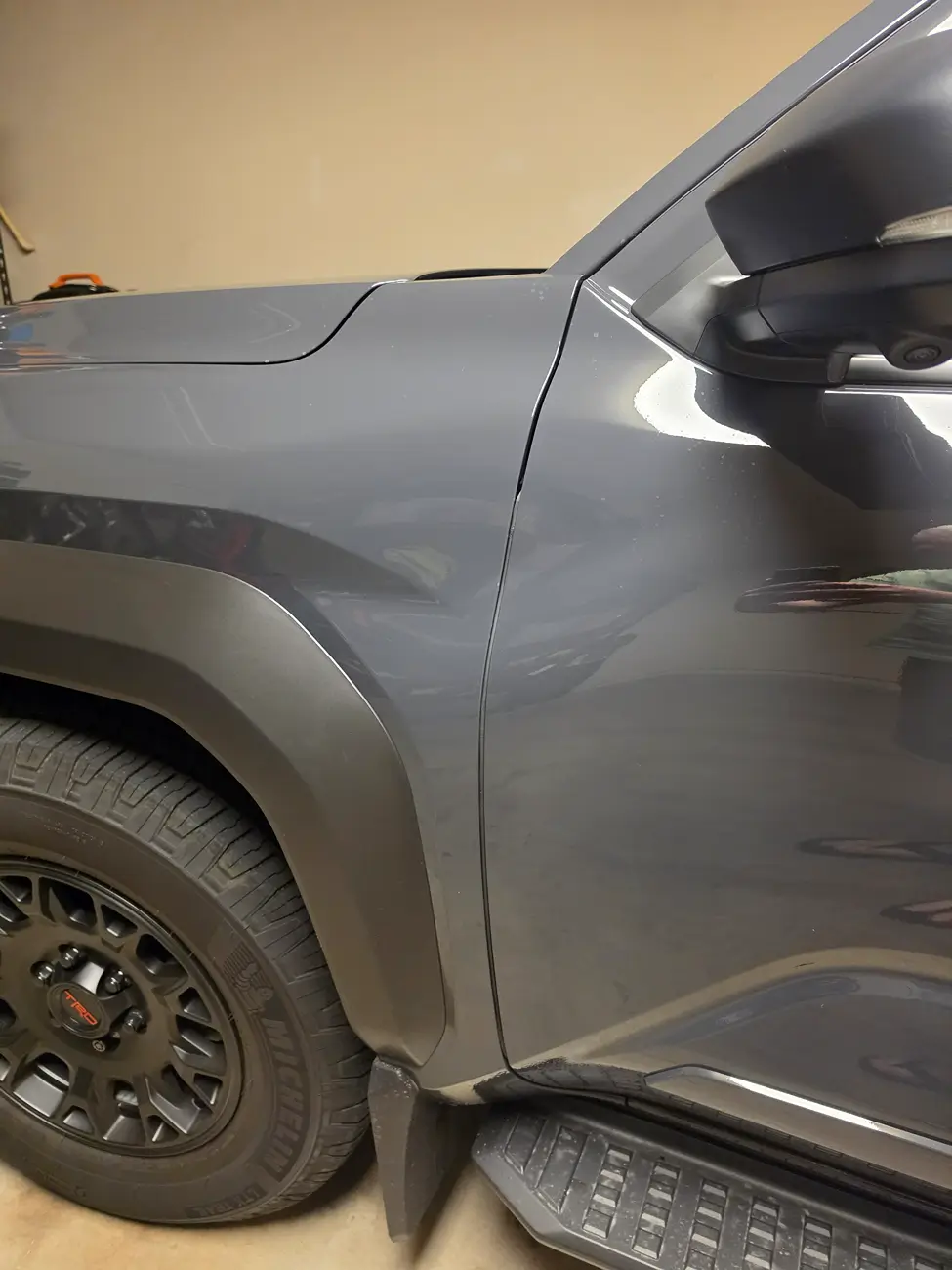

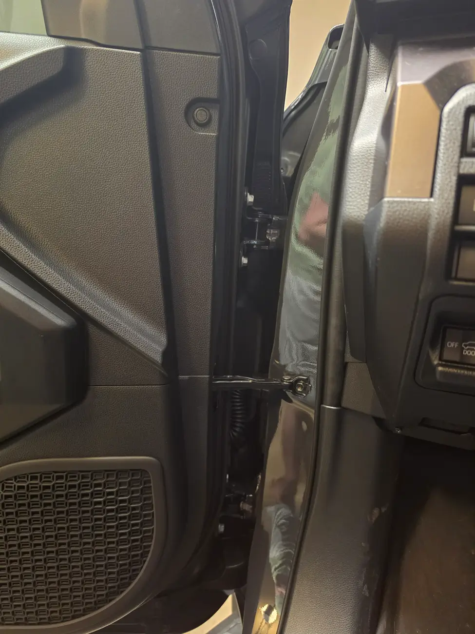

I did in fact install the front door Tacoma ones. The process sucked but I got it done in the end, and it fits.
I don't recommend anyone else try this as drilling into your doors is dangerous as the drill bit can slip forward and dent the exterior door panel (less than one inch air gaps in the door). After drilling I painted the exposed metal. Also the four bumps on the door where the trim goes are more of suggestions, its just so hard to line up correctly. And finally, I don't notice any wind noise reduction. However I have fully sound deadened my doors, so it could be different for you.
