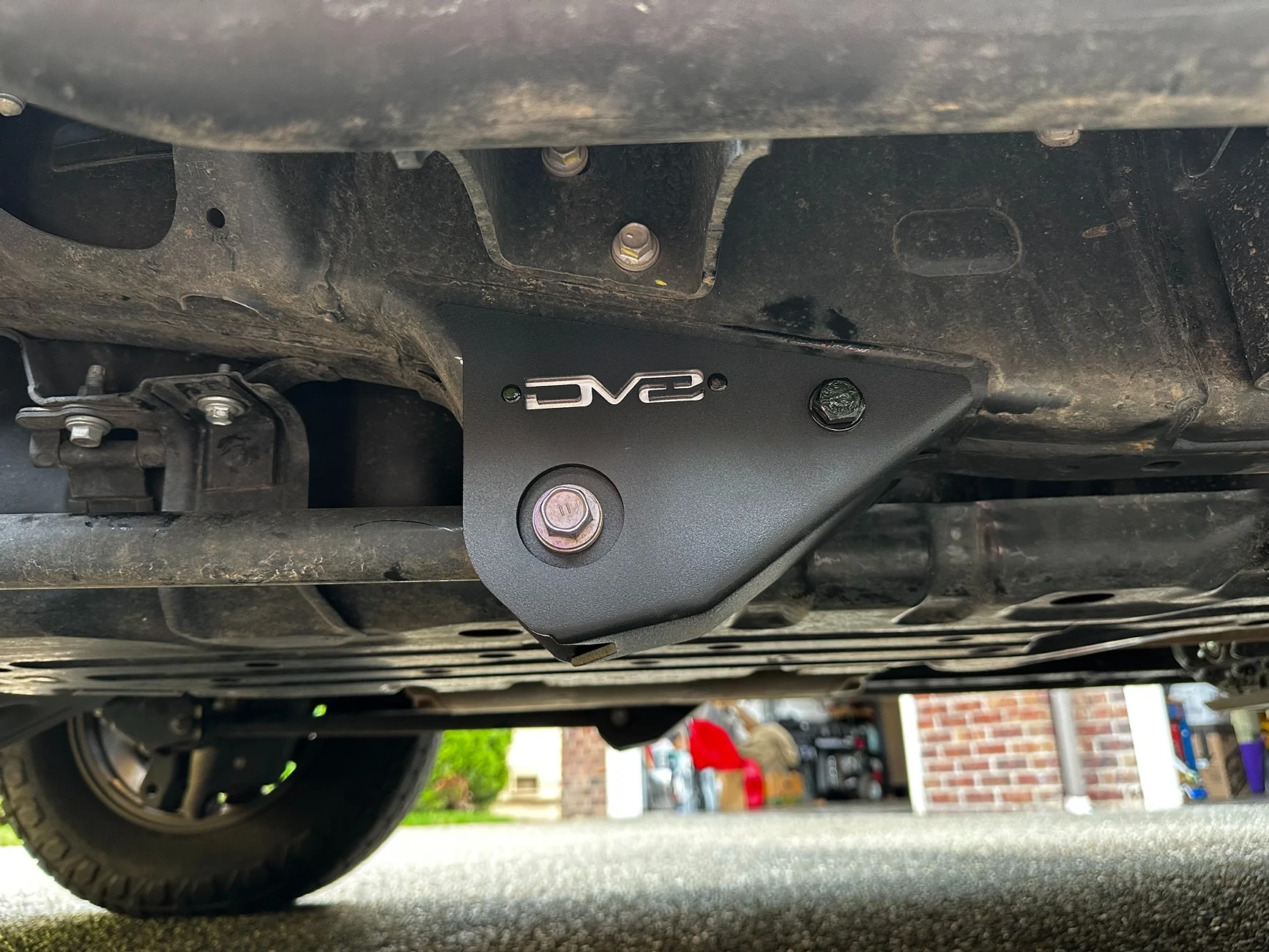

Installed DV8 trailing arms skids. Never had any after market skids on my 4th gen and this never seemed to cause damage, but protecting the trailing arms seems like it's worthwhile. Looked at multiple brands, these seem to have the right amount of coverage while hopefully not accumulating too much dirt.

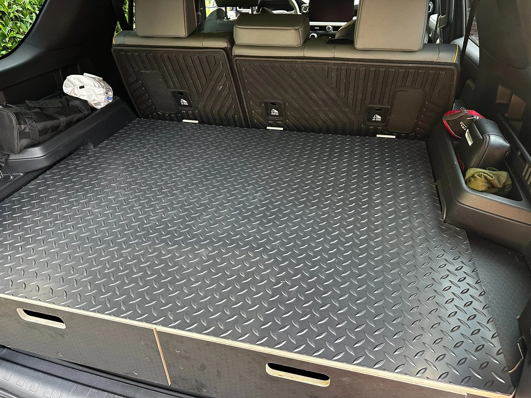

Sure, here is the rear seat delete platforms. This includes the rear section and the rear-seat delete section.

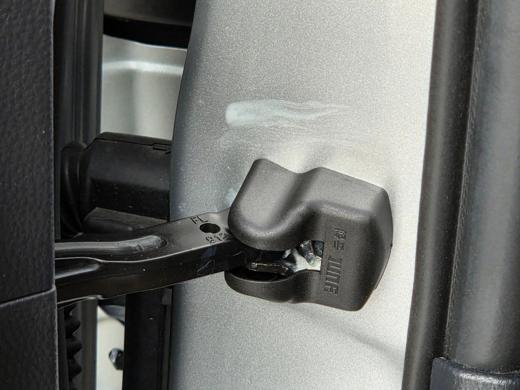

Small mod worth doing available on Amazon. Door Stop Protective Cover for 2024 2025 2026 Toyota 4Runner & Tacoma Waterproof Anti-Rust Decorative Cover Car Door Bracket Cover Interior Modification Accessories. Clean door stop, lubricate with white lithium grease, wipe excess, and snap cover on. Repeat lubricating every so often.

Right now the knob just spins. No clicks. You think that part would fix that?
Take the screw out and see if the splines on the inside of the knob are stripped, if so, then yes, a new knob will fix it. Even comes with the sticker to replace.

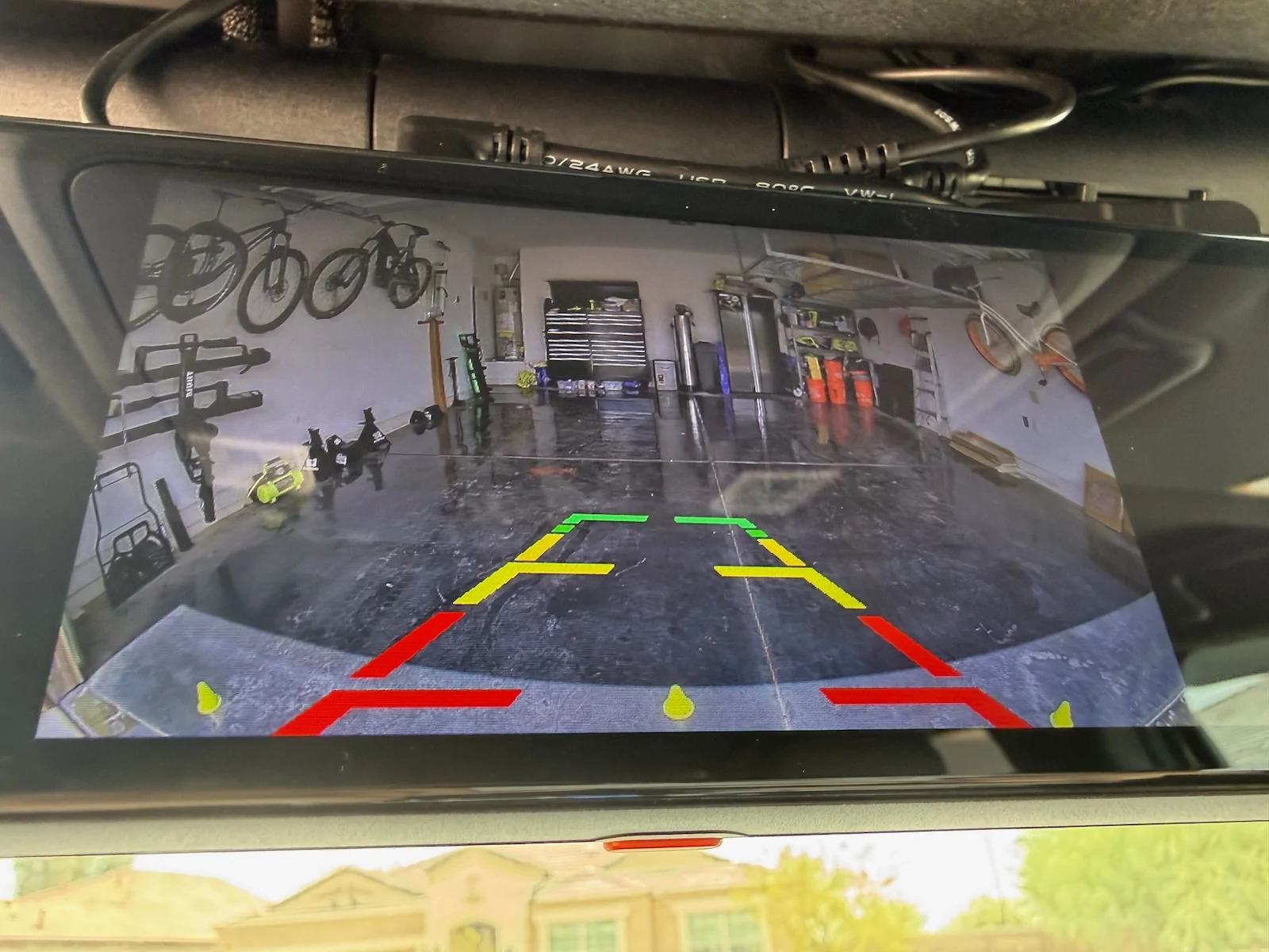

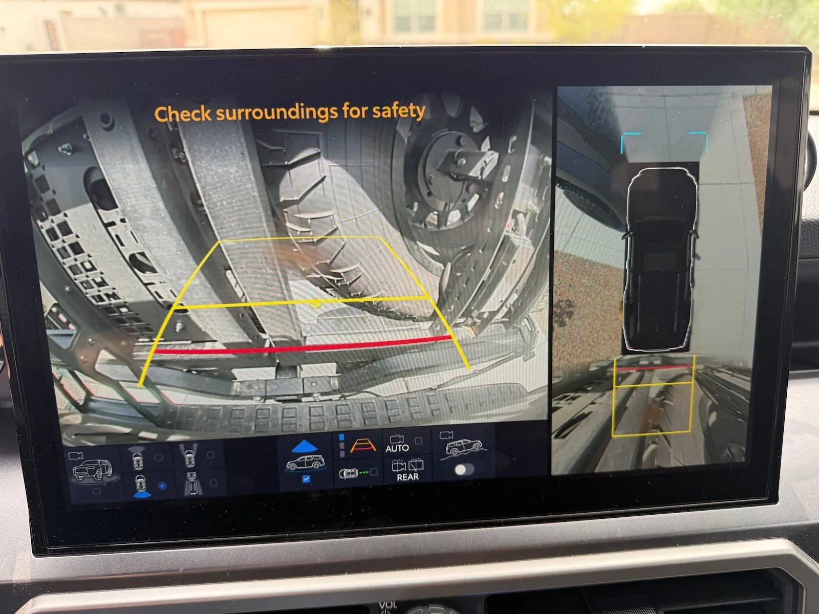

Here is the rear view camera blocked by the rear hitch swing out. Pretty much worthless.
2025 2026 4runner 6th gen What did you do to your 6th Gen 4Runner today?? πŸ‘¨πŸ»β€πŸ”§ 🧰 πŸ›  IMG_1374
The Wolfbox G900 Tri Pro rear view camera on the rear spare tire in backup mode. Added some cones to show the FOV area, sorry I could not get them right on the edge but next photo should help with the scale.
2025 2026 4runner 6th gen What did you do to your 6th Gen 4Runner today?? πŸ‘¨πŸ»β€πŸ”§ 🧰 πŸ›  IMG_1377
And here you can see where those cones were so you can see that there is a substantial distance from the rear hitch mount to the point where the lower edge of the camera is. I actually don't mind it since there is no way for me to run into anything since I use the red line to stop and that still leaves me like 2-3 feet of clearance.
