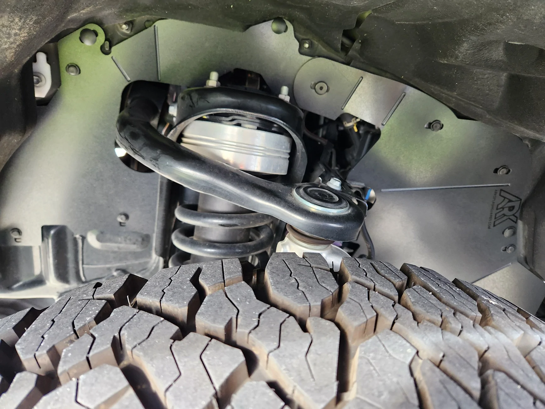

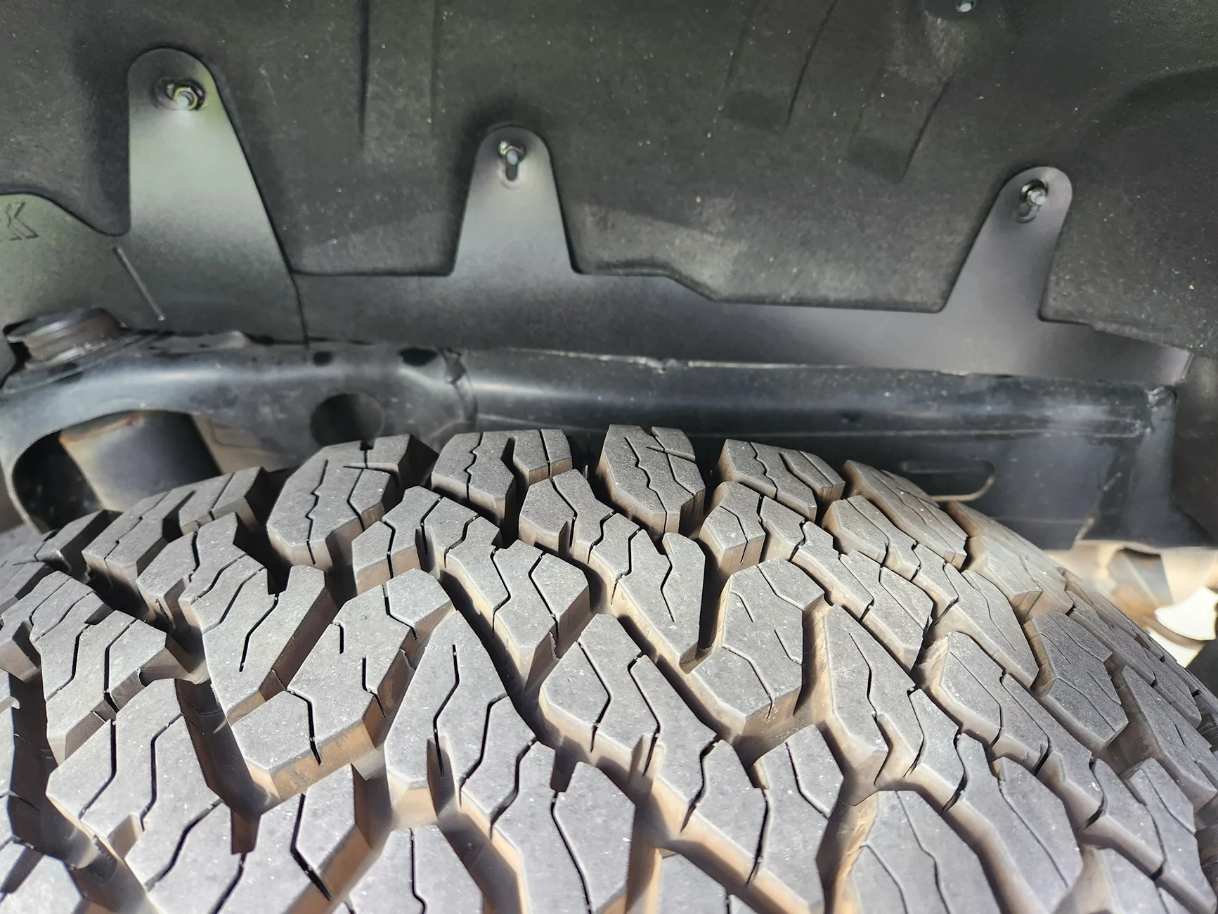

Installed Ark front/rear splash guards. Install wasn't bad and didnt jack or remove wheels. Also installed TRD pro mud guards (wider/taller).

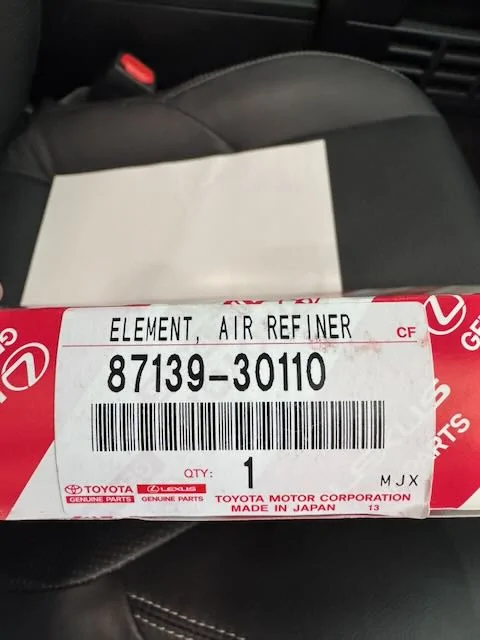

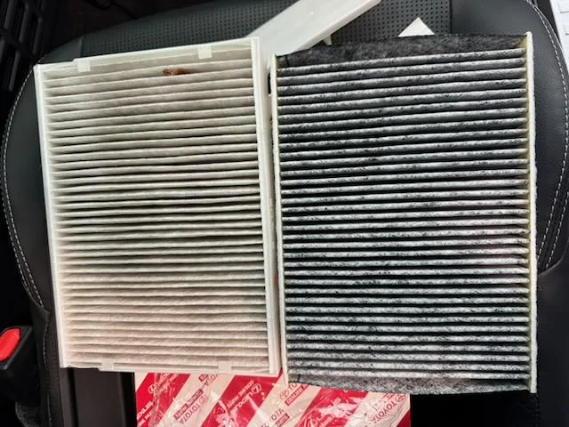

Changed my in cabin air filter. With the forest fire smoke hitting the NE pretty hard thought it was a good move even if it's only 4 months old. My furnace filter which is changed monthly was nearly black. Used the GX550 filter as it's a nicer charcoal filter compared to the paper 4R filter. Cost with tax was $54.54 at the local dealership. Part # 87139-30110.
2025 2026 4runner 6th gen What did you do to your 6th Gen 4Runner today?? πŸ‘¨πŸ»β€πŸ”§ 🧰 πŸ›  IMG_2913
GX550 filter on the right.
