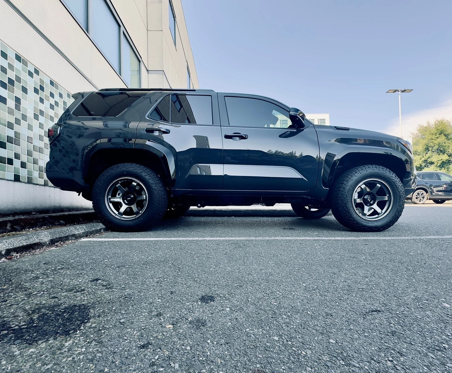

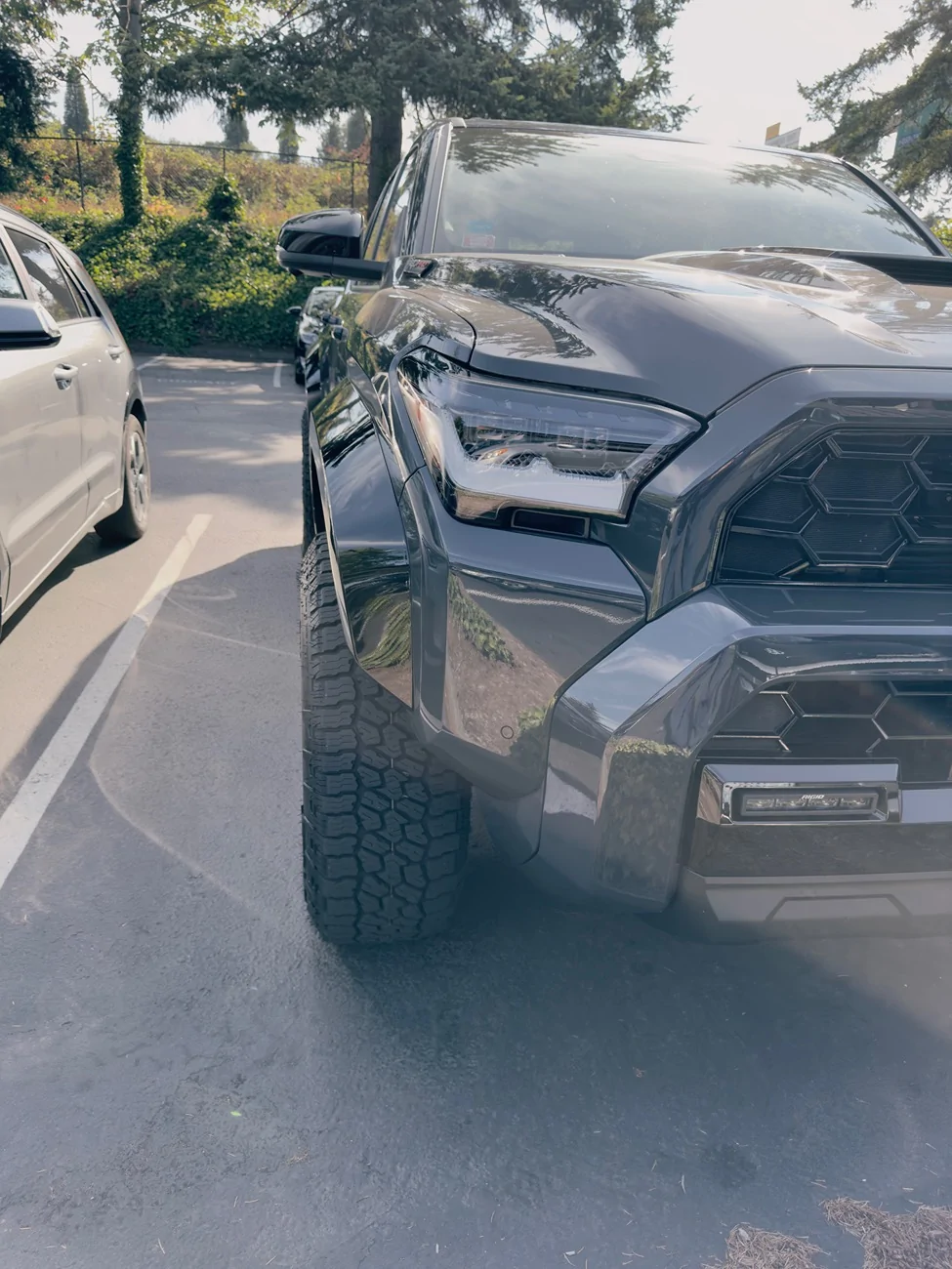

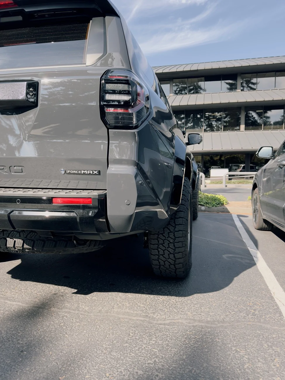

Good on you for being cognizant of wheel weight before making your purchase. This is the reason I went with Volk TE37’s at 19 lbs each and ditched the TRD anchors. Kept the stock tires so it’s a direct rotational weight reduction with no increase in tire weight, diameter, or width.

i ran down the wheel weight rabbit hole and saw your volks in another post, man those are 🤩 :love: but freakin pricey as heck!

Definitely not cheap… But worth every penny. Zero mounting/balancing issues. No weird vibrations on the highways. Dropping 60 lbs rotational weight makes the truck feel more nimble. Slight improvement in MPG, acceleration, braking, and handling.
It helps that the TRD pro wheels are in demand and sold a few days after listing. Offset the cost by 1k.

Did you stay with OE offset?

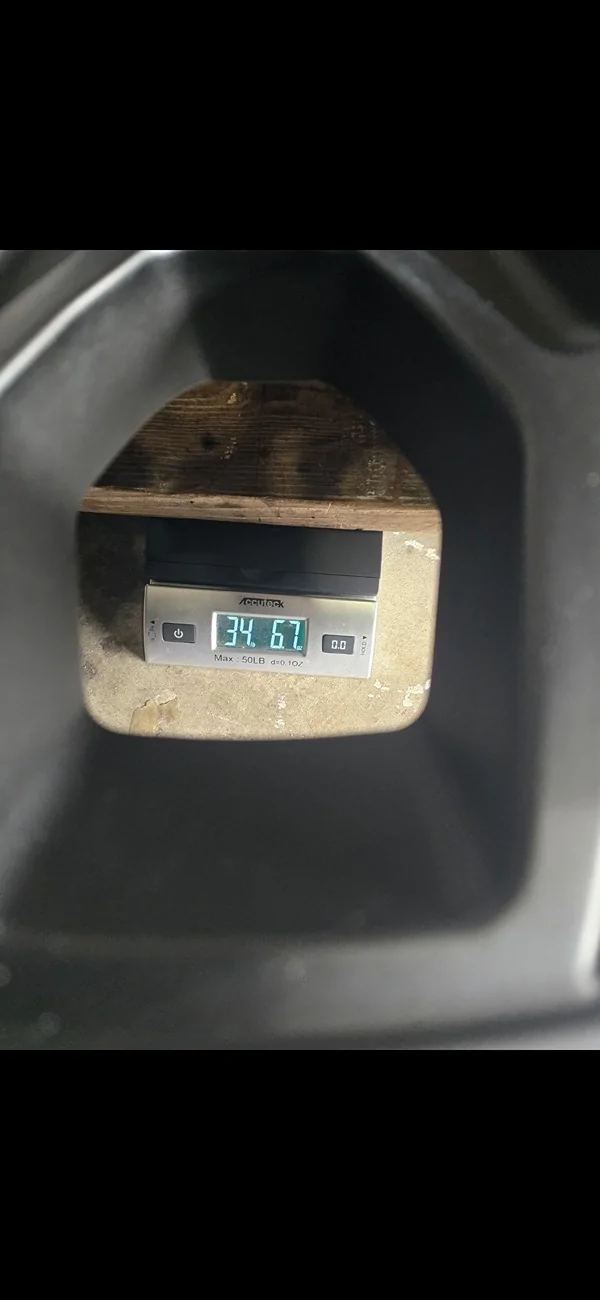

Little late to party, but I did weigh TRD Pro wheels (zeroed out the wood first) and actual weight of just wheel, no tire, no counterweight, no TPMS is 34# 6.7oz

Thanks for this. Love my Pro wheels but have regrets now that I know how hefty they are 😔
