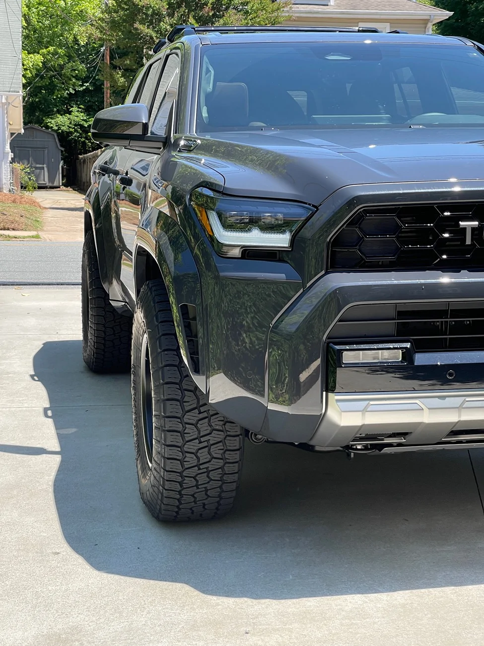

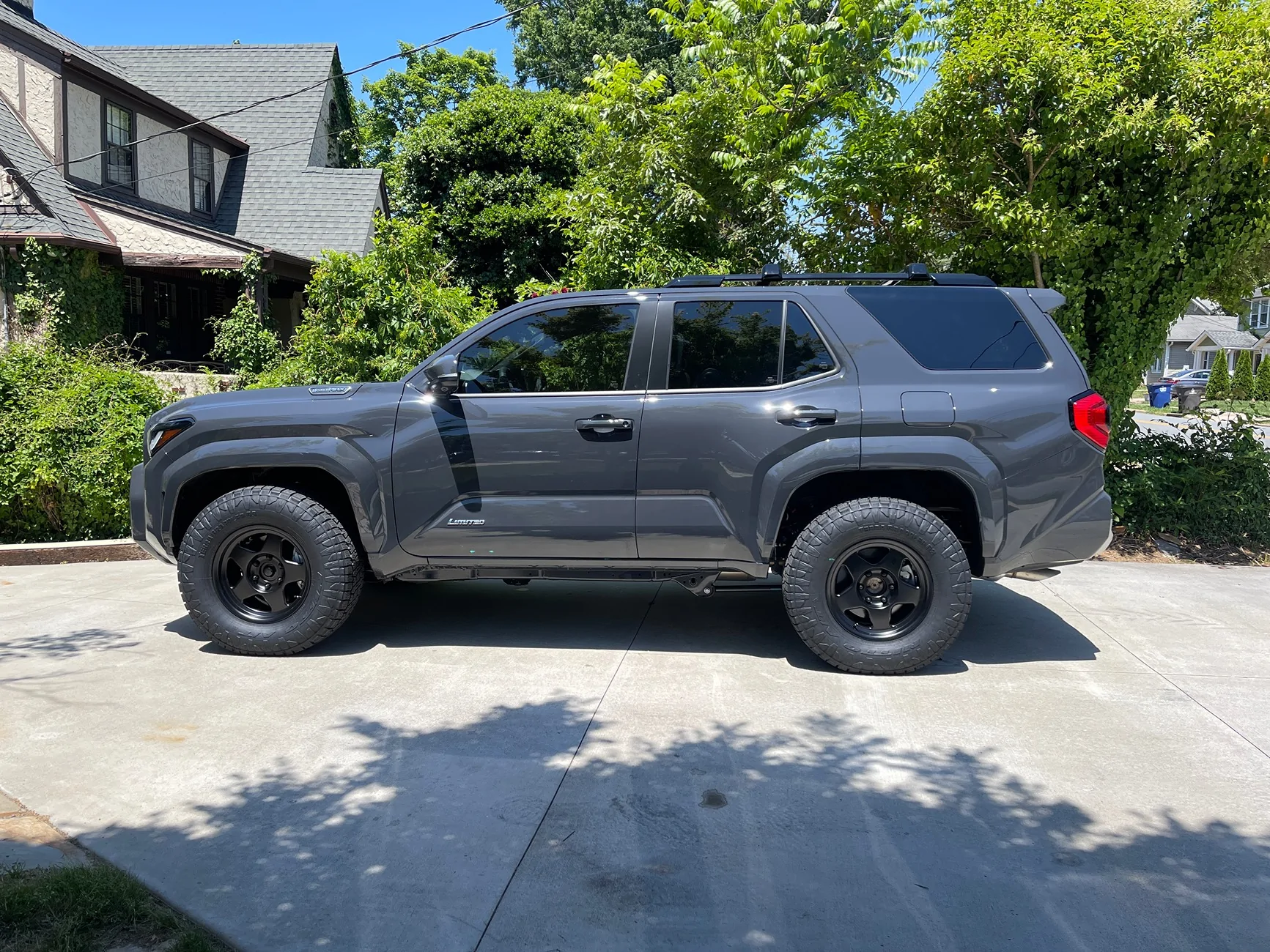

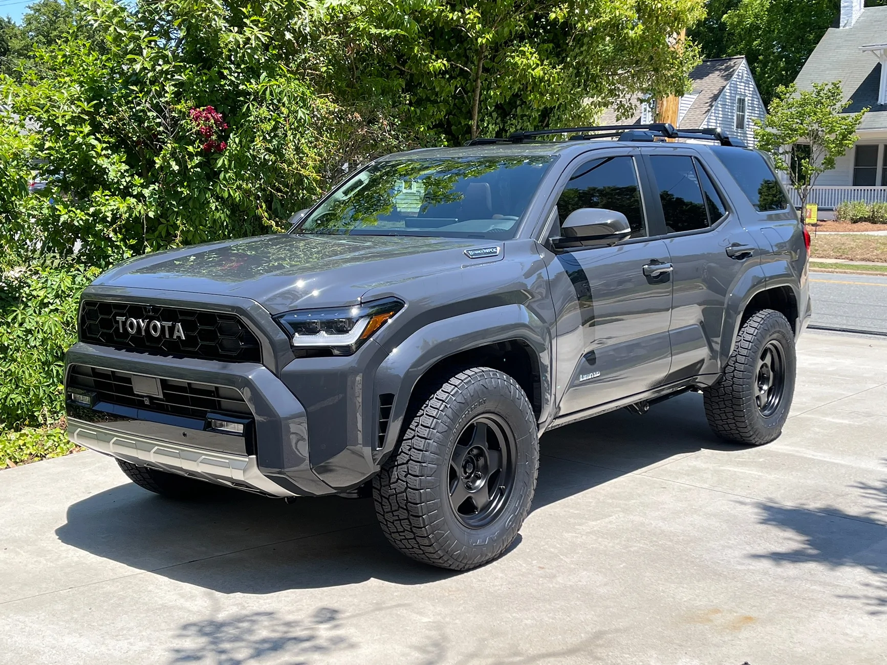

Here are some pictures, just got them on but initial impression is they’re awesome … love at first sight. Very quiet tires, no noticeable difference from the stocks.
I think it will look better leveled,
Specs:
Wheels - SCS F5 17x8.5” +20 offset 21.5 lbs
Tires - Nitto Terra Grappler 285/70/R17 SL 48 lbs
total rolling weight 69.5 lbs vs 75.2 lbs on the stock limited 20’s and Dunlop highway tires.
I’m hopeful to minimize the trade off of increased width, poke, rolling resistance by slightly reduced unsprung weight. But we shall see.
I have a 100 mile highway commute 2x per week so I will have a good idea of MPG impact shortly, will report back.

needs a lift now
Looks nice. What rims did you get? Is Nitto G3 the tire that has an aggressive sidewall on one side and less aggressive on other? Let us know how they perform.
yeah mine have the less aggressive side out. The other side is more like the Wildpeak shark fin pattern.
