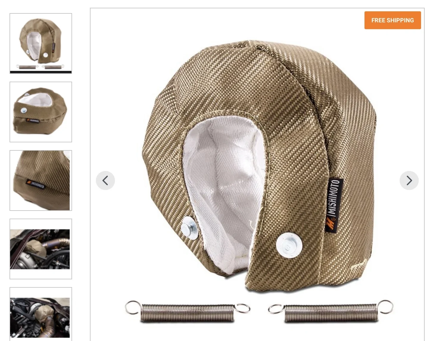

Has anyone installed a turbo blanket in their 4Runner? It should help with turbo spooling while keeping everything else under the hood cooler.

How would it help turbo spool?
A turbo blanket helps turbo spool faster by trapping heat in the turbine housing, making exhaust gases hotter, more expansive, and faster-moving, which spins the turbine wheel more efficiently, creating boost sooner and reducing lag

I have trouble believing that blanket is needed at all.
127.0.0.1
879
765
earf
a bunch of Toyotas
Kiichiro Toyoda is rolling in his grave.
Turbo blankets come with risks.
T24A-FTS turbo I4 is a twin scroll. so....exactly what turbo lag are you trying to rectify ?
Go ahead and wrap that turbo, all for no power gain, and a miniscule improvement in lag
if any improvement at all.
You'll reduce reliability and introduce failure points, you'll need to park and idle 3
minutes after every drive to prevent oil coking, you may end up cracking the housing...
and hopefully your blanket won't catch fire if it gets even slightly contaminated.

Save your $$$.
Twin scroll and not a performance racing Turbo.

I don’t think I want to trap yet more heat into the turbo
More of the same:
Yes, a turbo blanket can potentially help with turbo spooling while keeping everything else under the hood cooler. A lot of people use turbo blankets with no issues, useless there is an oil leak! In which case there is a fire hazard. However, the improvements are very small and generally only realized if you are on the track and seeking a ~0.01 sec. improvement.
Things to consider before putting a turbo blanket on a 2025-26 4Runner:
  • If a turbo gets too hot without proper cooling, it may experience reduced lifespan.
  • In general, a turbo raises the temperature between 10-20 degrees F per PSI boost. So, a 4Runner running a maximum boost of ~20 psi x 15 degrees = 300 F.
  • The hotter the air leaving the turbo, the ā€˜harder’ the intercooler must work. The 4Runner has an air-to-air intercooler, while reliable, not the best at cooling. In fact, the air-to-air intercooler does nothing unless the vehicle is moving. Hotter air after the intercooler results in lower performance.
  • A hot turbo can be especially ā€˜hard’ on the oil when the truck is shut off. The blanket holds the heat for a much, much longer time.
  • If the turbo fails, I’m certain there would be a question if a warranty claim is involved.
  • So, is the real gain worth the possible issues?
There's no right answer, each of us has to determine how far we want to "pay to play".
