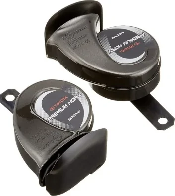

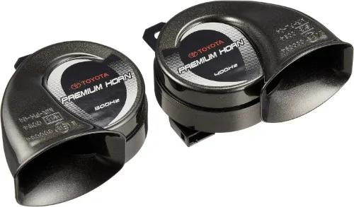

Stickerfab sells two versions. One does not have the "sound diverter." They don't explain what that means, if it sounds different, or why the one without the diverter is less money. Anybody know the difference in sound?
https://www.stickerfab.com/products...s-2024-land-cruiser-gx550?keyword=toyota+horn
https://www.stickerfab.com/products...ser-prado-trj150w-grj150w-grj151w-08522-60020
Some websites are confusing the two horn types and their part numbers 08522–60010 & 08522-60020
Look closely at the pics in your first link. Diverters.
I missed that difference - thanks. I still don't know when or why I would want one vs. the other. It seems like the diverters would keep more of the sound under the hood vs. directing down to the ground.
