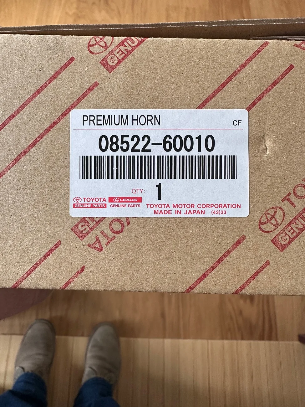

Are these genuine Toyota parts, just not available domestically through stealerships?
Box says "Toyota Genuine Parts".

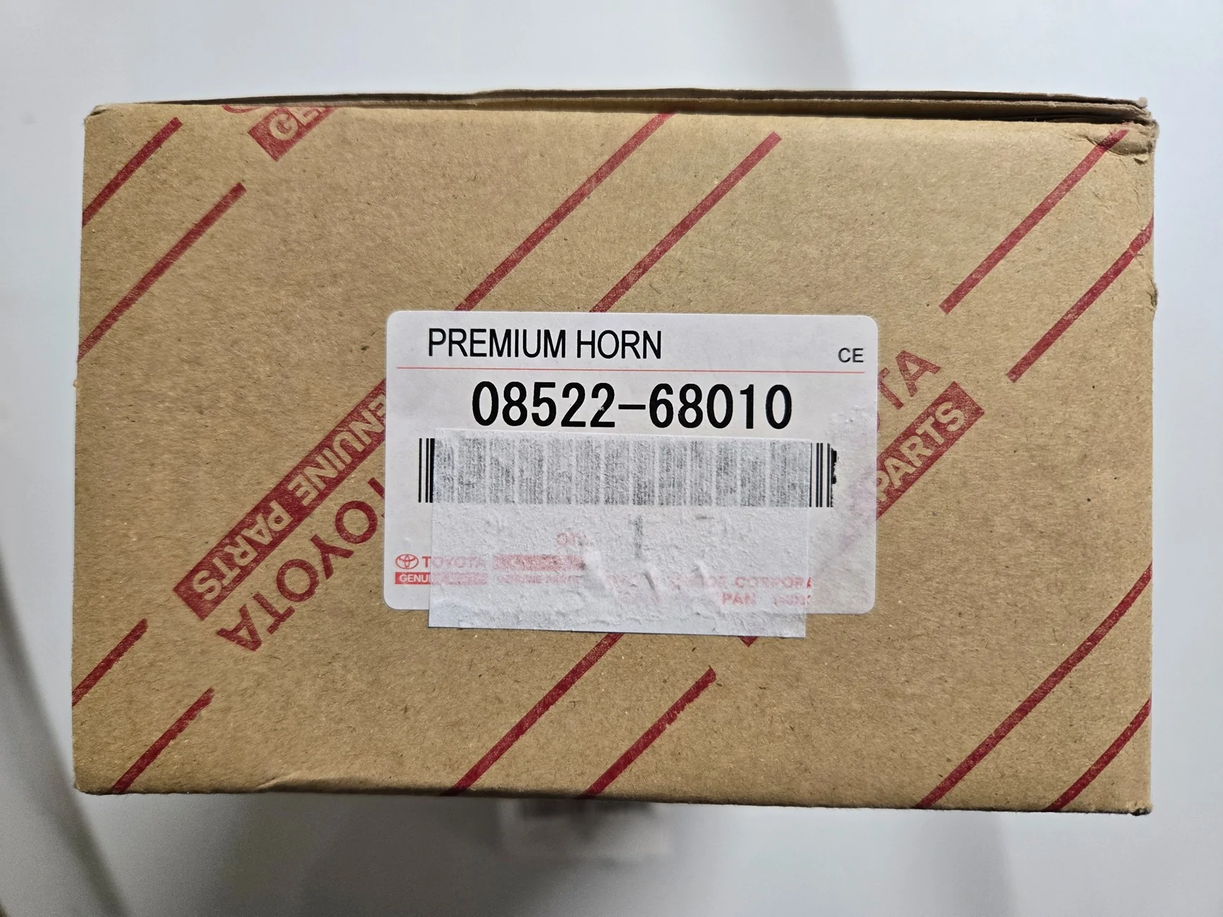

My 08522-68010 horns do NOT have diverters.
2025 2026 4runner 6th gen Toyota "Premium Horn" install with before / after sound clip videos Horn Box 2

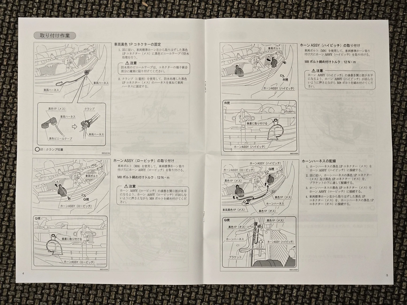

Easy to read instructions INCLUDED !! 🤣
2025 2026 4runner 6th gen Toyota "Premium Horn" install with before / after sound clip videos Horn Instructions 1
2025 2026 4runner 6th gen Toyota "Premium Horn" install with before / after sound clip videos Horn Instructions 2

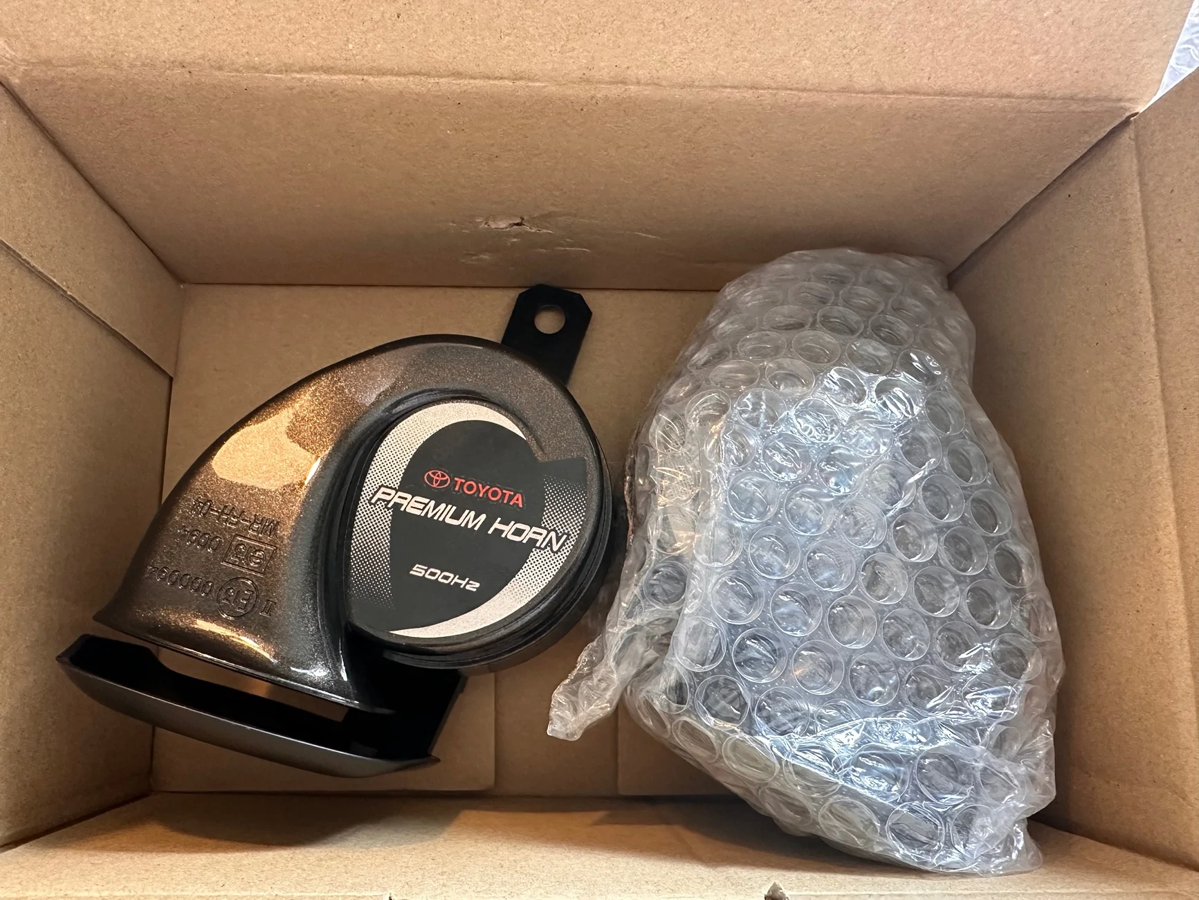

Is the diverter that everyone is talking about that shield looking thing in some of the pics. Looks like the original poster had those and his horn sounded pretty good so maybe okay either way.

Wonder does the diverter just push the sound out and away from the vehicle, i.e., towards the person you are honking at. Versus non just pushes the sound straight down to the ground?

Is it one part number for both left and right horns?

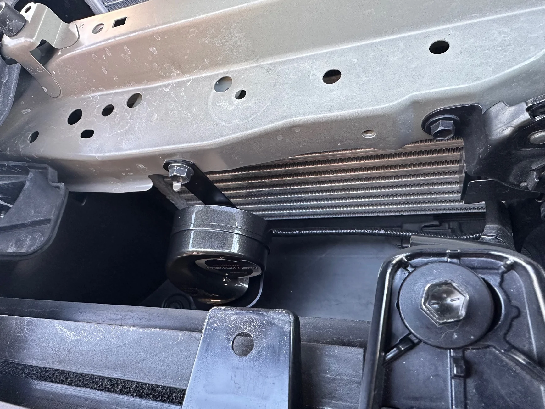

Install done. Took 10 mins or less.
here’s a good install video and some photos I took and a video for sound.

Based on the Amazon specs, the ones with the diverter are 105 decibels and the ones without are 110 decibels. Not sure I trust Amazon specs though.

Mine had the diverter. Honestly, such an improvement over the OEM horn, the difference in decibels between diverter and no diverter is irrelevant. Would not have known about this horn option but for the 4Runner6G site!
