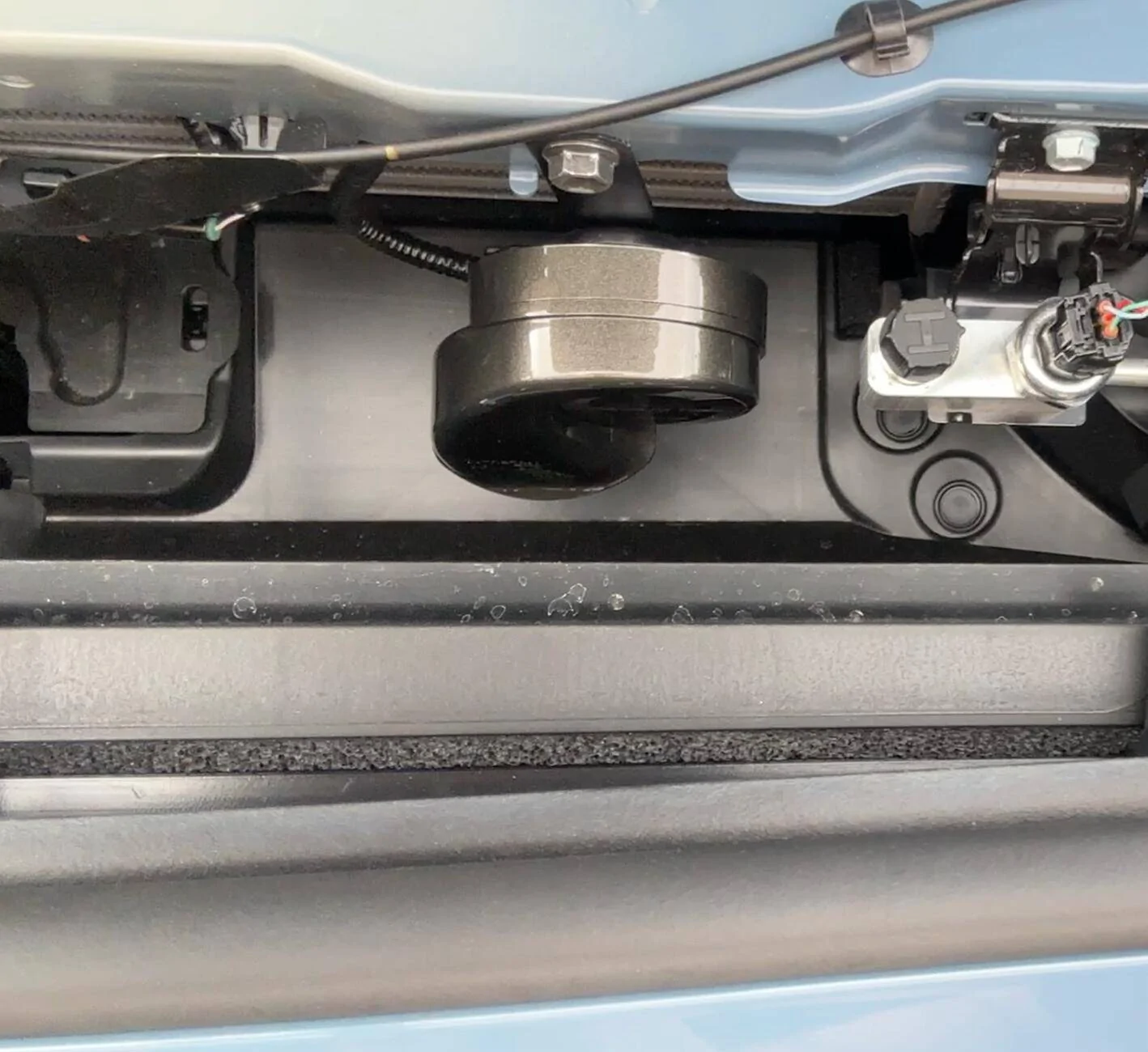

All, if you are considering on mod for your new truck, it has to be a horn upgrade. The easiest way is to use Toyota part number "Premium Horn 08522-60010." This part is available via site sponsor Stickerfab When I say easy, I mean 10 minutes, a 12mm wrench, and no wire cutting.
Listen to the stock horn and then the upgrade.
The hardest part is getting those little clips back in, but once you get the hang of it, it is super easy :cool:
2025 4runner 6th gen Toyota "Premium Horn" install with before / after sound clip videos horns

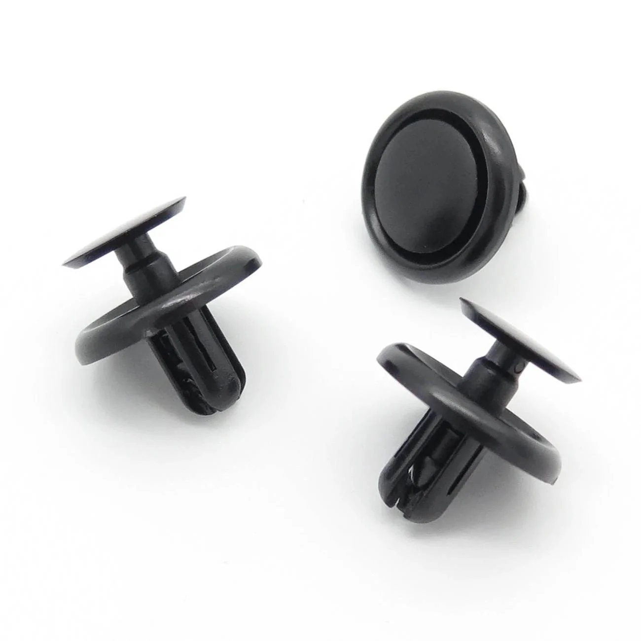

I didn't buy mine from Stickerfab (they were backordered, so I went elsewhere) but the instructions were in the box, but I didn't need them (I had also done this on my Land Cruiser ((RIP)) but I didn't need the instructions then, either). It goes like this:
1) Push in the little circle clips holding the radiator shroud on
2) Gently lift the shroud up (go slow or you'll lose the clips, ask me how I know)
3) Unbolt each existing horn (one 12mm bolt each)
4) Undo the wire clip, there is a small notch, I used a small screwdriver to push it down and pulled it out.
5) Install is of the new horns is the reverse of the above.
Like I mentioned above, the trickiest part is redoing to trim clips. Here is how I do it.
Push the middle part up (see attached picture) and then squeeze the outer part to fit back in the hole. Gently push the top back in, so it sits flush, but don't push it too far, or it will unclip again. Once you get the hang of it, you'll make sense of it. I promise, it's easy.
If anyone does need to directions I'm happy to make a copy and post them here, just let me know.

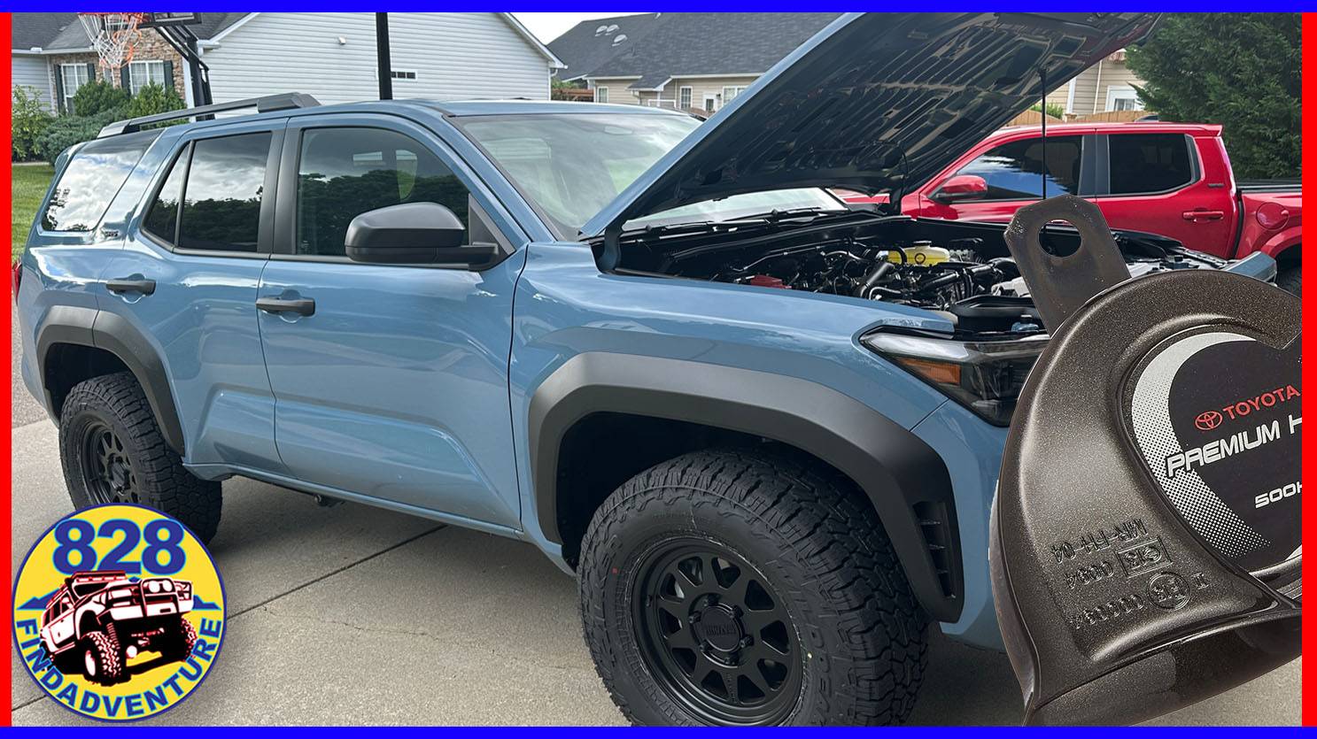

Just installed mine yesterday. Best protection for your 4Runner. Install video and new push pin style demo will be uploaded June 7th at 6 am eastern time.
2025 4runner 6th gen Toyota "Premium Horn" install with before / after sound clip videos Toyota premium horn
2025 4runner 6th gen Toyota "Premium Horn" install with before / after sound clip videos Screenshot 2025-05-31 at 1.01.55 PM
