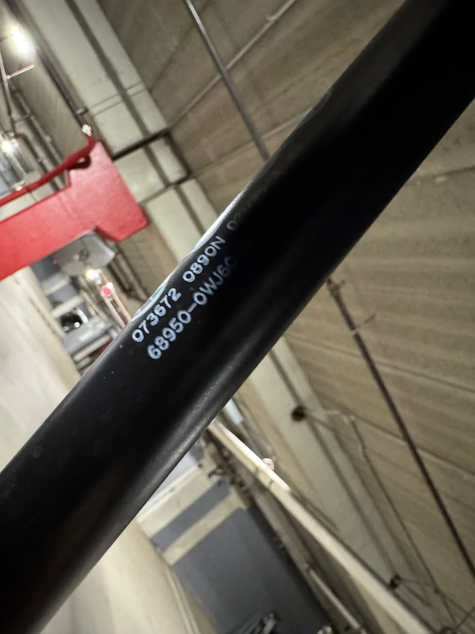

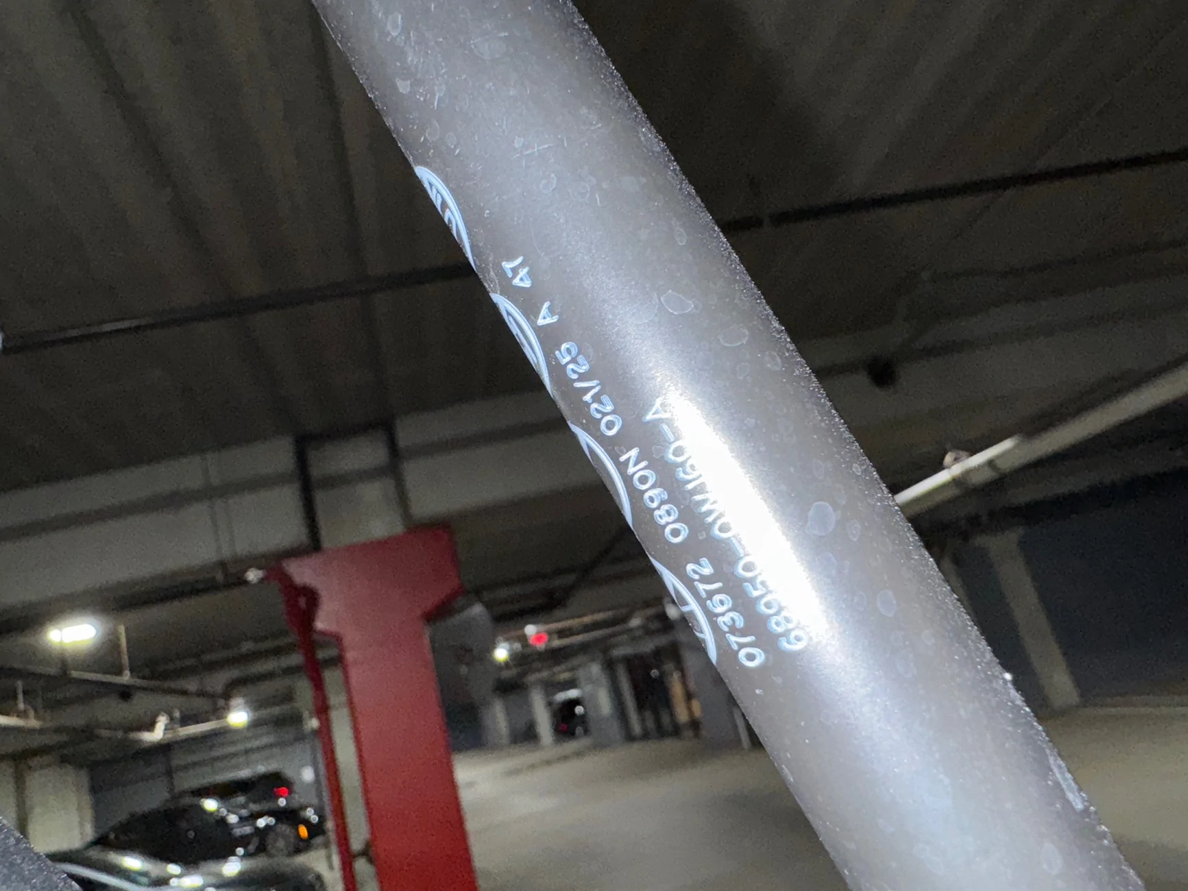

Has anyone found struts to replace the stock after installing a ladder on the back hatch on a 6th gen?

I tried looking up the code on the OEM struts on gasspringshop.com but had no luck. I did learn thogh the oem struts are rated 890N or 200 lbs
