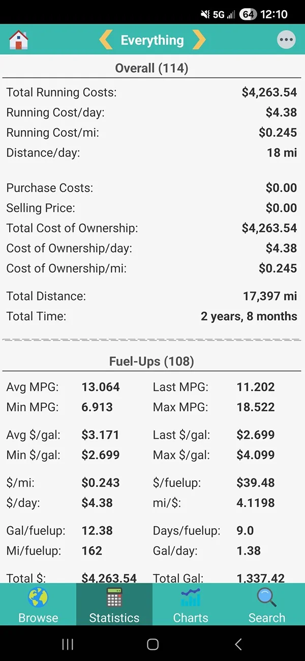

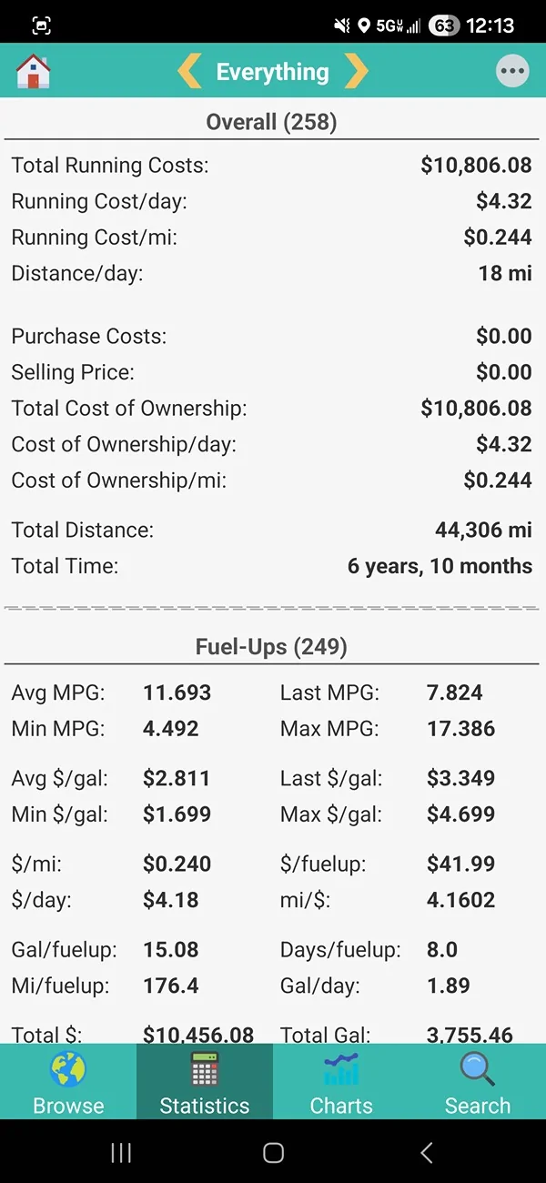

oh and by the way here are the stats on our 23 tundra platinum non HV with the twin turbo 3.4L engine running 87 with eth (also ran 87 with eth on our 2018 tundra platium)
granted this is mostly city driving 95%
our lifetime avg so far on the 23 tundra is 13 mpg, 1.5 mpg better than our 2018 with 249 fill ups over roughly 5 yrs (ignore the total time, since its still counting even though its a retired vehicle)
