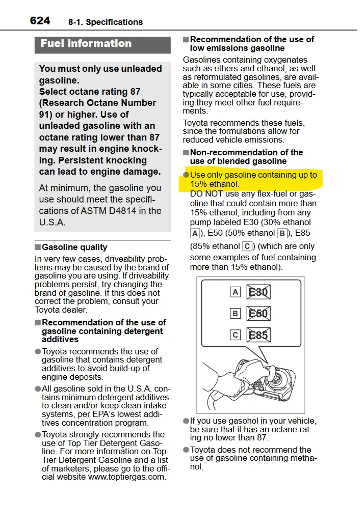

What about Regular 88 at places like Sheetz where its ethanol is at 15%. Per the manual, this should be okay?... Higher Octane but also higher ethanol content... however significantly cheaper than Regular 87.
What do you think?

i thought the manual said 10% ?
its 15% but personally i wouldn't go past 10%
and the price difference between 87 and 89 is not that much to stay within 10%
but 88% that is a weird not seldom seen rating

Looks like it says up to 15%. Page 624 in the manual
