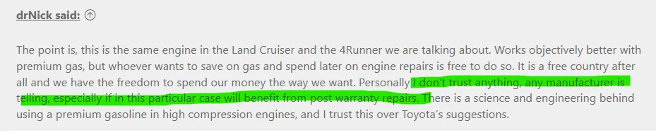

This isnt a conspiracy. It is a known marketing ploy. The average buyer doesnt want to use premium. Requiring premium turns buyers away. The LC engine is the exact same engine. LC and Lexus buyers are "upmarket" and are not turned away by the premium requirement.

Normally I’d feel that way too, but they can’t even sort out squealing brakes lately so……

The compression ratio is the same. They are exactly the same engine. I am not saying there will be catastrophic issues from using regular vs premium. Oil changes matter more.
Toyota knows what they are doing. Requiring premium would be worse on sales than a 4runner getting 200k miles vs 250k miles. Especially considering the vast majority of people dont keep new vehicles that long and generally people who purchase used vehicles are the ones who care more. Toyota doesnt sell used vehicles.
