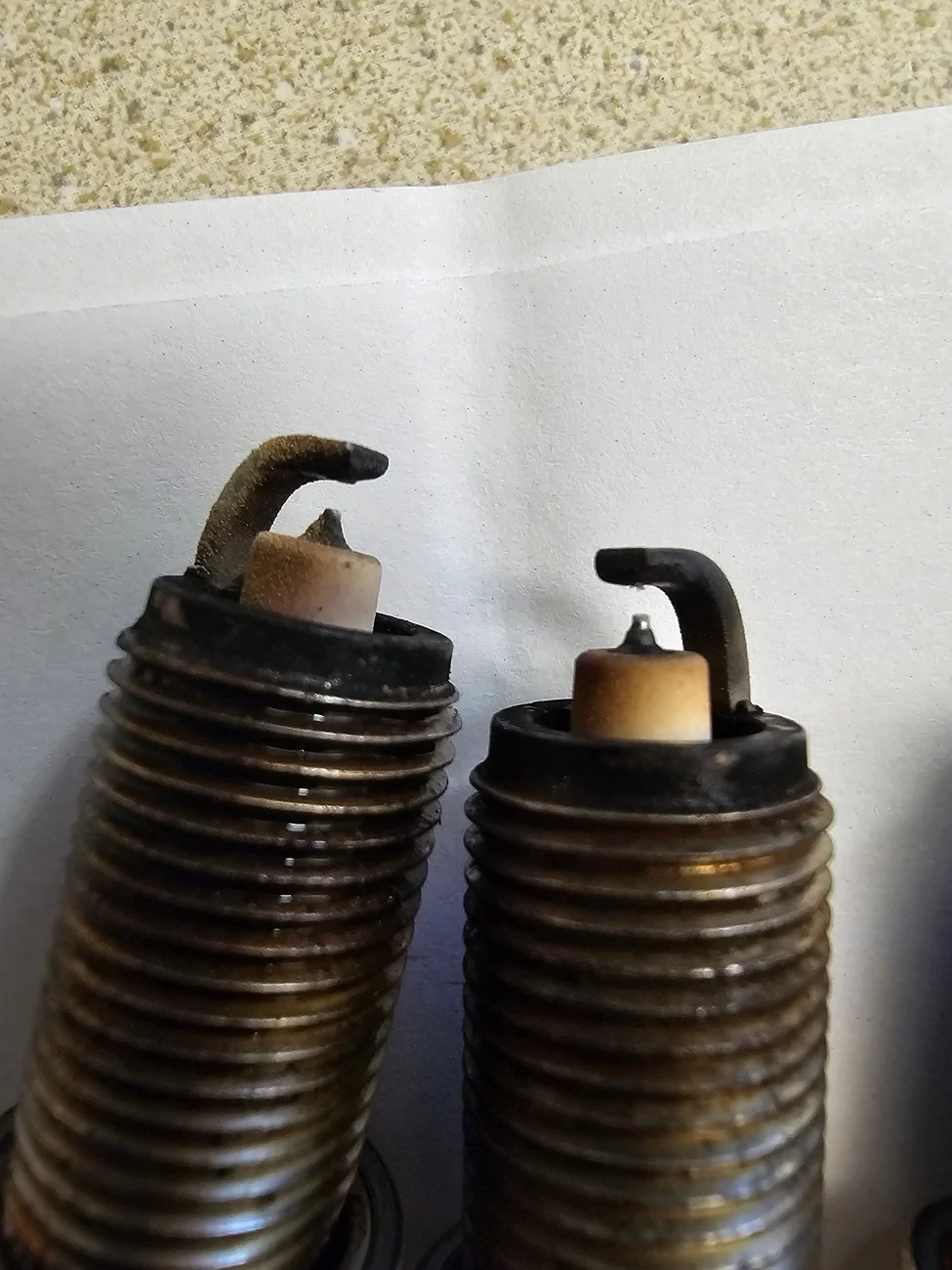

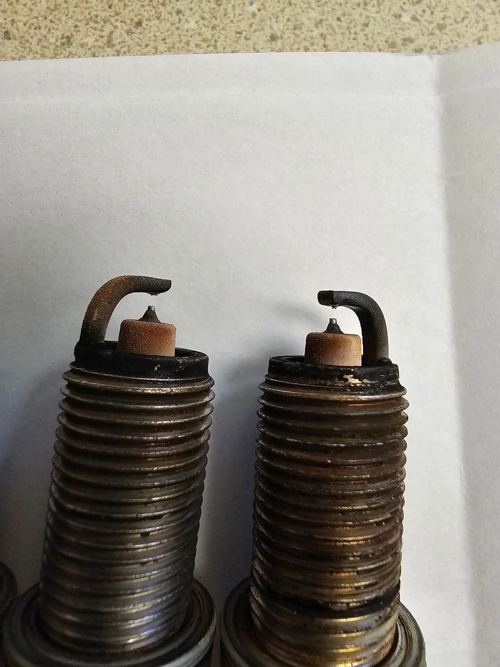

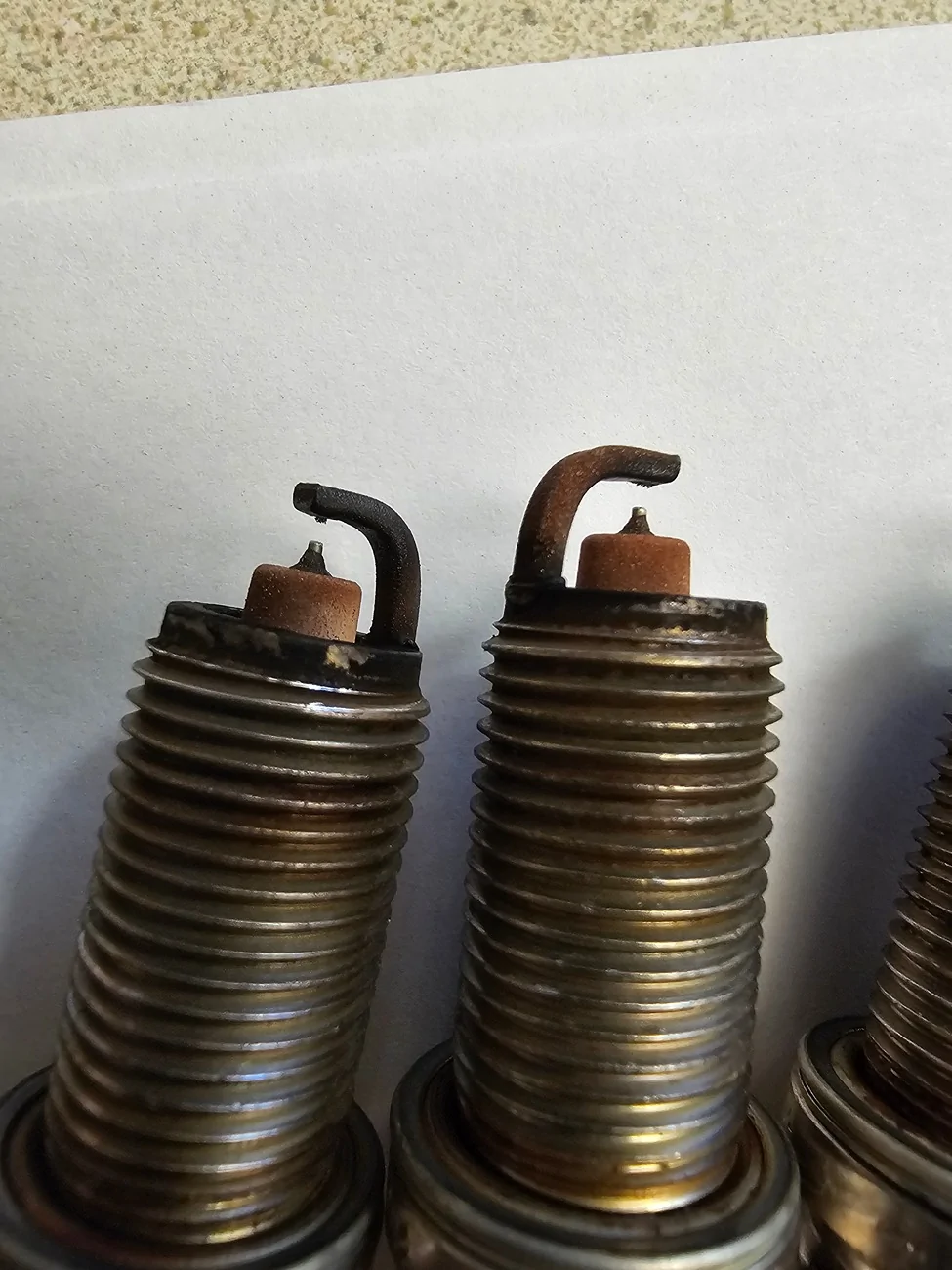

oil changes (5k max and 3k for those die hards) and spark plug replacement. the owner manual states 40k spark plug replacements if i remember correctly for the new turbo engines. my 2014 n/a engine i went like 106k on the oem spark plugs and i could have gone longer when i had them pulled.
also to add, that was 106k of 87 octane with ethanol
