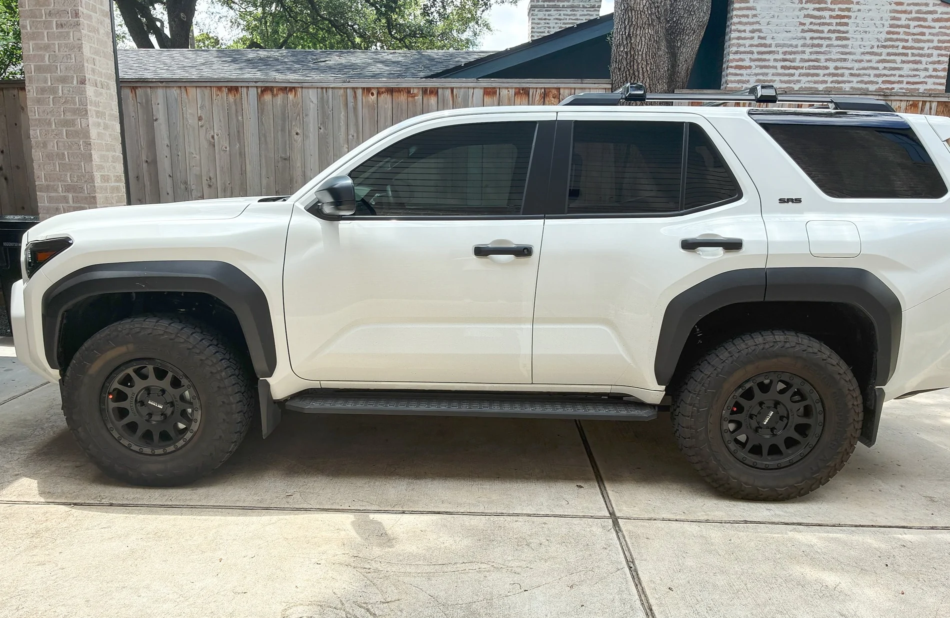

I just had my Bilstein 5100s (font and rear) put on as well. The rear is stock height and I went with the 1.1" lift on the front. I'm still seeing about a 0.5" to 0.7" difference between front and rear, so you are probably safe to go to the 1.6" setting on the fronts if you want very close to level with stock rears. I wanted to leave some rake and was afraid of going nose high, so opted for the lower 1.1" setting (position #3).
Tires are 285/70/17 on Method 305 17x8.5 +25 offset.
@romik- curious why they left your caster alignment in the red? Was it not possible to bring it back to green with the 2.2" of lift?

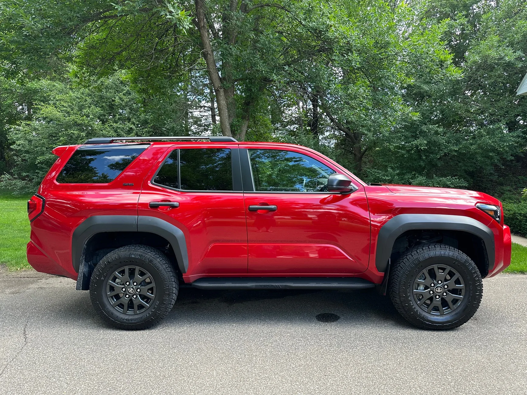

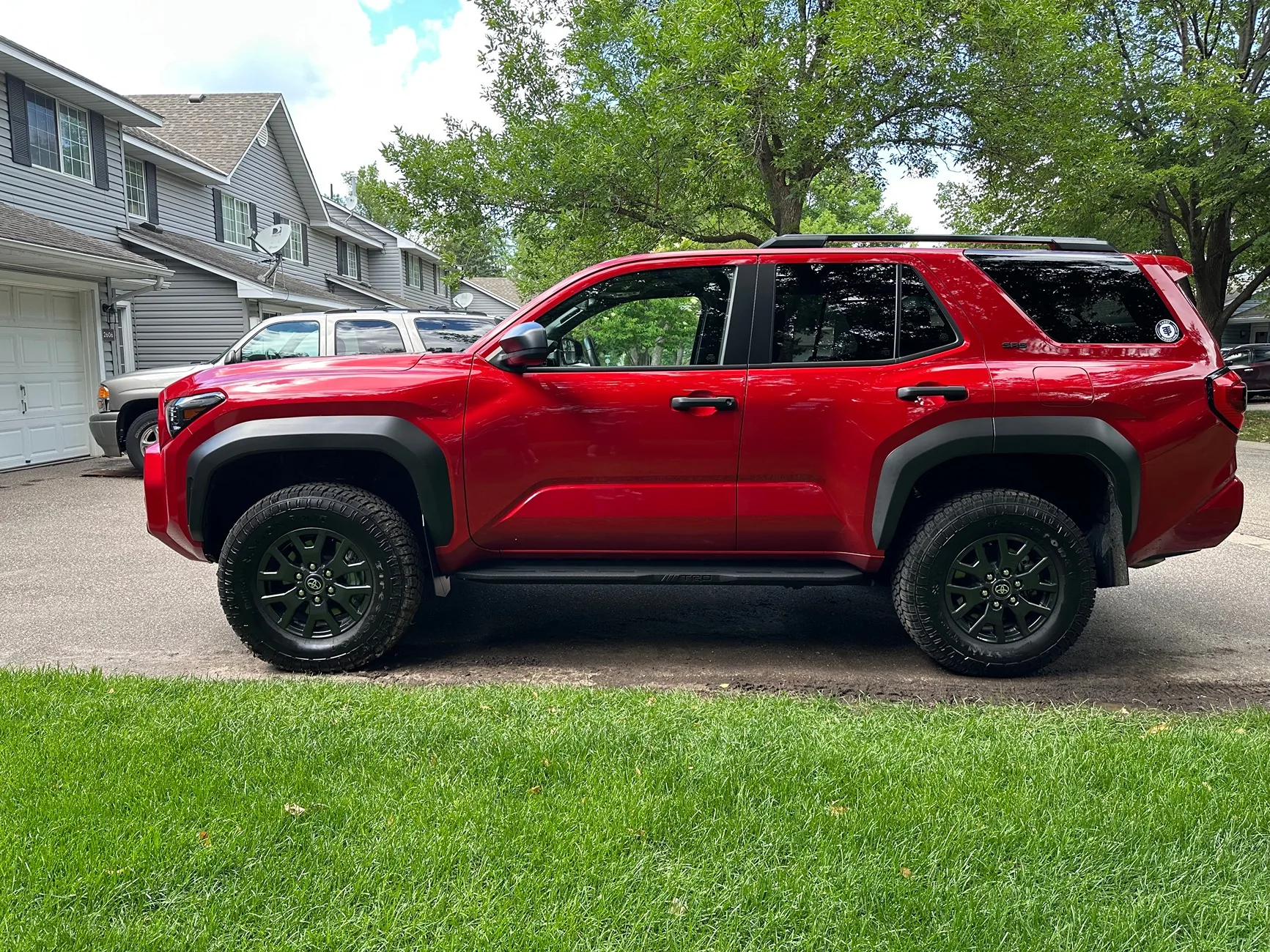

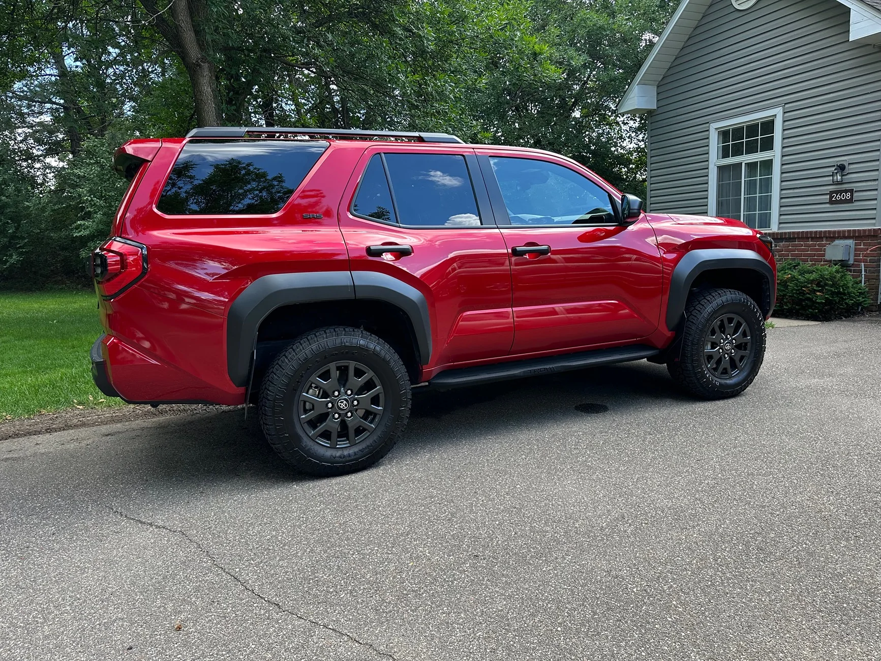

I had mine installed yesterday. I decided to go with position 5 (2.2 in), and a .75 poly spacer on the rear coils. It is very close to level, and I am very happy with the results. If I was to do it again I might opt for a 1" spacer to give a little more rake, but it's not worth messing with right now.
Tires are 255/75r17 Firestone Destination XT, and I am very pleased with them too. C load, and only 41 pounds per tire.

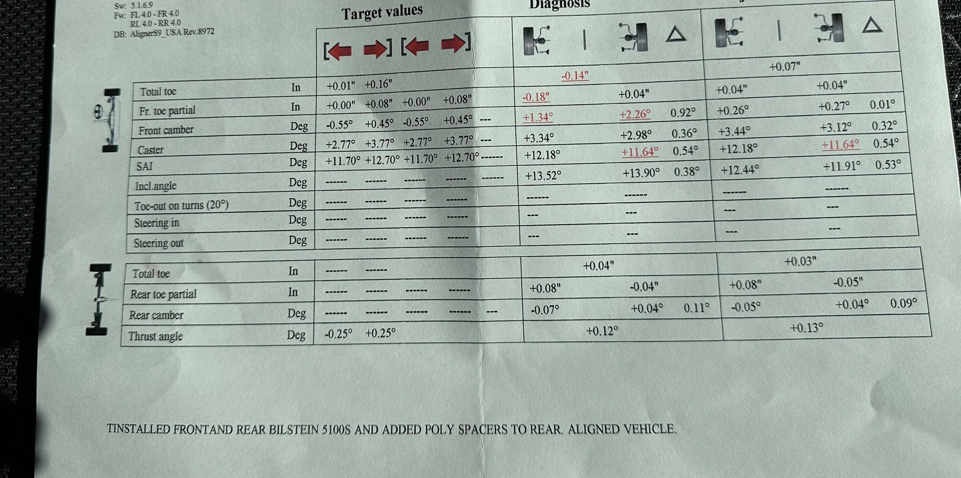

And my alignment specs, in keeping with the OPs intent for the thread. Drives and tracks fine, steering feels a little lighter, but not loose or wandering.

Thanks for sharing your specs.
