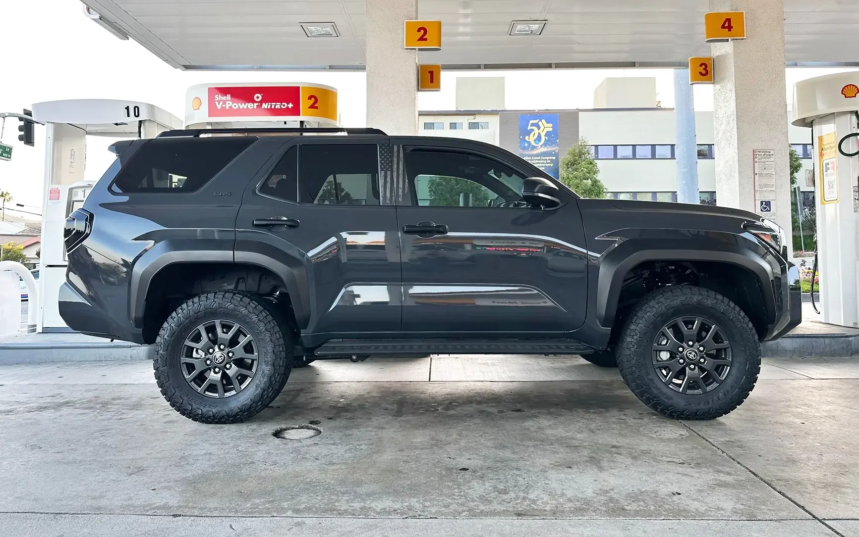

Hey everyone, just wanted to share my truck! Upgraded to Bilstein 5100 front and rear shocks, and I’m really happy with the height and the ride.

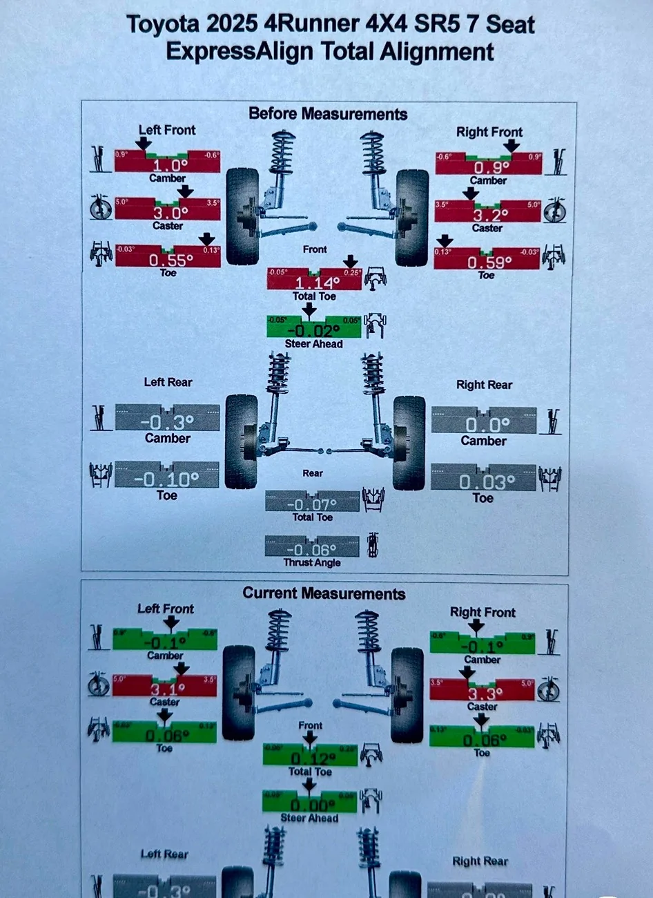

Feel free to chime in on the alignment numbers if you know your stuff.
2025 2026 4runner 6th gen SR5 Suspension Lift: Bilstein 5100 35118-44b76f4a522fb51b47044e4a2e586943
2025 2026 4runner 6th gen SR5 Suspension Lift: Bilstein 5100 Alignment Specs

which bilstein shocks? did you leave the springs the same ? How is the ride compared to OEM ?

5100 dedicated for 6Gen. Stock springs.
I would say its a bit firmer, more controlled, less body roll for sure which i love it, less nose dive under breaking, and the most important thing in my opinion you get more droop travel compared to any preloaded collar lift, less bouncy and more truck like ride... Very satisfied overall.

Great lift height and leveling amount! What size are your tires?

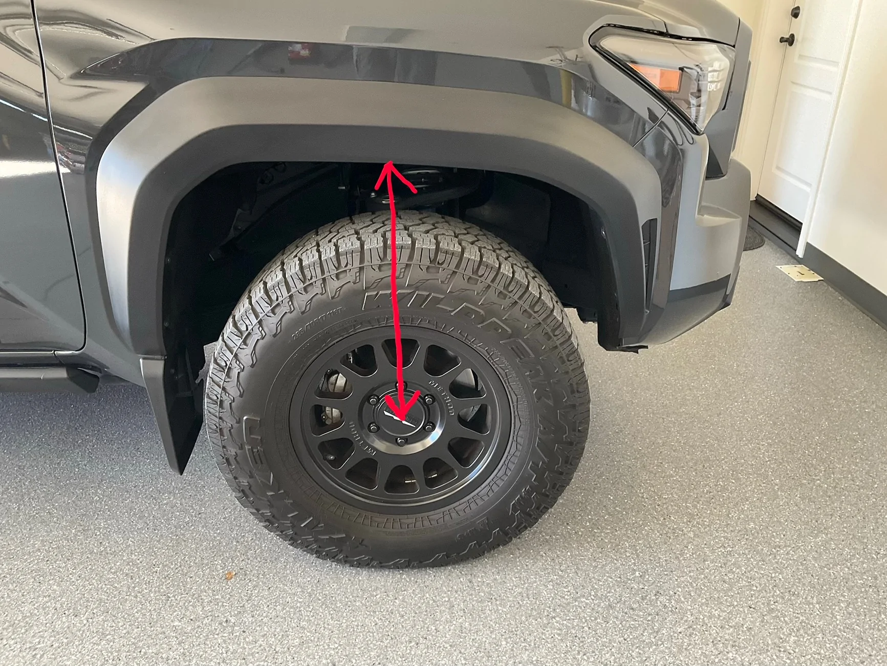

Mine are being installed on June 5th, can you please measure from the center of the wheel hub to the bottom of the fender flare so I can see what actual lift you got, thanks!

Center cap wouldn’t be very accurate, so I went with the lower cap/point since I can hook the measuring tape there. It’s 24 1/8 inches.
