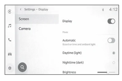

I believe the infotainment uses the headlight sensor to determine if its dark out (I see mine change as headlights come on). Have you turned off "automatic based on Ambient light"?
That automatic setting only switches it between light/dark mode, and I already have it set to Nighttime/dark mode. That doesn't seem to actually affect the dimming behavior.

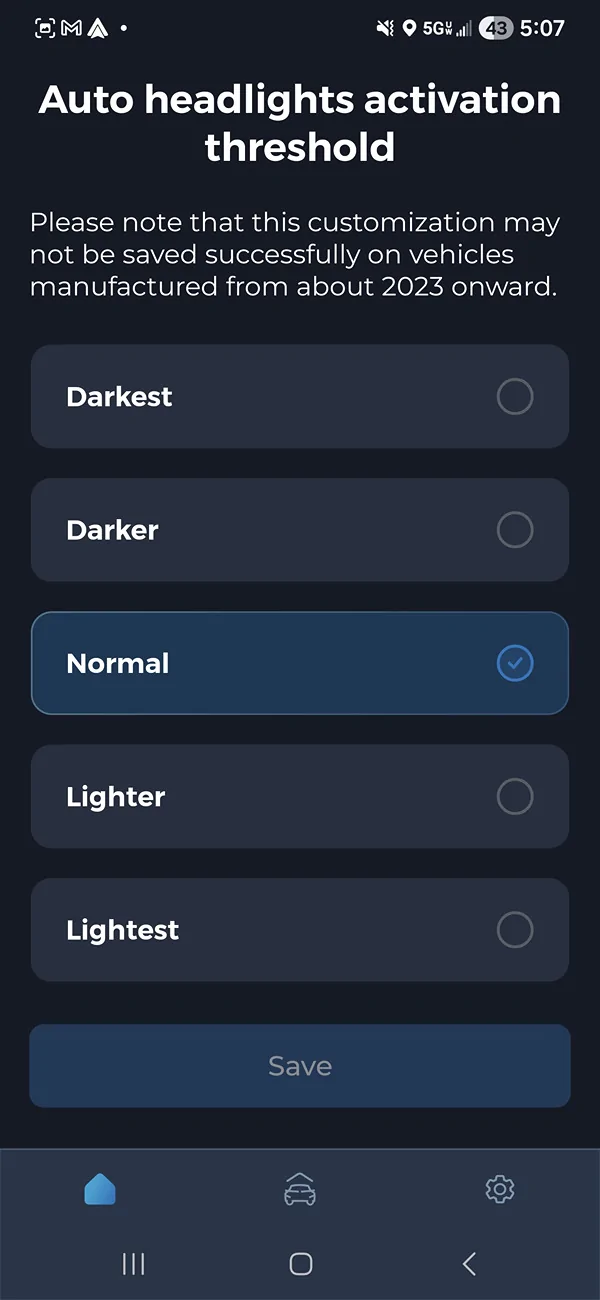

i think the trigger point is tied to the headlights turn on, but not sure. if you have carista you could try this screen ...
2025 4runner 6th gen Screens constantly flip between day and night brightness levels at dusk 1761606960032-15
