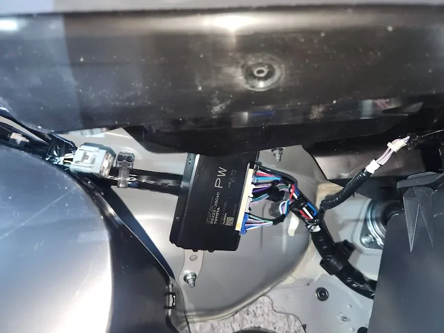

BTW - the "tray" at the top of that section looks like its the same part on both Hybrid and non-hybrid. You can pop that off (like I did) and see if the power connector is down there somewhere. I believe the power connector for the compressor is that empty white connector to the left side of the photo I posted and above the thick black cable that is tied to the body, and left of the "PW" box. If you have that you might be able to make this work. Again, good luck.

My curiosity is sparked what is that black box that says PW on it? Thanks in advance

does that say "AISIN" just above the QR code ???
if that does, then thats related to the transmission since they make most of the trans for toyota

Rear Tailgate Multiplex Network Module ?
That seems close. Searching the part number was inconclusive, but a google image search resulted in this:
"This item is a Toyota Multiplex Network Body Control Module, specifically a tailgate control module.
  • Part Number: 89222-35040
  • Manufacturer: Aisin
  • Function: Manages network communication for vehicle doors and tailgate operations.
  • Compatibility: Used in various Toyota and Lexus vehicles, such as the RAV4 and Lexus RX.
A separate search AI indicated that it is related to the Tow control and that also seems likely based on the fact that I do have the Tow Tech package option and this same part might have some functions related to Tow control. That thick black cable might even contain the backup camera video line. I'd be curious if this same module and all the same cabling exists in vehicles without the Tow Tech package - if so I might be able to unload my digital rear view mirror (replaced with Wolbox) on someone who doesn't have it and is interested....
