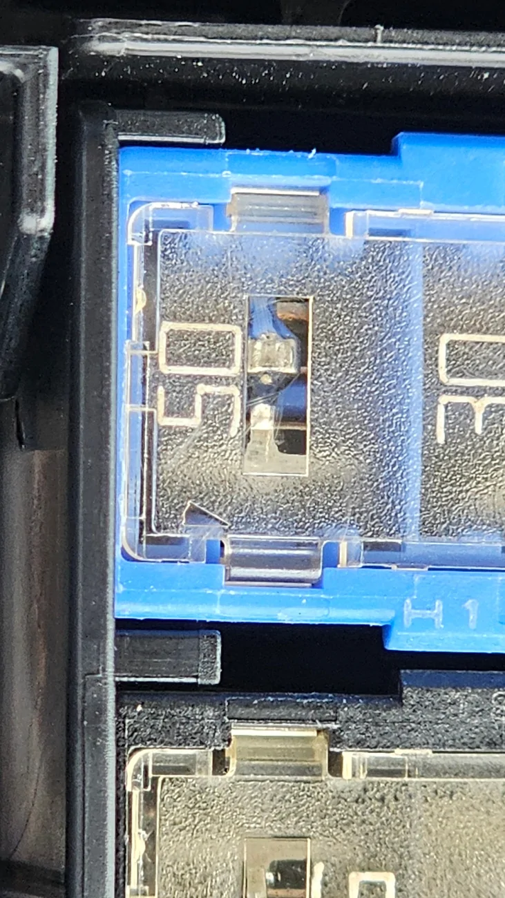

That being said, I have no power coming out of the connector to the compressor module. The module fuse is good, the 50amp looks good. I know my multimeter works as I tested it in the 120VAC outlet and tested on my 12V battery, which read 13.99V.
Any ideas what might be going on here? Also, this 50amp fuse is not a fuse I'm used to seeing. How do I get it out?

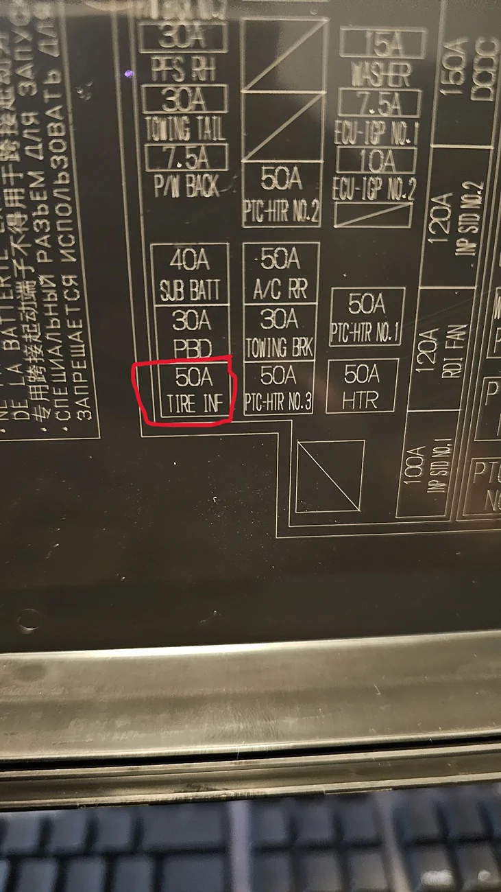

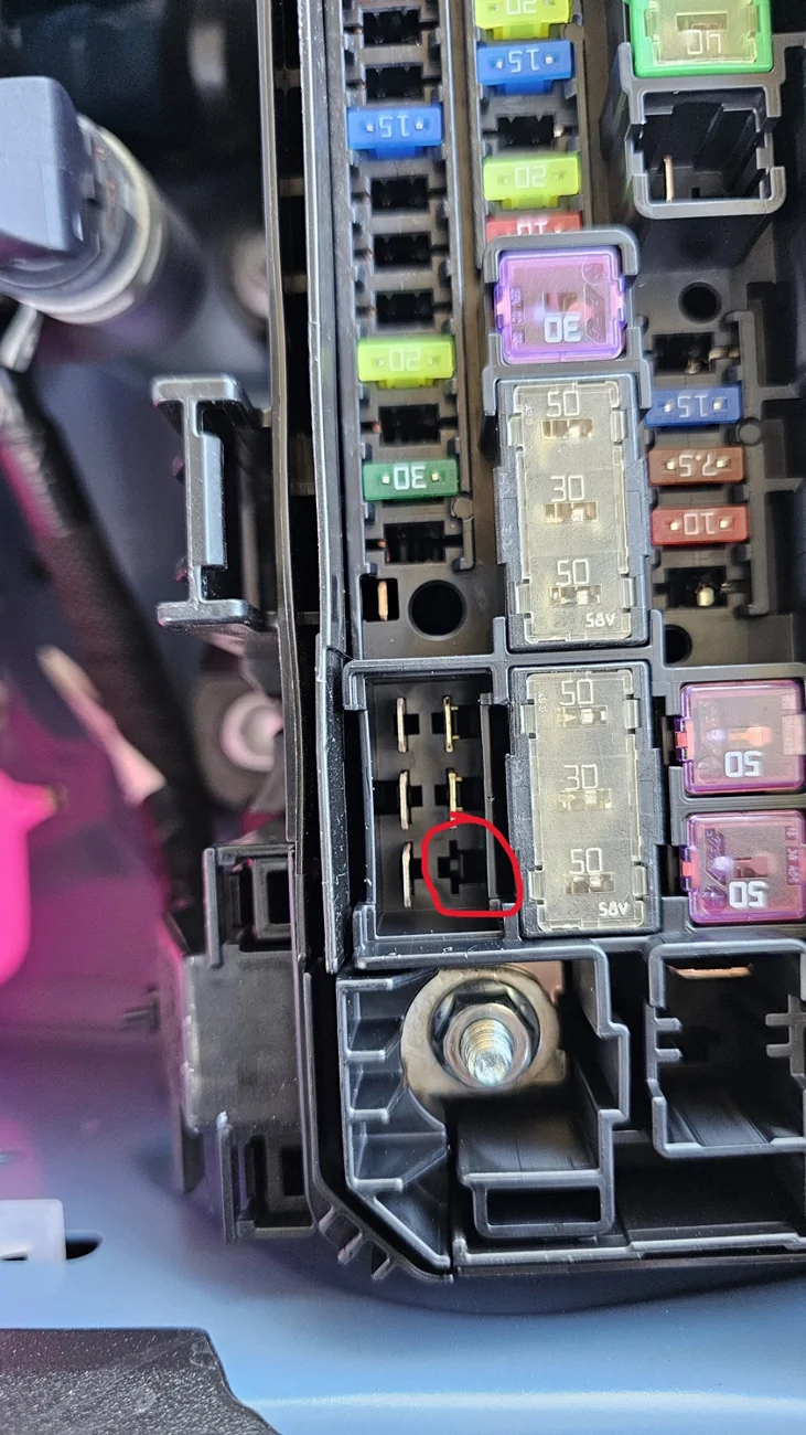

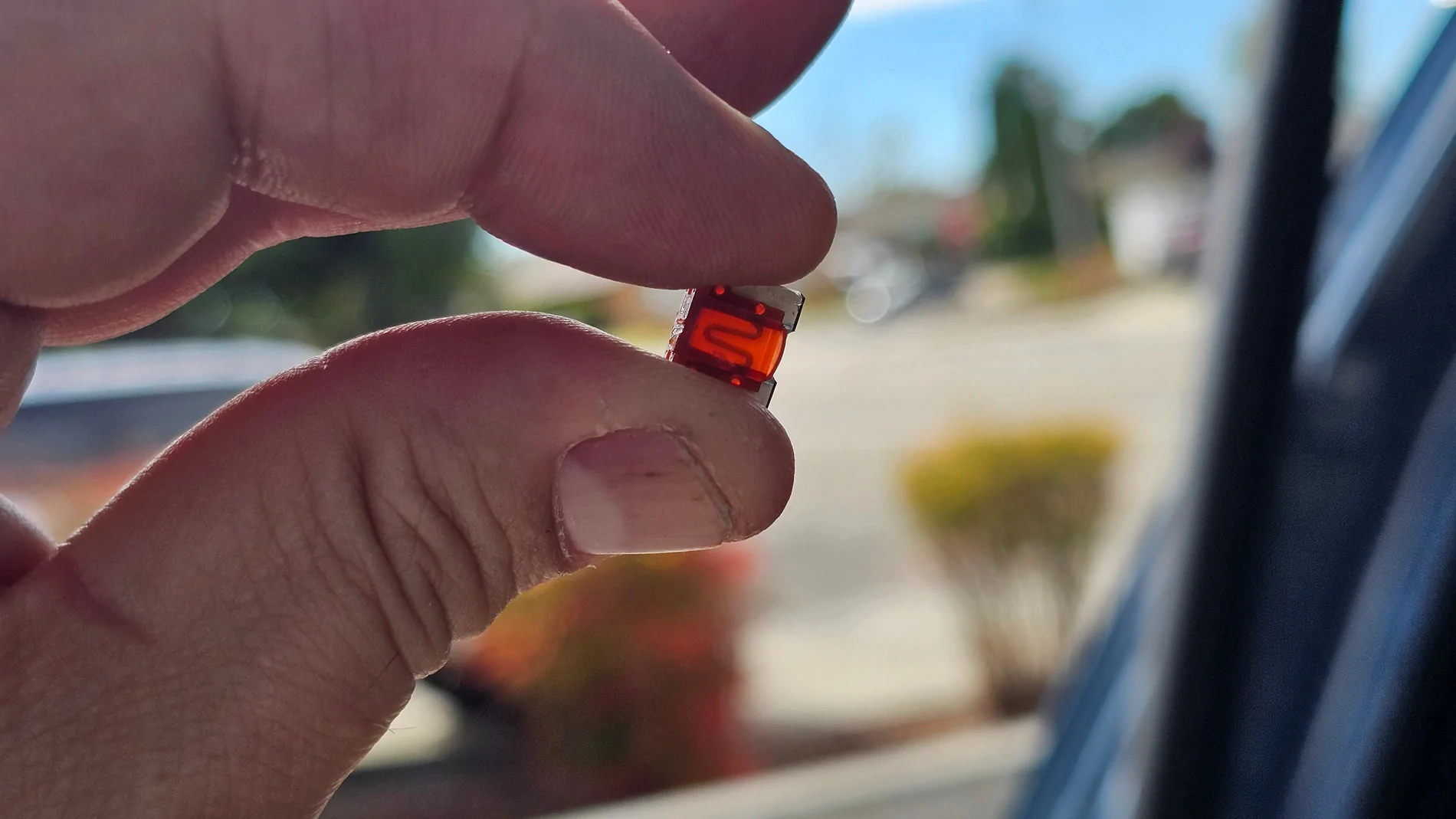

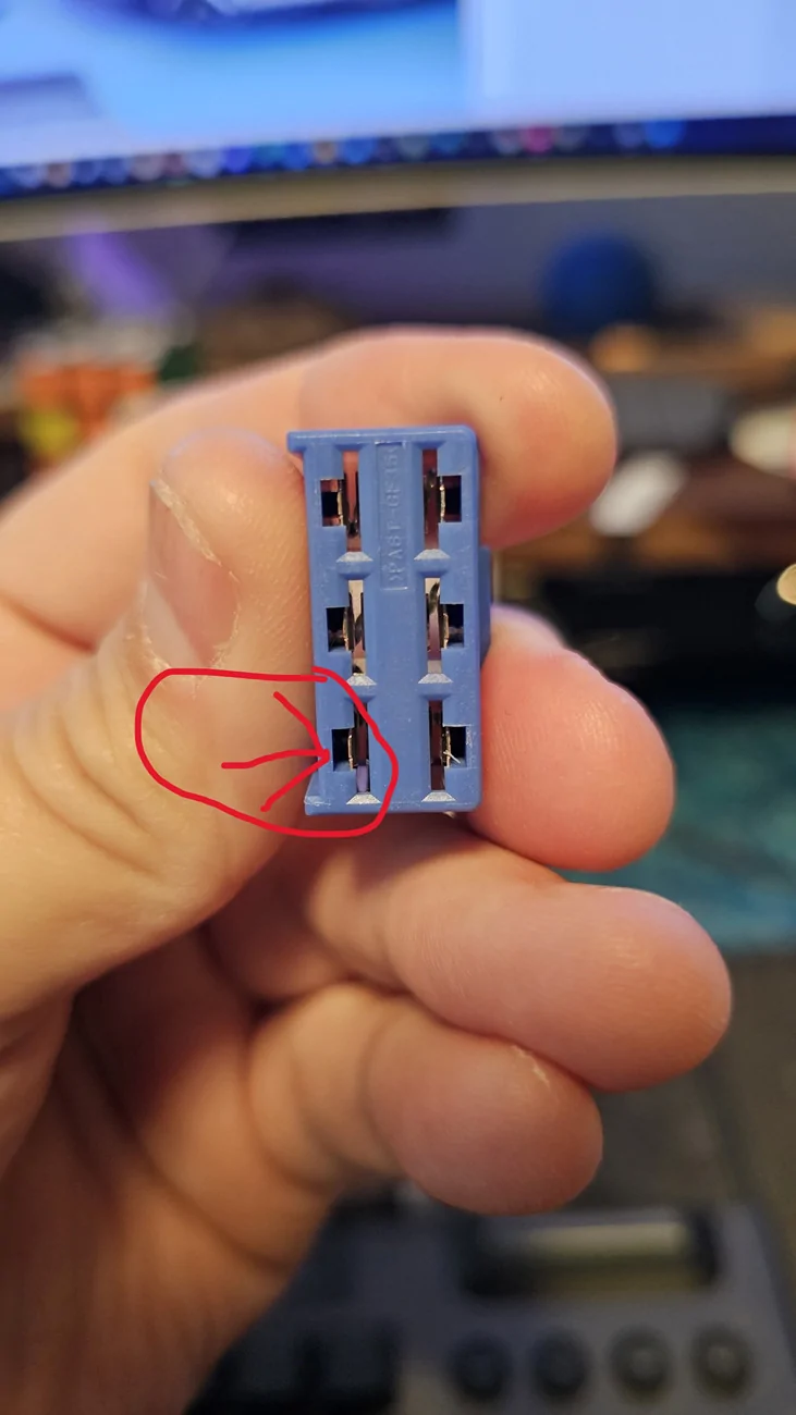

Holy shit! I think I found the problem. There is aan entire connector missing from one side of the 50amp fuse. The fuse is intact and working (I tested continuity). Check out this pic from the fuse box.

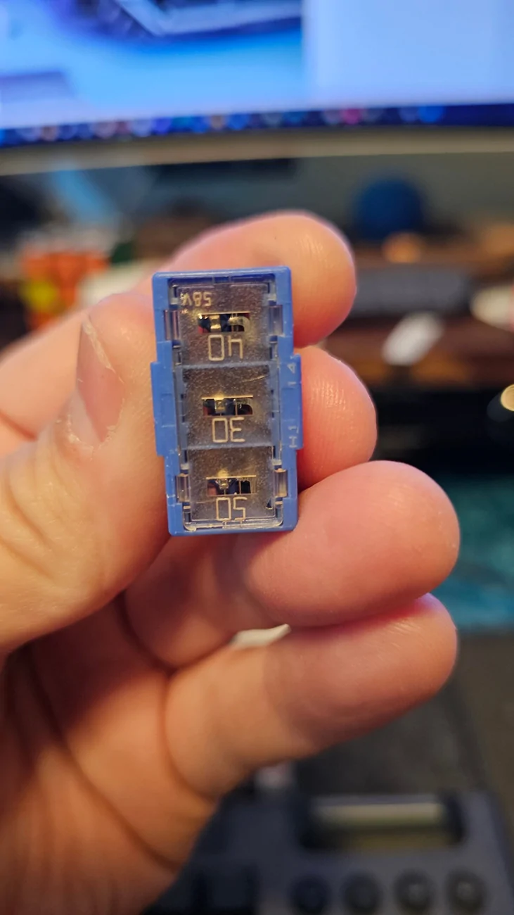

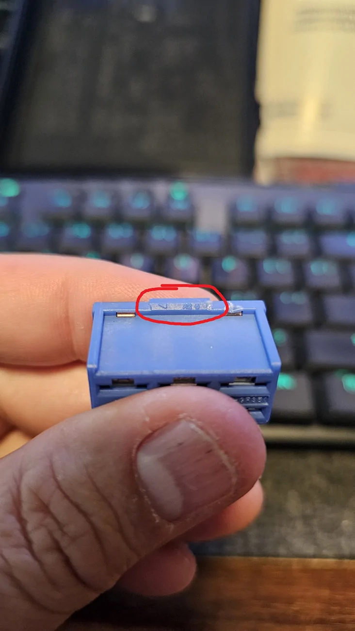

Just in case there is any doubt this is the fuse, here are more pics.
2025 2026 4runner 6th gen OEM Onboard Air Compressor (Tire Inflator) install complete using how-to DIY 1788720882184-vj
2025 2026 4runner 6th gen OEM Onboard Air Compressor (Tire Inflator) install complete using how-to DIY 20260906_115159[1]
2025 2026 4runner 6th gen OEM Onboard Air Compressor (Tire Inflator) install complete using how-to DIY 20260906_115242[1]
PdlMnk
Jul 19, 2026
94
6G4R - TRD ORP Premium Hybrid
Probably a tall order, but if anyone is willing to check to see if they have the blade on both side of the 50amp fuse, I would be grateful. Better yet, you installed the air compressor and it works and you check to see if the blade is there.
As an FYI, pulling the fuse is a slight pain. If you don't havve the right tool, I used 2 hooks to pull each side under the blude ridge in the middle of the 3 fuses. Here's a pic of where the ridge is on both sides of the fuse.

It looks like you found the problem. I think your going to have to find a way to wire it to power with your own fuse like they did with the SR5

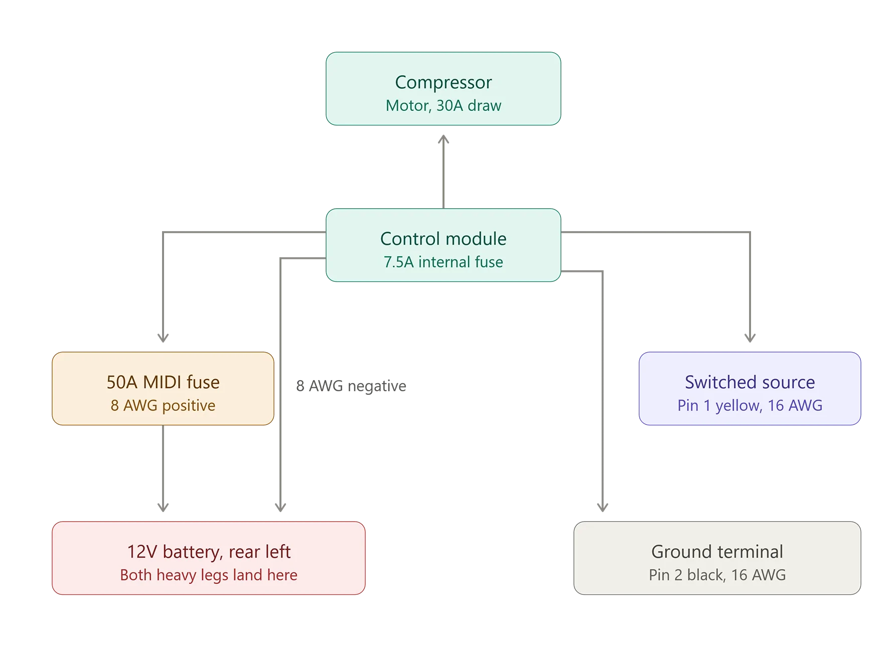

I am still stuck on one thing, I need to run the ignition wire so that the module knows the power is on. What do I tapo into back there? The battery is in the rear, so it should be an easy run. Below is the diagram I made. If someone could please take a look aadn let me know if you see any flaws in my plan?
Wouldn't that be a warranty issue? It SHOULD be there, right?
mcj_orp
Aug 27, 2026
2026 TRD Off Road Premium iForce MAX
No, because the OEM Air Compressor is not an option for the TRD ORP Hybrid.
Right but as far as I can tell by other people installing it, it should be there, no? It seems defective as it's missing a blade. And the connection is there.
