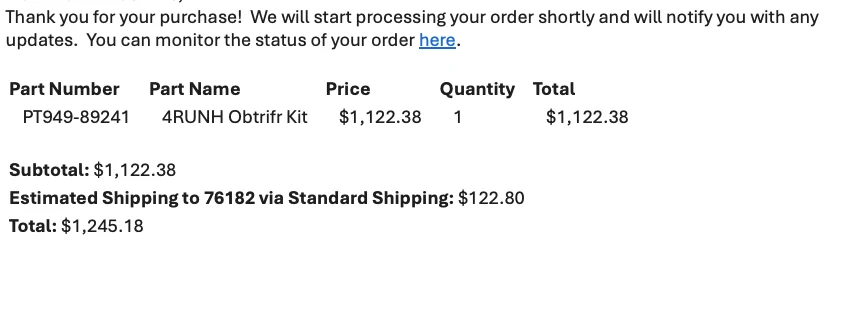

Well since I am a glutton for punishment, I called the guy who made the video and spoke to their parts department and was told this will fit on my ORP. I also left him a message to call me back or shoot me an email about the rear panel issue. Then I went to Nucar and ordered the full kit for $1100 (Glutton for Punishment) If it doesn't fit I will sell it to someone else.
So did you order PT949-89241 OR PT949-89241-AA ???
