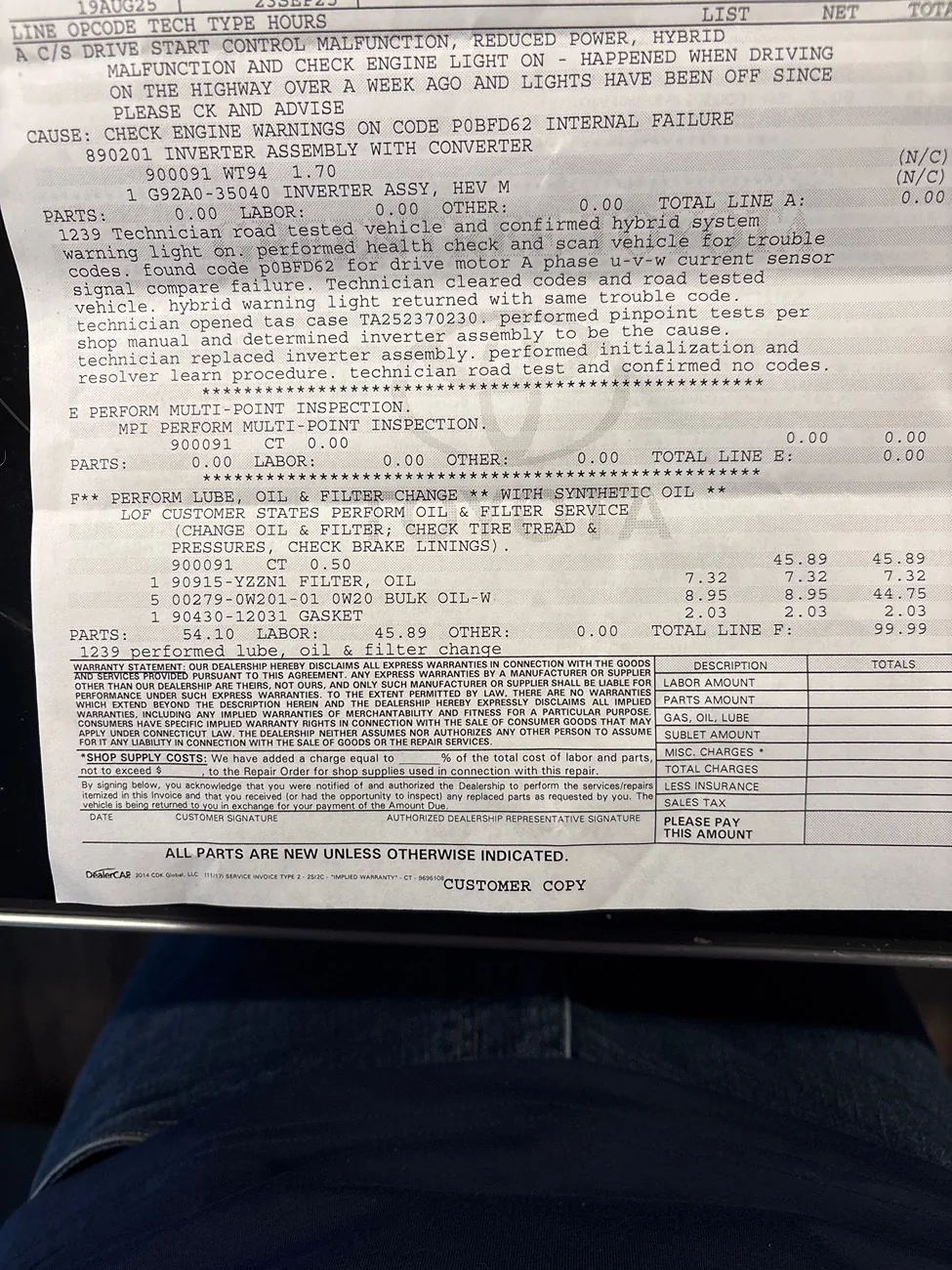

Just got a call from the dealer, they went through checking the alerts and all 3 alerts had error codes from the transmission.
He explained that Toyota doesn’t allow their dealers to repair individual parts of a transmission so it is sounding like complete replacement of the transmission is where they are headed.
The tech has been working with a Toyota Engineer documenting the case and running additional tests before they make a final verdict so I won’t have a final answer today but not a good thing.
In his words “I’ve been at this Toyota for 15years and I’ve never had to tell someone a repair that drastic with this low of miles”
Seems like the Tacoma Transmission issues may haunt some 4Runners after all!
ggrant20
Apr 18, 2024
72
Colorado Springs, CO
Alrighty closing out the loop of my issue, and short version is they made a software update, cleared the codes and tested. They kept it 2 days and put about 30mi on it and never triggered the issue again so I picked it up today.
Far reach from replacing the transmission but if that’s all it was and it never happens again I’ll be happy. Felt normal driving home so fingers crossed it was just a bug.

95miles on new TH… this happened to me 😡
Glad I didn’t accept Toyotas crappy trade offer… will be taking the TH to the dealership and my GM to go ski… wtf
also, the way it fails… you lose all engine power—scary and frankly dangerous in traffic
