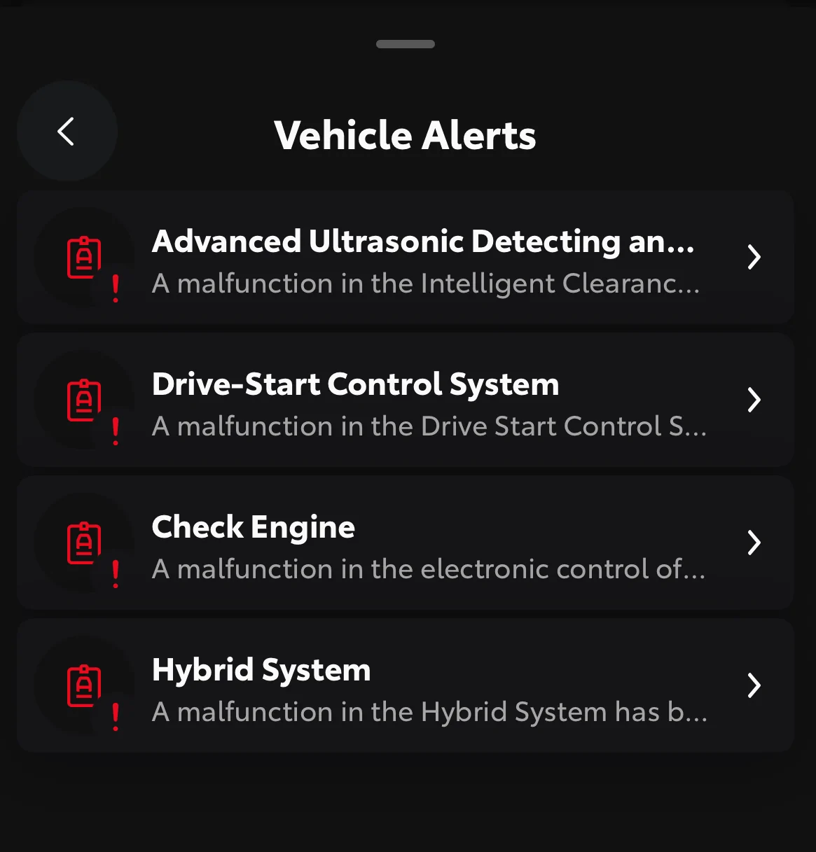

Alrightttyyy, add me to the list of FAILED transmissions! Last week I took the 4Runner out and drove to work and back no problem. I decided to step out to see some friends and thats when the car started with an insanely loud whirring and whine. I thought it was a one off and drove it, only to find out it would make this noise every time I stopped, braked, or shifted into drive.
Being worried I stopped driving it for the weekend and drove it to the dealership Monday. When they took a look, the senior tech said he had never seen this happen on a 4Runner. I left it with them for the day and they concluded that one of the pumps had failed and had actually started to break.
We are currently waiting on parts to come in, covered under warranty I believe. But we are only at 35,000km (22k miles). I drove this car for almost a year, and for this to happen is wild to me. Usually when my cars crap out, its after 10 years of me and my family driving it, not at less than a year.
I've included some videos of the issue and pictures of the codes that are currently showing, waiting for the car at the end of the week.
I'm curious as to what part/component failed specifically as the tech only said it was a pump.
