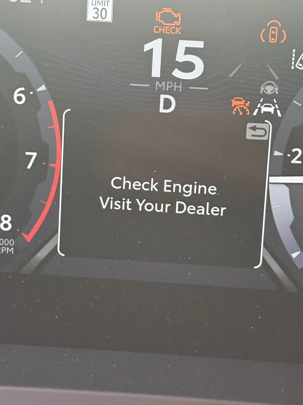

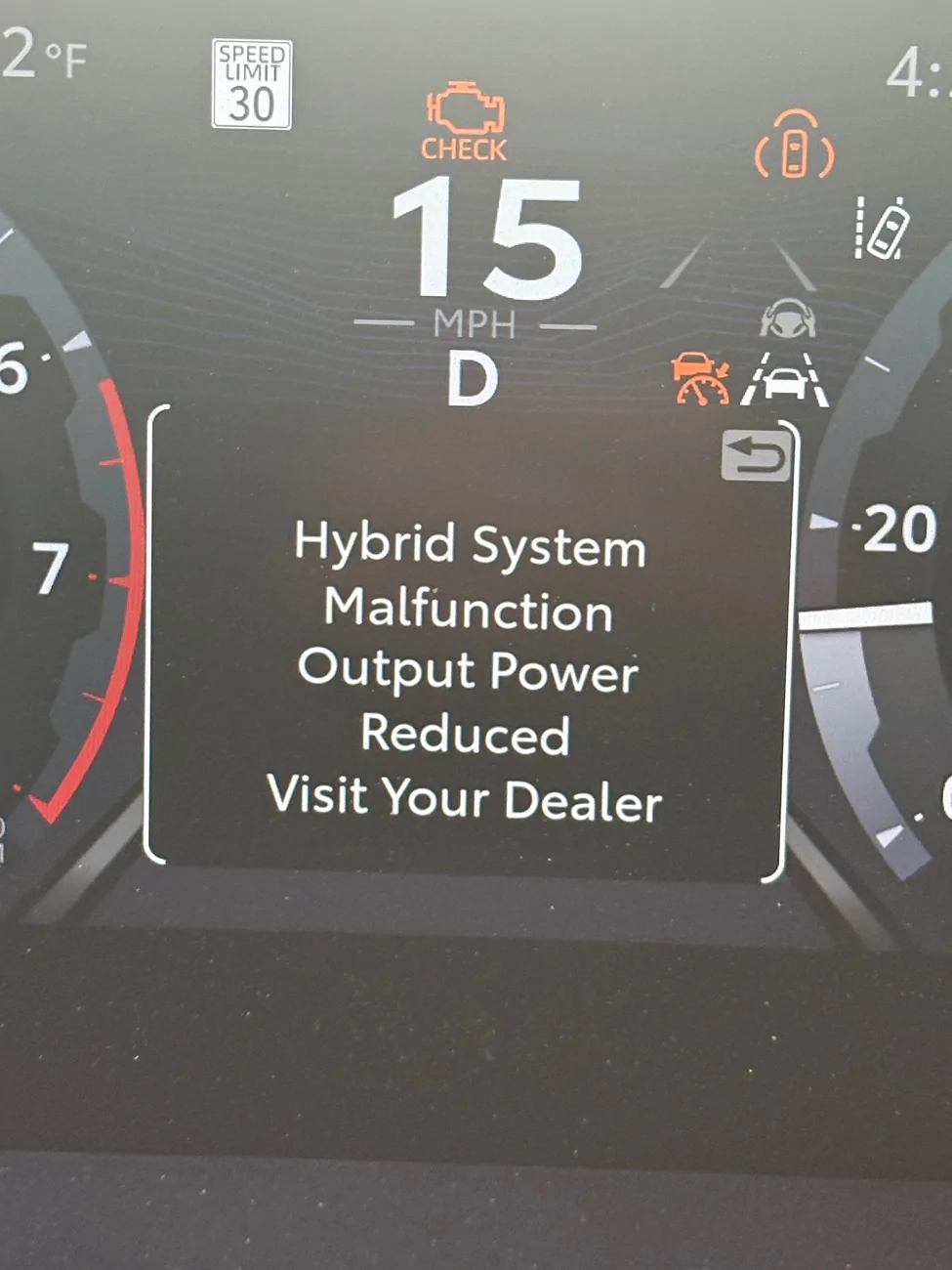

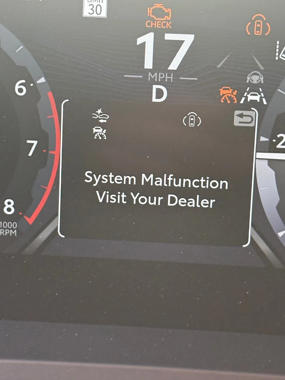

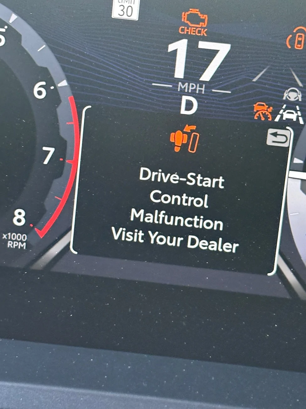

As I was waiting to get on the freeway I heard a thump like the vehicle shifted out of gear. Luckily we were in traffic and crawling and the Toyota dealership was 3 exits up when I hit 30 mph my rpm's were at 4000. Waiting to hear today. My platinum only has 1600 miles on it.

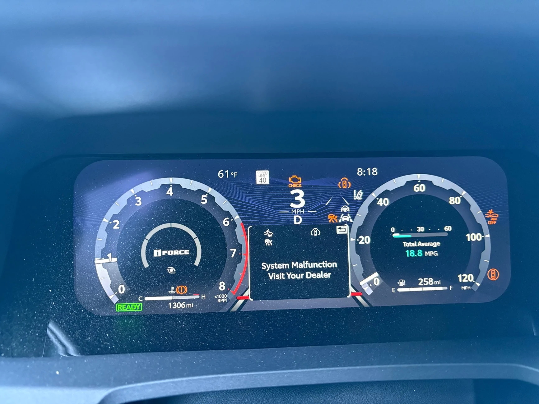

2025 2026 4runner 6th gen Hybrid system failed - "System Malfunction Visit Your Dealer" IMG_4739
2025 2026 4runner 6th gen Hybrid system failed - "System Malfunction Visit Your Dealer" IMG_4738
2025 2026 4runner 6th gen Hybrid system failed - "System Malfunction Visit Your Dealer" IMG_4734
2025 2026 4runner 6th gen Hybrid system failed - "System Malfunction Visit Your Dealer" IMG_4733
2025 2026 4runner 6th gen Hybrid system failed - "System Malfunction Visit Your Dealer" IMG_4732
2025 2026 4runner 6th gen Hybrid system failed - "System Malfunction Visit Your Dealer" IMG_4735
2025 2026 4runner 6th gen Hybrid system failed - "System Malfunction Visit Your Dealer" IMG_4736
2025 2026 4runner 6th gen Hybrid system failed - "System Malfunction Visit Your Dealer" IMG_4796
2025 2026 4runner 6th gen Hybrid system failed - "System Malfunction Visit Your Dealer" IMG_4795
2025 2026 4runner 6th gen Hybrid system failed - "System Malfunction Visit Your Dealer" IMG_4794
2025 2026 4runner 6th gen Hybrid system failed - "System Malfunction Visit Your Dealer" IMG_4793

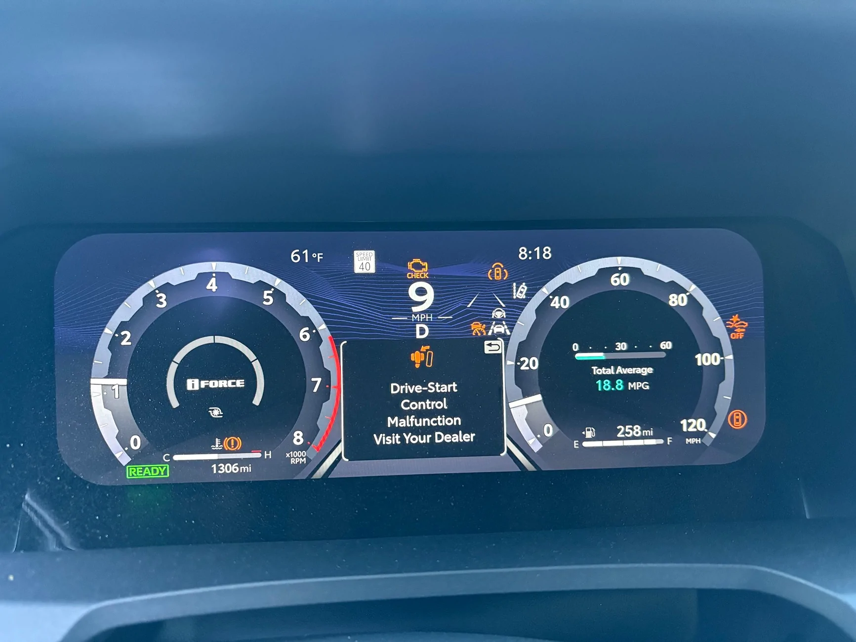

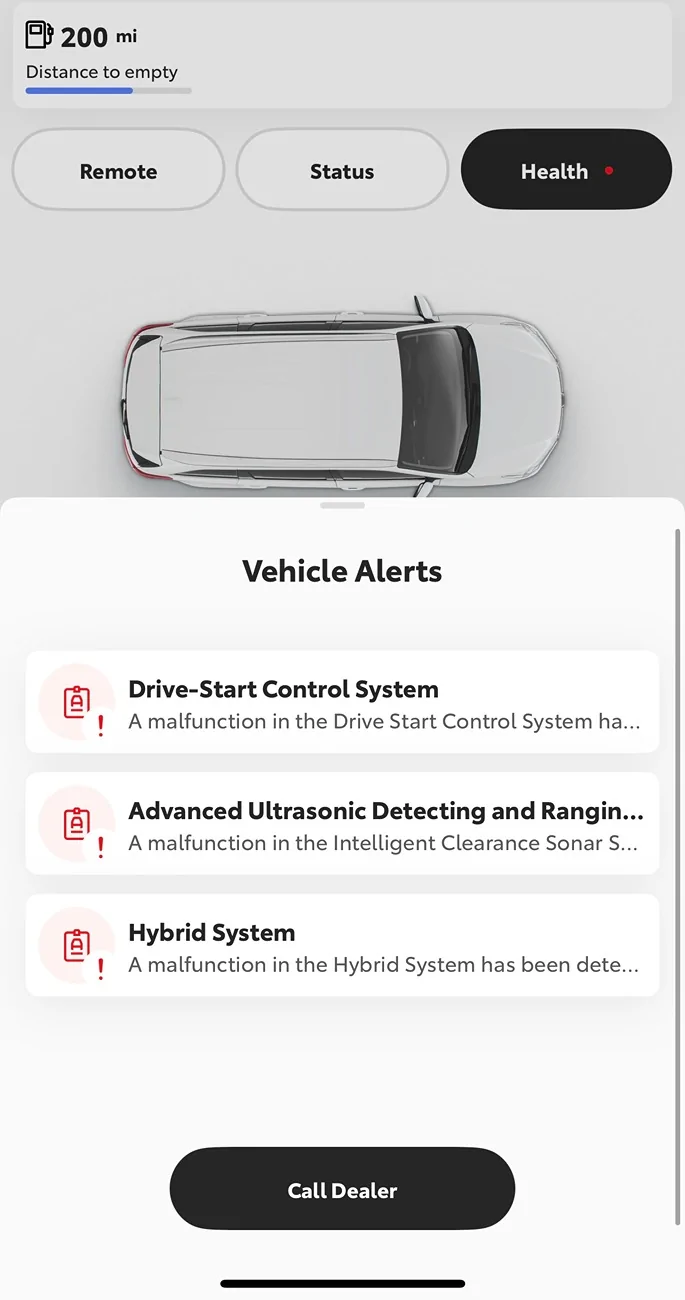

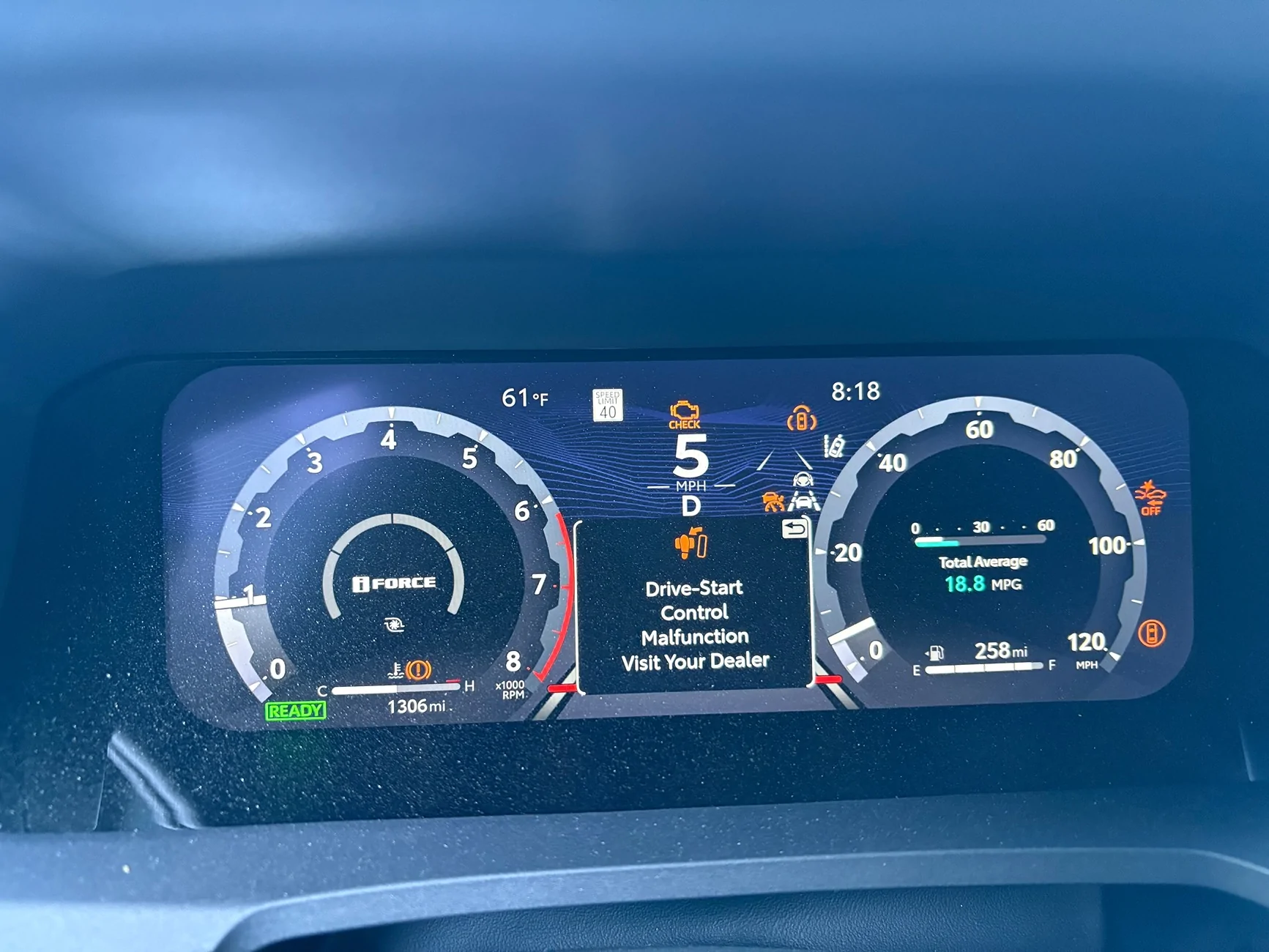

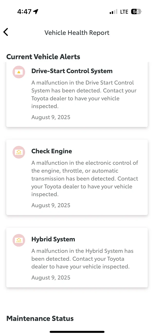

Well I unfortunately had something very similar happen to me on Saturday at 1523mi, just dropped it off at the dealership this morning. @CyrusJones am curious if your issue was also the Inverter Assembly or if it was something else?
Was running errands around town and all of a sudden while driving the car revved up and threw a bunch of alerts including:
- "Hybrid System Malfunction"
- "Drive-Start Control Malfunction"
- "Advanced Ultrasonic Detecting and Ranging System Malfunction"
2025 2026 4runner 6th gen Hybrid system failed - "System Malfunction Visit Your Dealer" IMG_0941
Thankfully was less than a mile from home, it was extremely sluggish, I still could drive up to the speed limit but seemed to really hold the RPMs before shifting in order to accelerate. Also noticed all the adaptive cruise control/emergency braking/etc were orange so I guess that is the "Advanced Ultrasonic" system.
This morning, when I turned the ACC on all the same warnings were on the dash, but as if it knew I was taking it in, it started up like normal and I watched all the dash lights shut off one by one.
Drove like normal, hybrid and everything working so who knows if the techs will be able to find anything. It still had the alerts in the car history with date and time so hopefully there is some data they can pull, keeping my fingers crossed and will update when I hear something!
