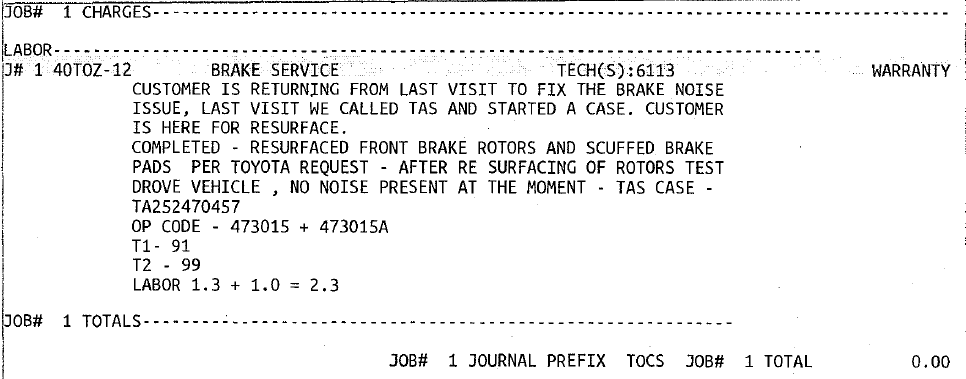

Today, 9/30/25, the squeal got much worse so I brought the car back to the same dealer that fixed the problem twice to no avail. This time, they had a suggested solution provided by Toyota TAS and fixed it as attached. So the annoying noise is gone at least for now and will keep you posted in a week or so. Cheers!
2025 2026 4runner 6th gen Front Brake Squeal Noise Fix - official TSB brakes fix! (TSB-0046-25) Front brake pads scuffed and rotors resurfaced Sep 30, 2025

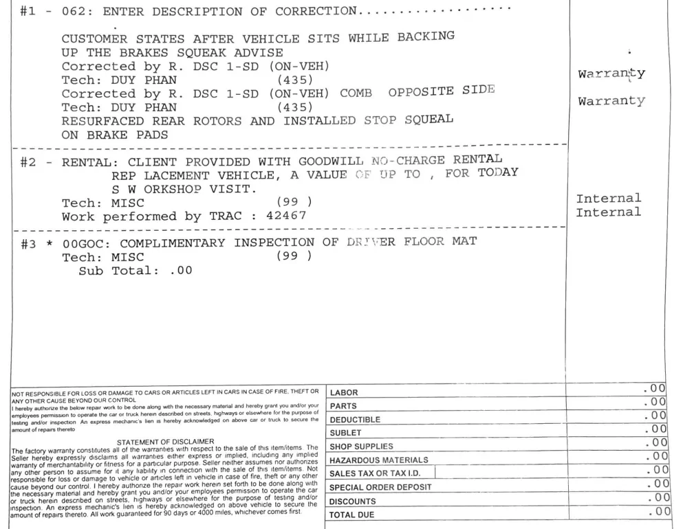

Interesting update. Dealer called me today and said they were able to successfully reproduce the noise, and they believe it is coming from the rear brake/rotors, not the front brakes which is what the TSB addressed. They are going to resurface the rotors on the rear brakes and do a few other things and call me again tomorrow.

Are they doing this out of the goodness of their hearts? Charging you for it? Or essentially charging Toyota for it? Since it isn’t on the TSB verbatim
No, it was free and covered under the warranty.
They resurfaced the rear rotors today, so hopefully this fixes it. The guy told me if the noise comes back, they'll do the same on the fronts, free of course.
