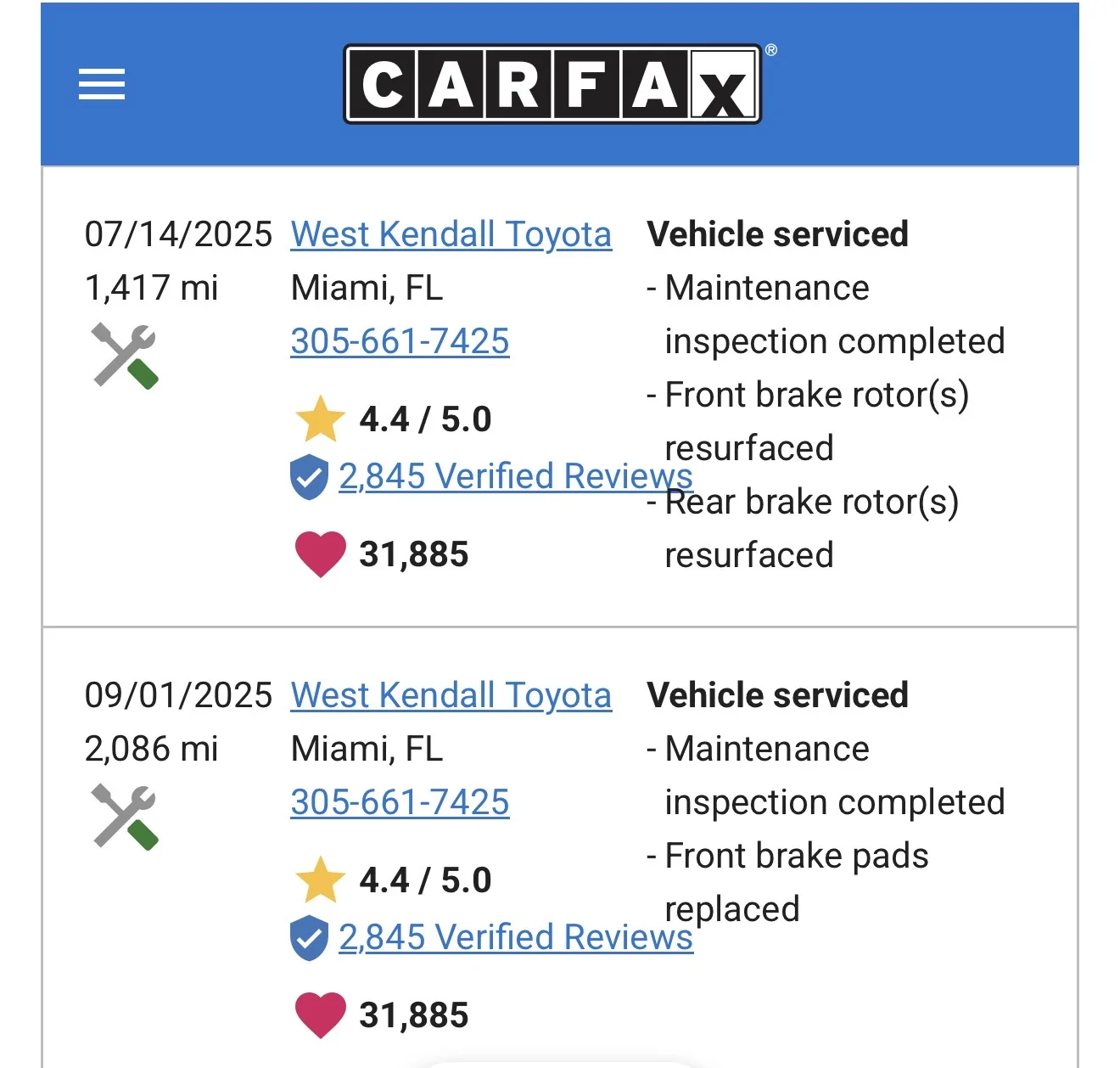

After two times taking it to the dealership, the screeching sound is gone! It has rained a lot in Miami, but nothing!!🙏🏻🙏🏻. BTW, I posted the two receipts from the dealership with the work done
How many days has it been? I am in margate.

Please see image from Carfax to see the dates
How bad was it equaling before,
