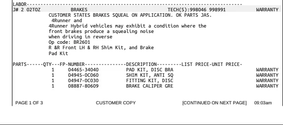

Got done with mine along with the 10k service. We'll see if it holds up.
2025 2026 4runner 6th gen Front Brake Squeal Noise Fix - official TSB brakes fix! (TSB-0046-25) Screenshot 2026-06-08 at 11.19.55 AM

Had mine done a week ago. So far, so good!

Just got off the phone with Toyota's Brand Engagement Center and this has been superseeded by T-SB-0046-26. She was supposed to send me a copy and instead sent the T-SB-0046-25 version.
This is my 4-Runner, 3 months after the TSB repair. Took it back today. They said there is updated parts that are on back order due to the mass amounts of owners with the same issue. Has anyone had the second round of updated parts yet? And did it work?
Same, two months in and not a peep since they did the TSB.
