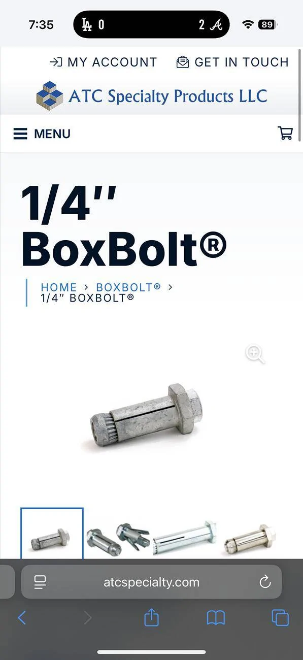

Can’t install OEM rock rails because no threaded holes in the frame
onateacd
Apr 11, 2024
41
2025 Toyota 4runner TRD Off Road Premium
Yup. Bizarre. I ordered blind bolts and will give them a try. There are some threaded holes but most are not.

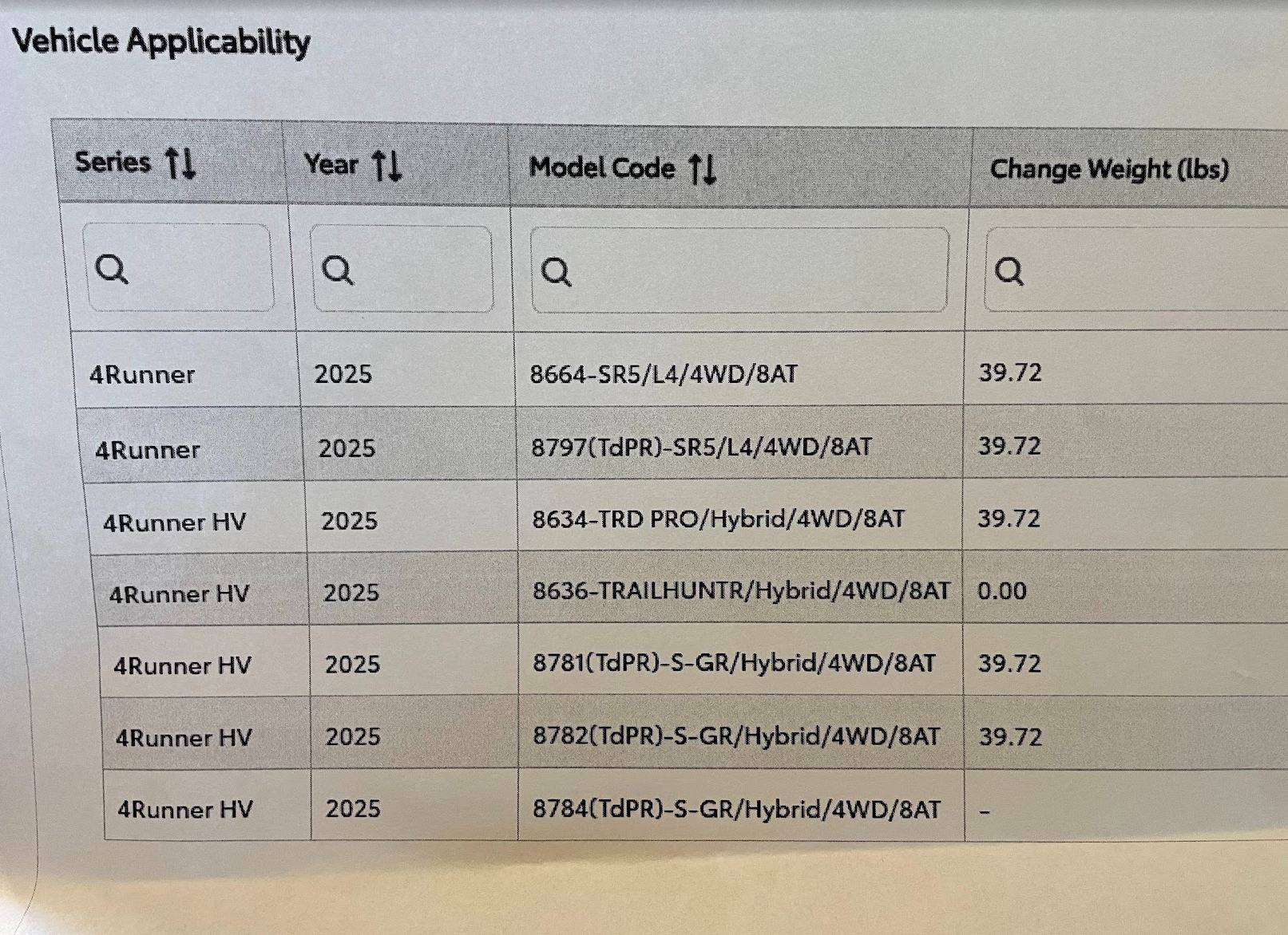

Just spent 2 hours at my local Toyota dealership and didn't make any progress. They looked up the OEM rail compatibility and told me that the TRD Sport was not on that list (attached). Not sure how the SR5 is but the TRD Sport & Off Road isn't.. Finally got a hold of a person at CBI who is sending over a warranty claim form to have them send out a new hardware kit they are preparing for this issue they are now becoming aware of

So did anyone have success mounting the OEM rock rails using an aftermarket blind bolt solution? I am about to pull the trigger on these OEM rails bc there's a sale.
onateacd
Apr 11, 2024
41
Yup. Used 1/4 box bolts and they worked perfectly.
