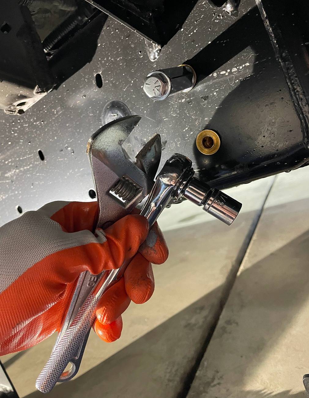

Do yourselves a favor and pickup a Nutzert tool to install the nutzerts. Harbor Freight has a cheap one that works fairly well, alot better than trying to hold them and using 2 wrenches. JMHO

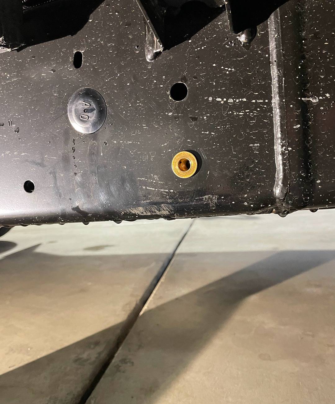

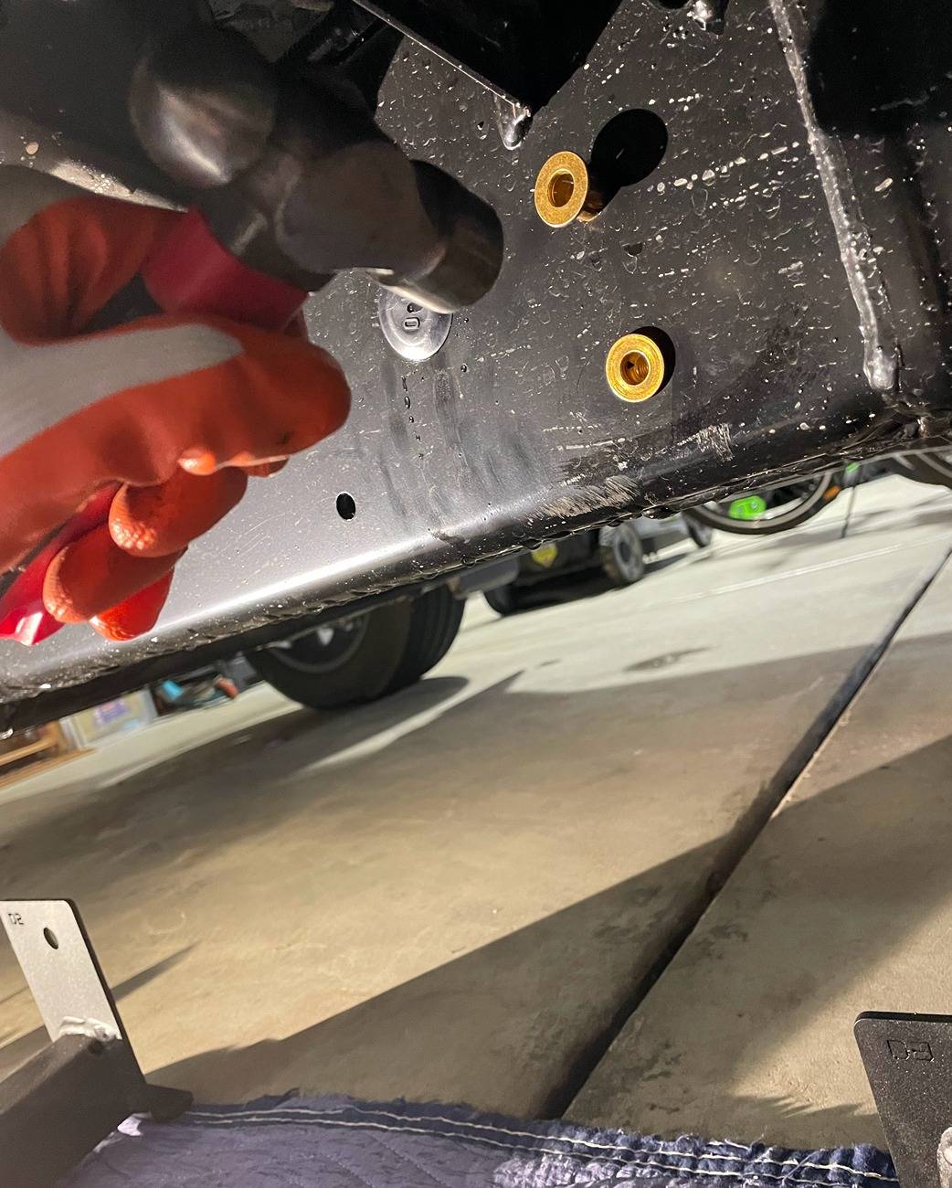

Was able to get these installed last night. Went as smoothly as I could have hoped. Took some muscle to get those rivet nuts secured but wasn't too bad, probably 5 min per hole
