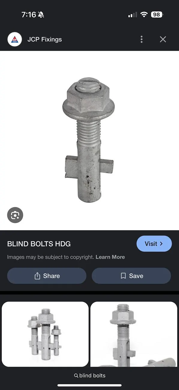

I've considered Westcott Design sliders, so just called them to inquire about the blind bolt kit that they sell for unthreaded holes. Their blind bolts are a toggle style that don't require a special installation tool. I'd like to be able to remove the sliders for repainting, and he said that the toggles can be removed; they don't just drop into the frame when the bolt is removed.
Blind bolts might be a solution for installation of OEM and other brands onto frames without threaded holes.

Blind bolts. Interesting. Anyone know if those can be rendered separately anywhere?
onateacd
Apr 11, 2024
41
2025 Toyota 4runner TRD Off Road Premium
I think we have something here. Is this what they are?
