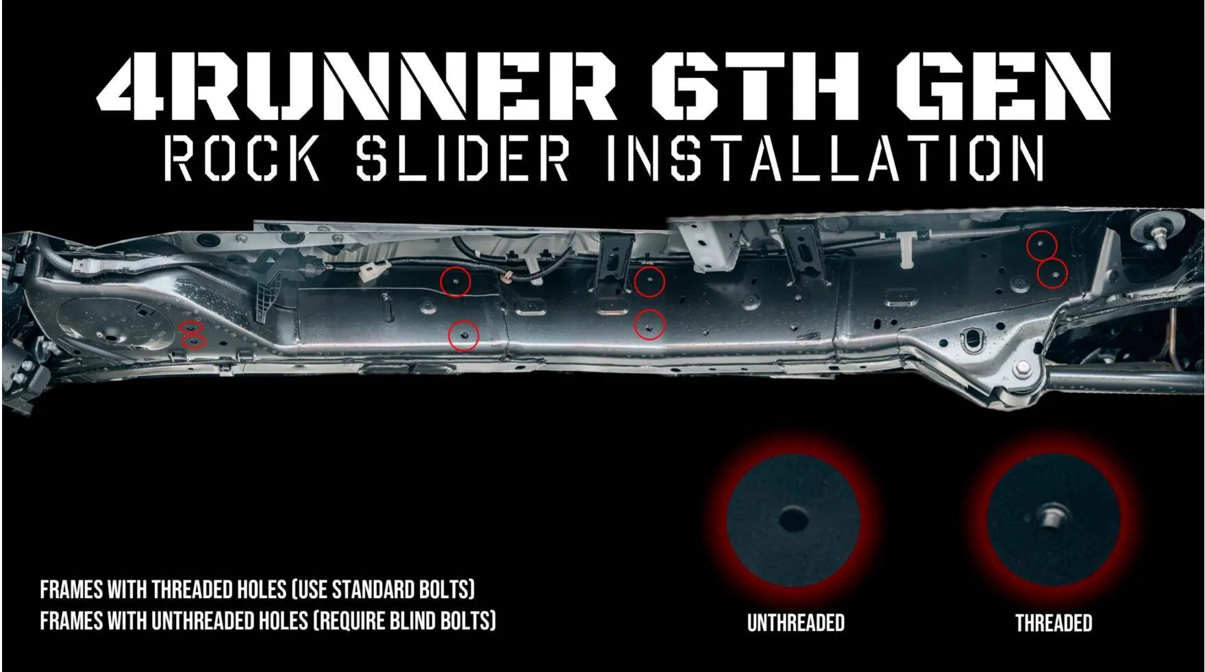

This has been bothering me I asked an aftermarket company who is developing parts and they said it does have threaded mounting locations so I finally laid under it and looked with a head lamp and yes there are spots on then Frame maybe every foot that are open and threaded just waiting for rails. I have an Off Road Premium.

CBI said that only the sr5 has threaded holes so they have some nut thing that they use for installing their sliders. Sounds like some ORP owners have threaded ones tho so who tf knows what happened here.... I am about to go look at mine in a sec.
Here's a video of CBI explaining

Unlike 5th gen where it was threaded on the side of the frame, the threads I saw on the bottom of the frame match up with what Westcott did for their sliders

I just checked and mine has 2 threaded holes near the center of the frame on the sides. How many threaded spots do the OEM rails require?

Just found an image from wescotts site showing two different install options. With and with and without holes
2025 Toyota 4runner Can’t install OEM rock rails because no threaded holes in the frame Screenshot 2025-04-26 120757
