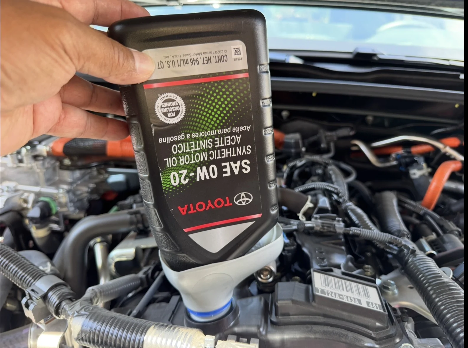

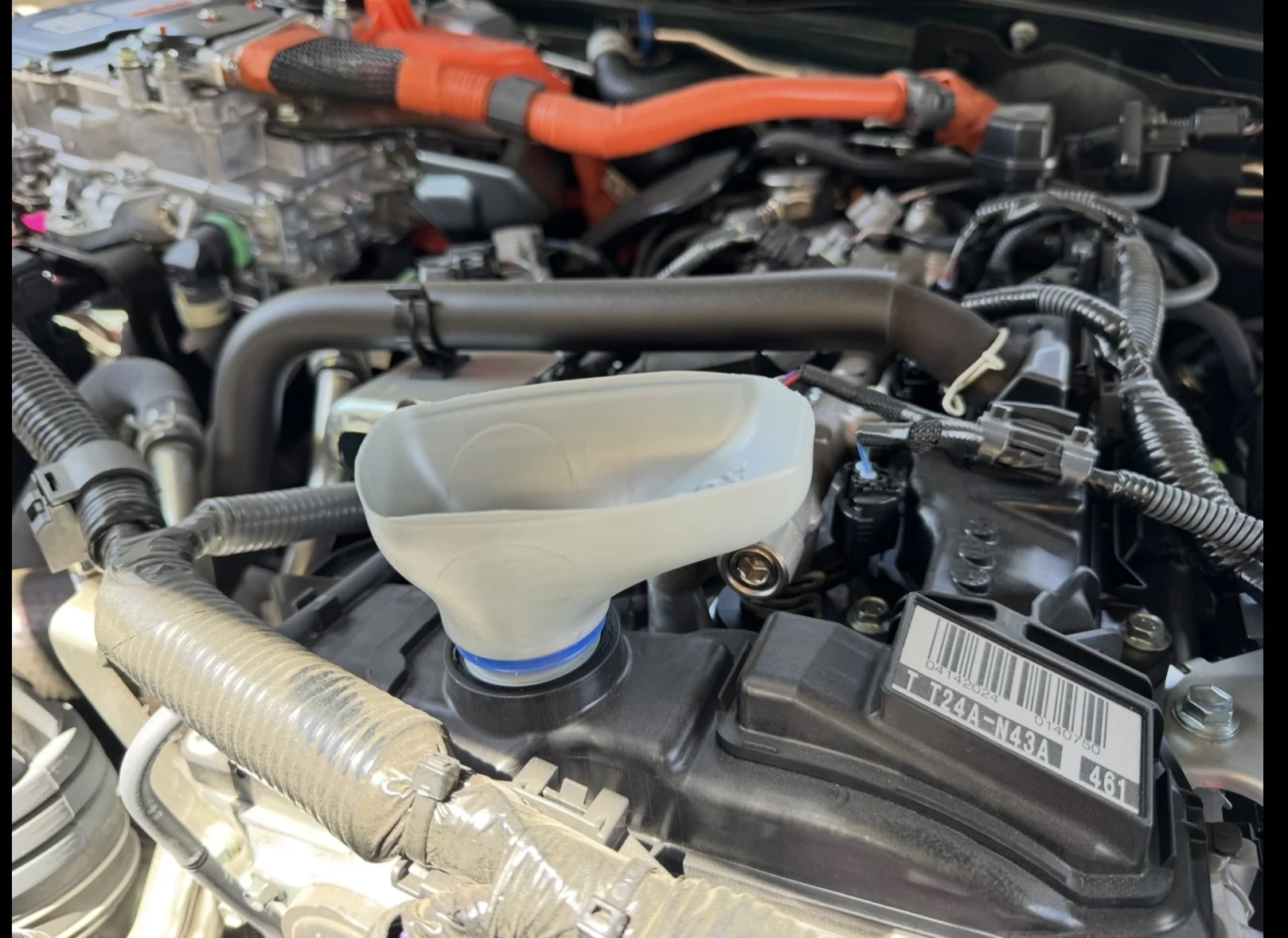

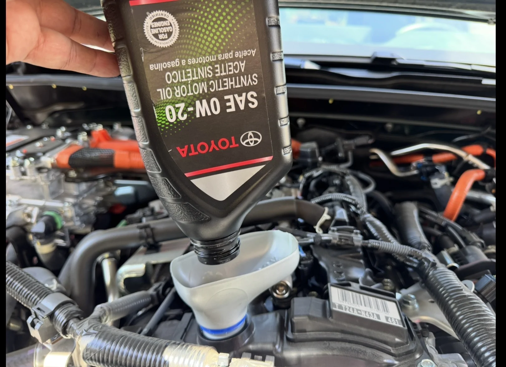

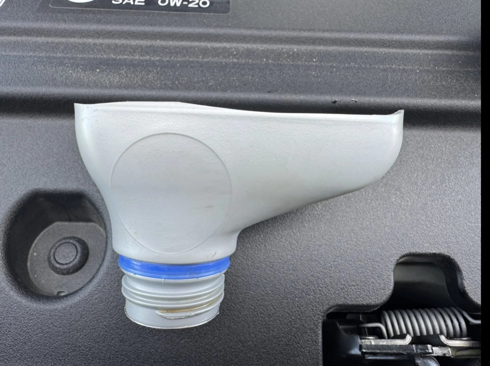

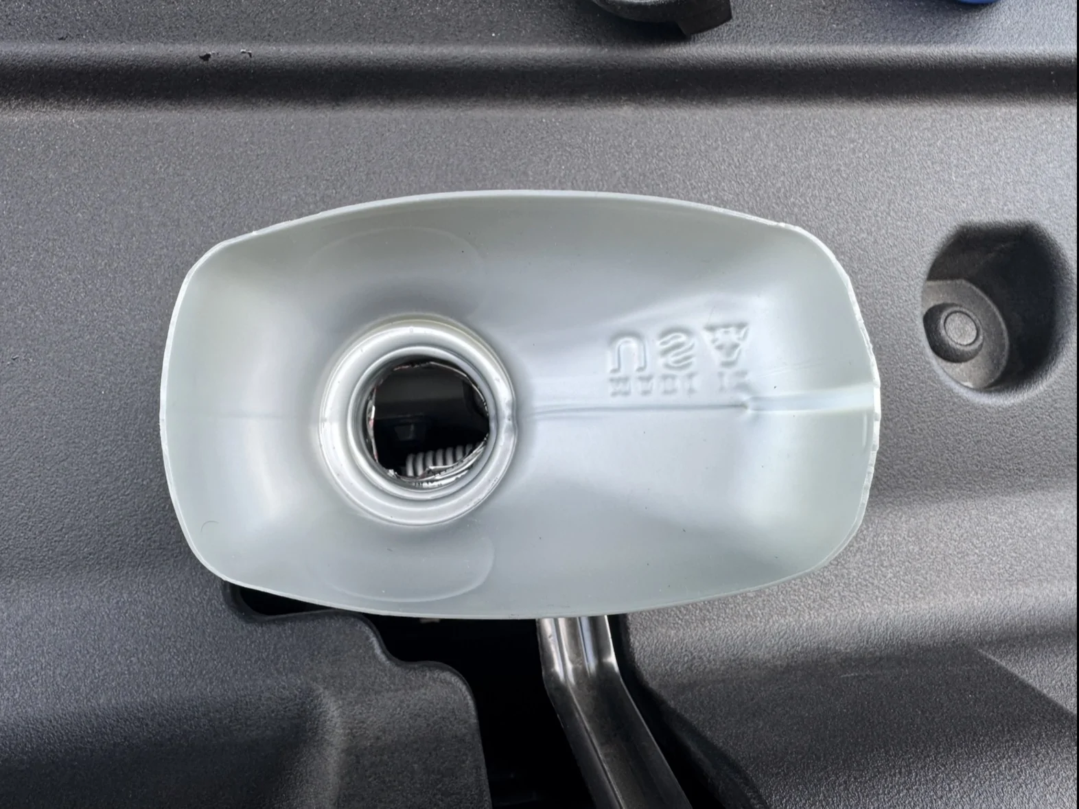

Save money just cut an empty oil jug and use it as a funnel it screws in perfectly on the oil fill up save the cap too

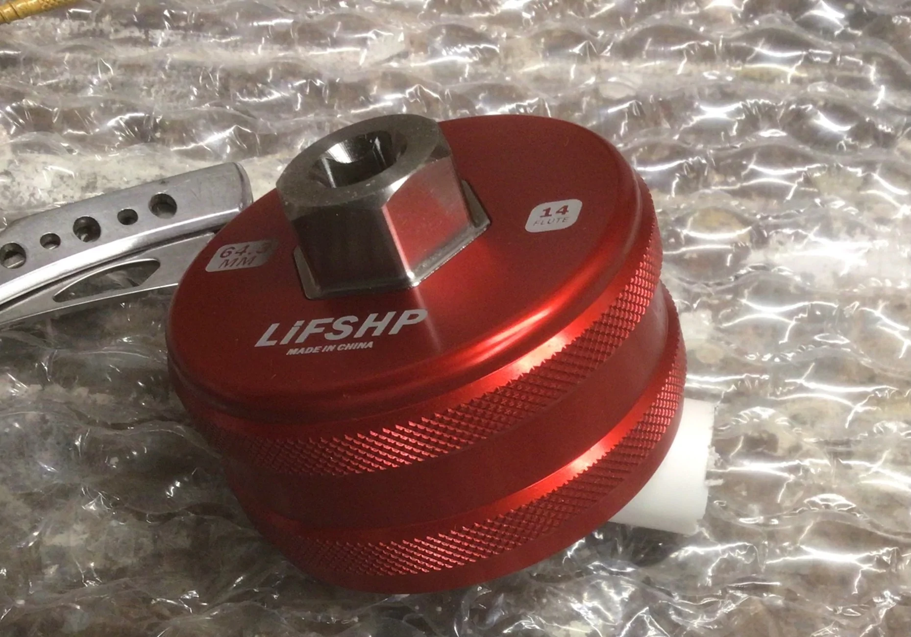

Thanks for all the info.
Funnel is the only way to go. The jug thing is a good idea.
That truck up on ramps makes it impossible to finesse anything under the hood. Got to be on a stool etc, etc.

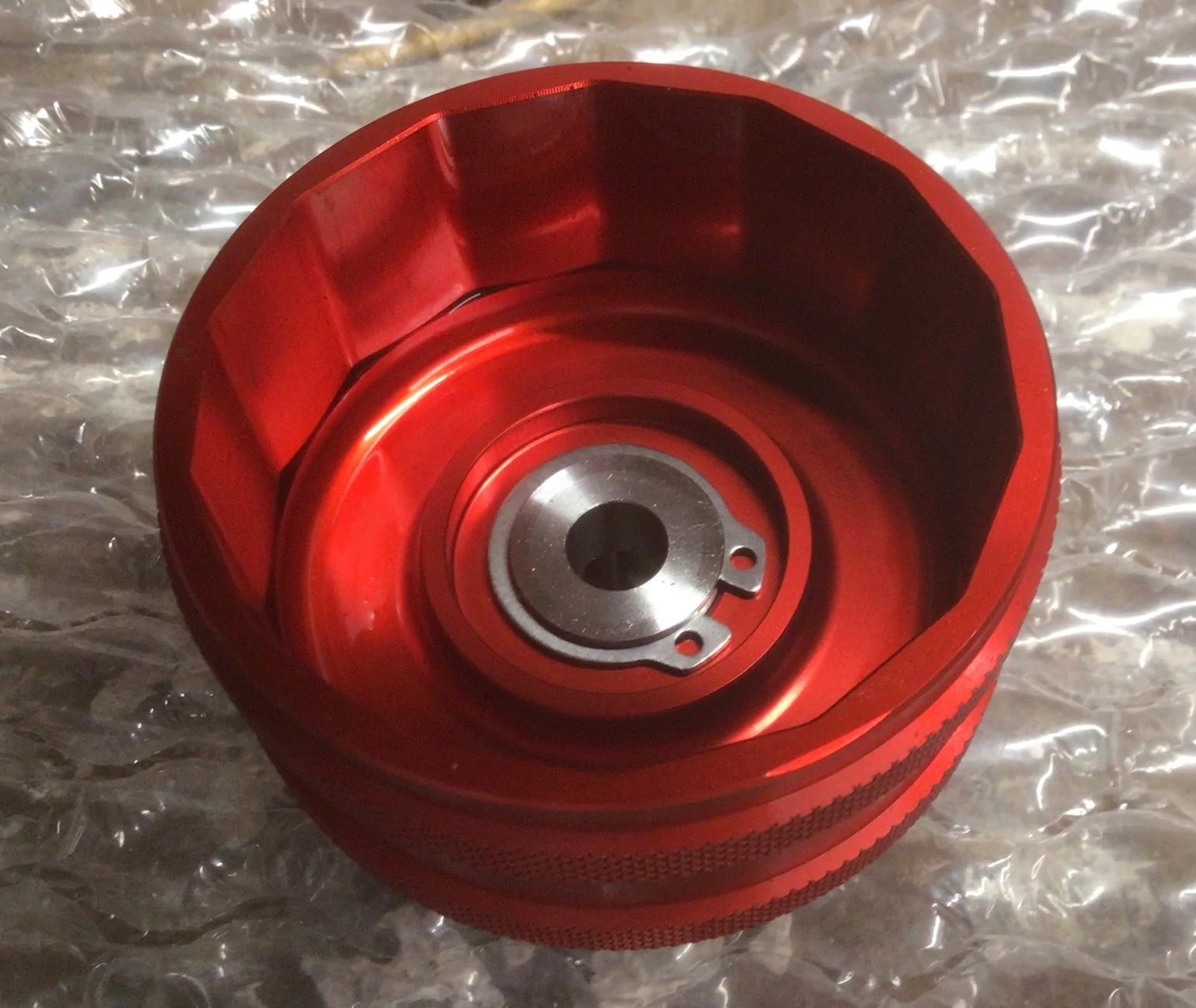

Bought a filter removal tool. Well made with tight tolerances.
Probably could drive over it.
Definitely a forever tool, until they change the filter.
