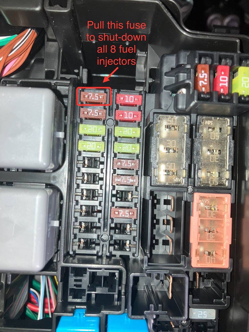

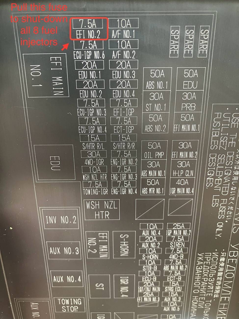

I signed up for a one-month subscription access (about $20) from ALLDATA, an online source for automotive repair manual info. As of this month, June 2025, ALLDATA does NOT yet have the 2025 4Runner information available, but they do have the 2025 Tacoma with the same 2.4L L4 (T24A-FTS) engine as the 6Gen 2025 4Runner.
So, I browsed the 2025 Tacoma electrical diagrams for the 2.4L engine, and traced the fuse and relay circuits that control all eight fuel injectors (4 direct injection and 4 port injection).
If you want to shut down all eight fuel injectors with the simplest method (i.e., least number of fuses and/or relays to remove) so the engine will crank (turn-over) but NOT start, just remove the following single fuse that is labeled: 7.5A EFI NO. 2
This fuse is located in a black “fuse and relay” box inside the engine compartment on the driver’s side (left side, as viewed from the driver’s seat) next to the inner front fender. For those that don’t know, please look on the inside of the “fuse and relay” box lid to see a diagram map of the fuse locations as well as fuse descriptions.
When I removed the fuse and then proceeded to crank (turn-over) the engine, the ECM (the main computer) would only allow the engine to crank (turn-over) for approximately seven seconds at a time, then stop. I don’t know if the ECM only allows seven-second-long engine start intervals at any time, regardless if the 7.5A EFI NO. 2 fuse is removed or not, when going through the engine start cycle?
Be aware that there will be several different error messages pop-up on the instrument display that will tell you the ECM is NOT in a happy mood because that EFI fuse was removed. Whenever the fuse is reinstalled, the error messages will go away and the engine will start normally again.
Check out the two attached images to see exactly which fuse that I temporarily removed.
