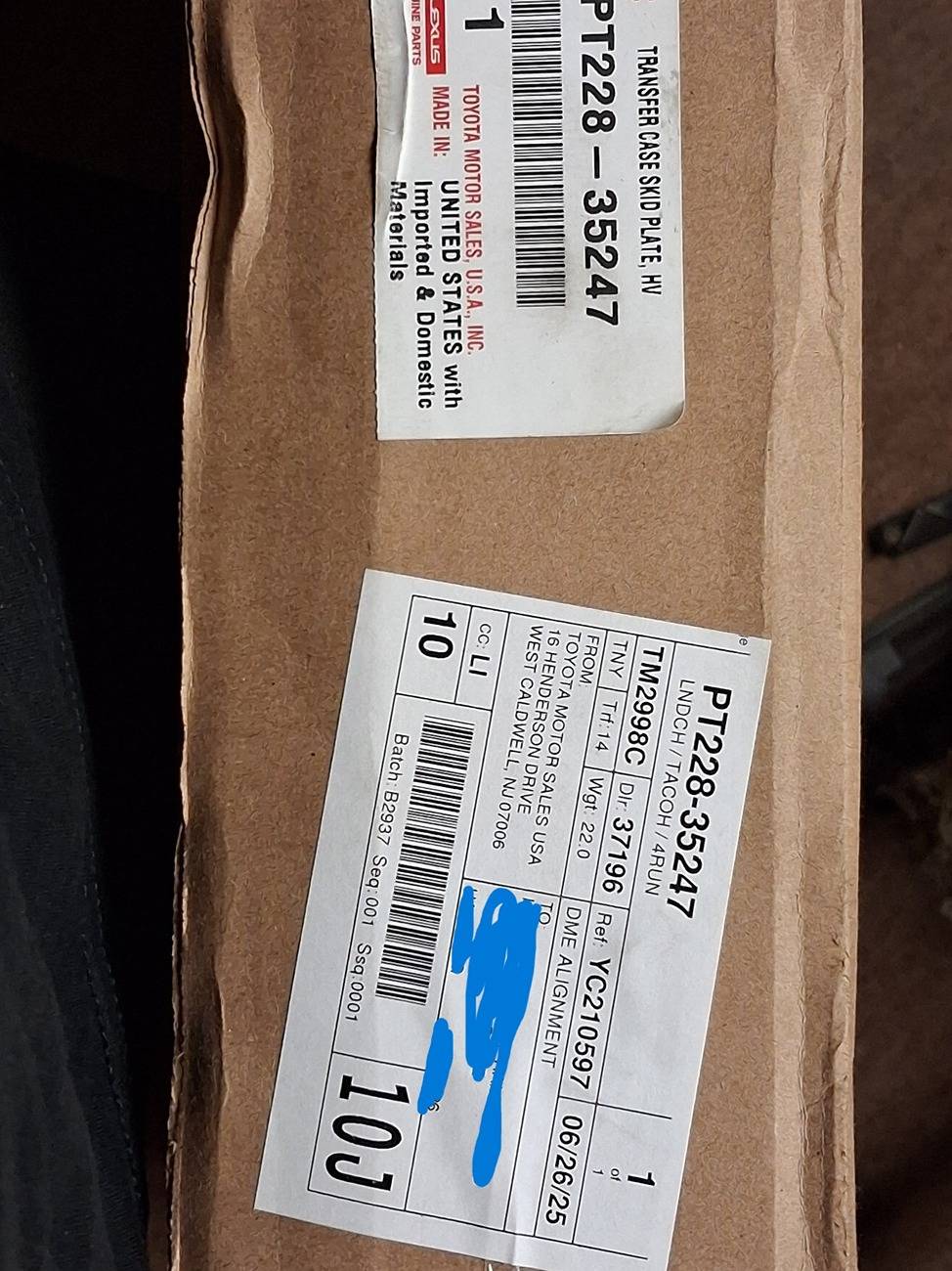

Front Skid Plate - SteelPT228-35240
Transfer Case Skid platePT228-35247
Rear Diff Skid PlatePT228-89253
Note that this was for the hybrid version
I did mine local pickup at a dealership during memorial day weekend. A ton of discounts so i spent about $600-700 total

Dealership actually sold me the non hybrid TCSP, then a hybrid version showed up at my door step before I even had a chance to try the one they sold me. (y) KELLY TOYOTA.
Heading out to the shop to see if it's gonna match up with my "Pro" TRD front skid.

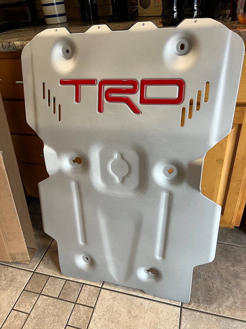

You can pair the TRD plates with the trailhunter transmission plate. Send pics on how it looks
Archer
Apr 23, 2025
717
699
Orwigsburg, Pa.
2025 4 Runner TRD Pro
Confirmed,
TH Tranny/Transfer skid plate matches up to the TRD Aluminum Front Skid. I'll take pics over the weeknd.
