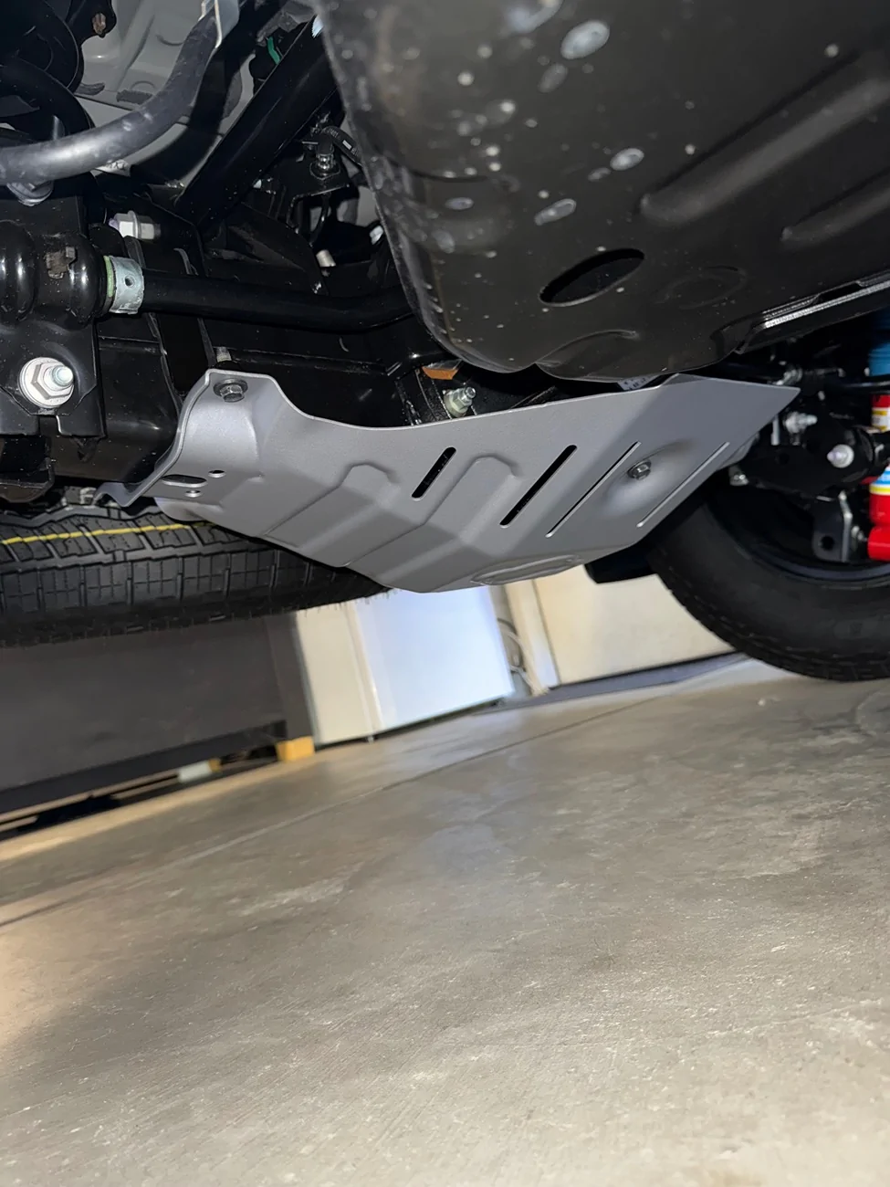

Looking at the differential skid plate picture, looks to be installed the other direction than the Tacoma video.
Noticed the one bolt in the middle on his picture is facing rear.
The Tacoma video shows thhe one bolt in the middle, (that secures the rubber liner), facing towards the front of the vehicle and the 2 bolts (also secures rubber llining) is facing rear.
Guess iit can be installed either direction? I installed mine like the Tacoma videeo:. I guess it works both ways.
Any thoughts?
Here's a picture I found on the internet or possibly member of this forum showing how I installed mine

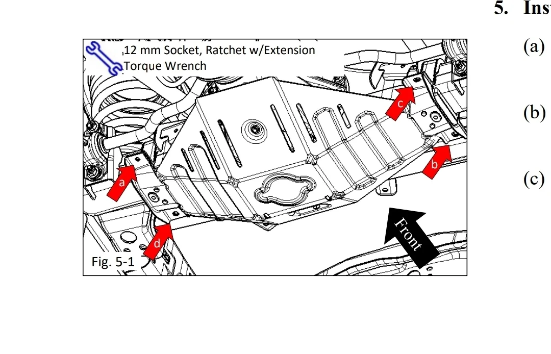

That first pic is installed backwards. The installation instructions show the single bolt on the sway bar side of the axle. Although, I can see where that "Front" arrow might be confusing. Also, the large rubber piece "hugs" the diff's driveshaft protrusion when installed with the single bolt towards the front.

Correct, the way mtbtone installed it in the picture is incorrect. You want it in the orientation as shown in the PDF instructions. Unless you will primarily going in reverse.

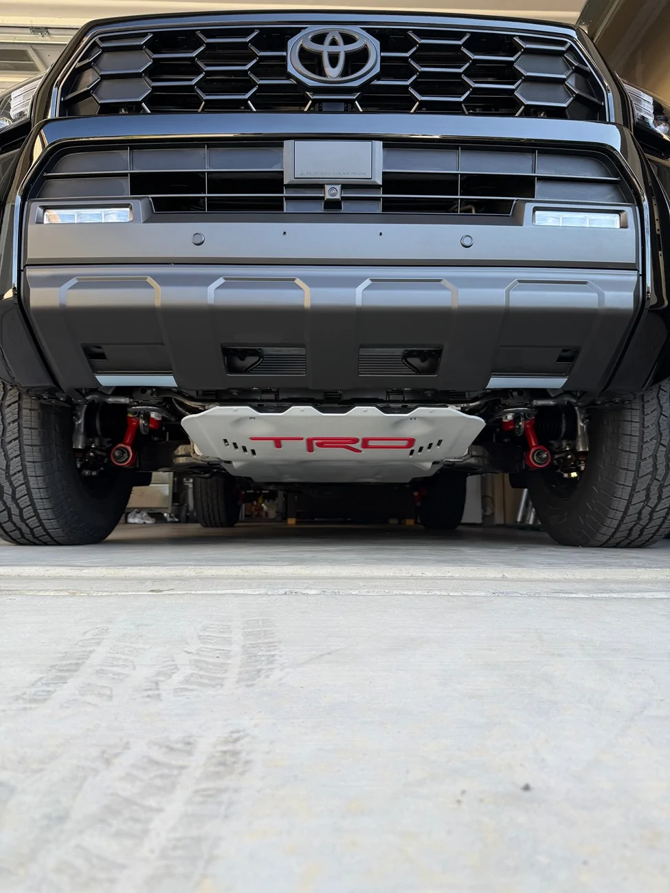

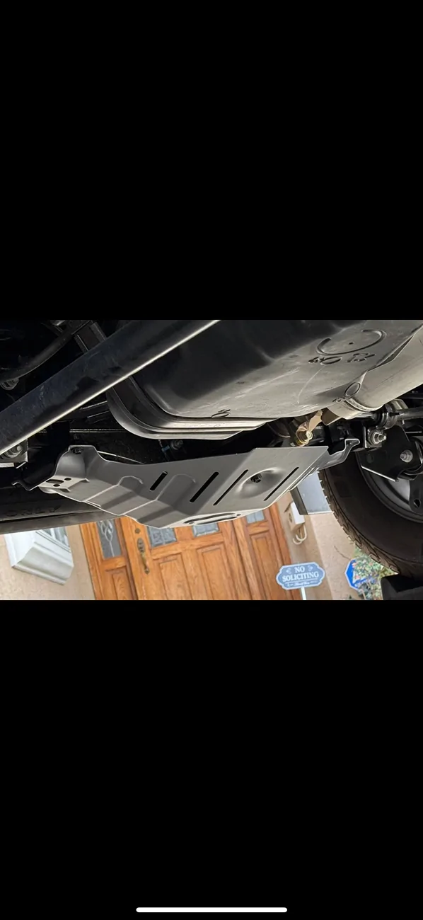

Done! All bolts torqued into place! Here it is!
Excuse the clutter in the background.
2025 2026 4runner 6th gen Skid Plates Part Numbers - Rear differential skid plate + front & transfer case skid install IMG_8916
2025 2026 4runner 6th gen Skid Plates Part Numbers - Rear differential skid plate + front & transfer case skid install IMG_8917
2025 2026 4runner 6th gen Skid Plates Part Numbers - Rear differential skid plate + front & transfer case skid install IMG_8920

I just realized I also had the PDF install instructions for the center / front skid plates.
Just attached them to the OP. This will be the ultimate skid plate forum!

My apologies to all. I’m embarrassed, but happy to be a part of this community so I have good people to help when I make a mistake! Just flipped the plate around and re-torqued. Thanks again! And sorry to anyone who may have made the same mistake because of my pic.
I just noticed your post. It looks like you attached the transfer case skid plate instructions for the LandCruiser which seems to have extra parts. My previous post has the pdf for the 4Runner PT228-35247 (hybrid) and PT228-35248 (non-hybrid) transfer case skid plates if you want to attach them to the OP.
