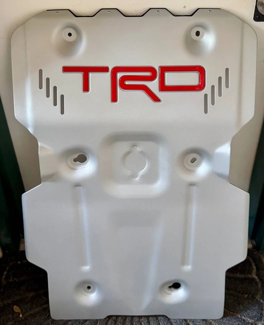

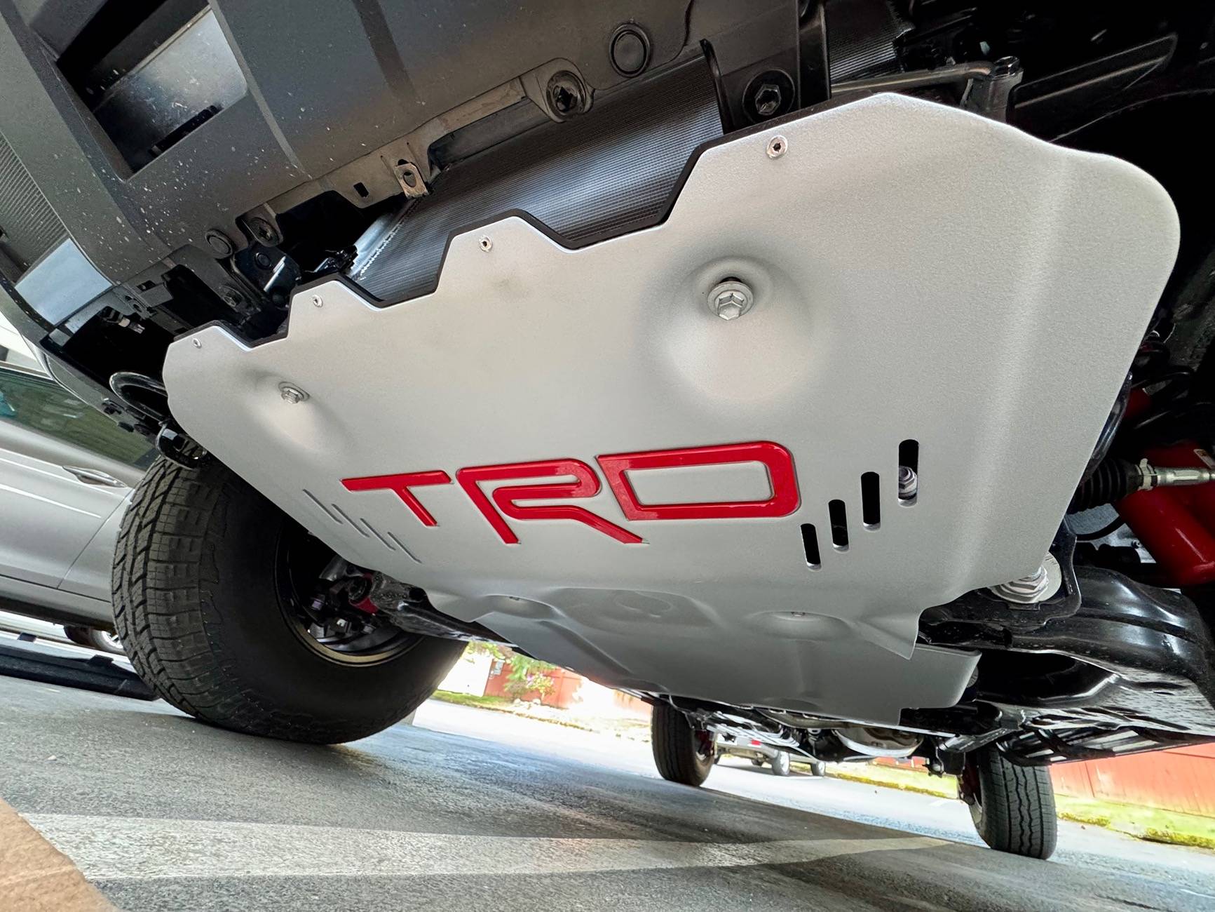

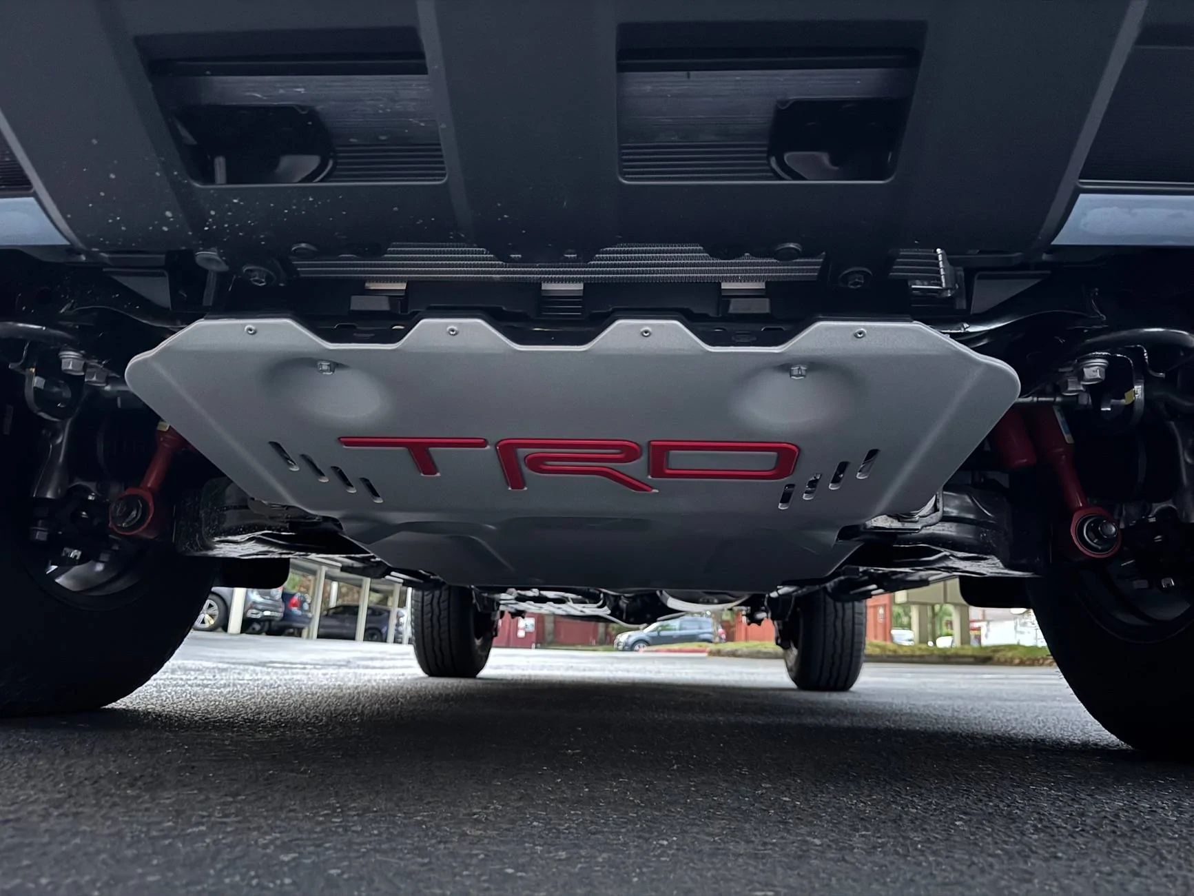

Purchased online from a dealer that had no sales tax, a sales going on and free shipping from Toyota.
Total $414 shipped to my door.
Part number: PTR60-35240.
Very easy to do on the driveway: remove 8 bolts, reinstall with 6 bolts, done.

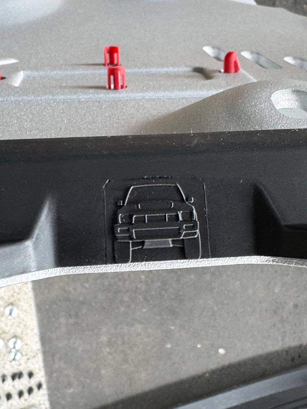

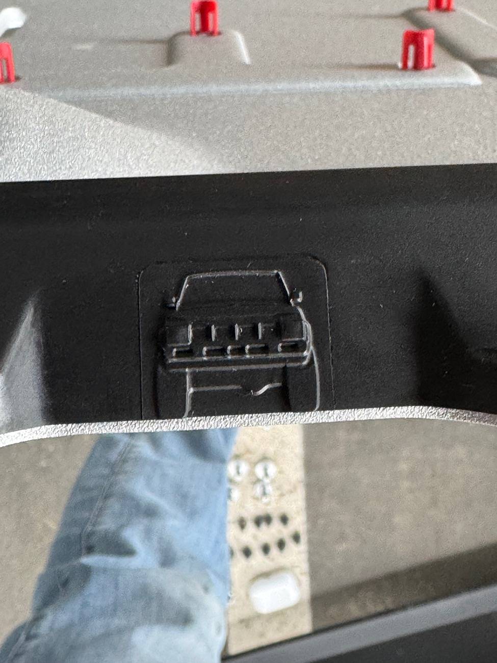

Nice Easter eggs on the front of the the skid plate (2 older 4R outlines).
2025 2026 4runner 6th gen TRD Aluminum Skid Plate installed on TRD off-road (photos & installation instructions) IMG_1632

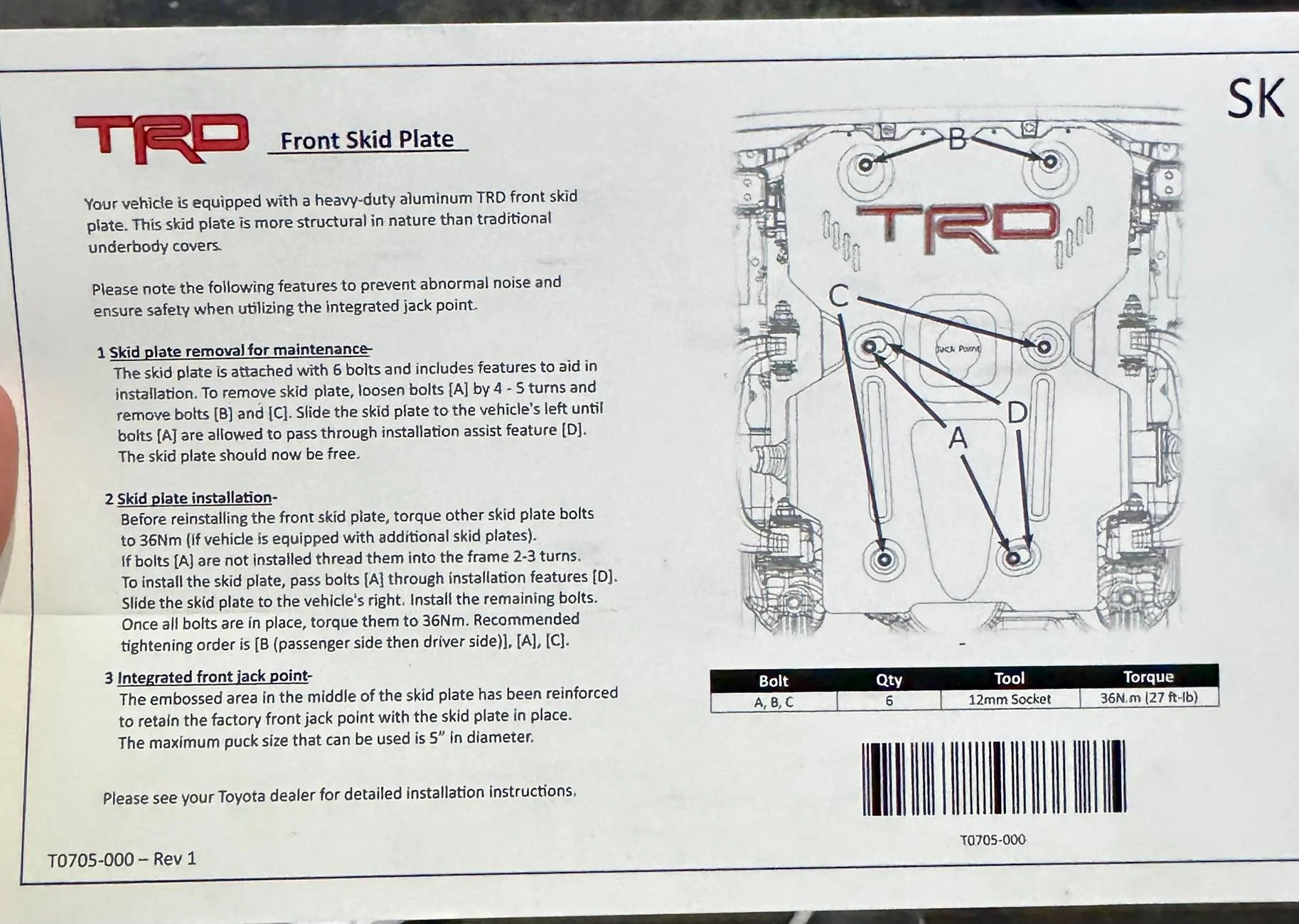

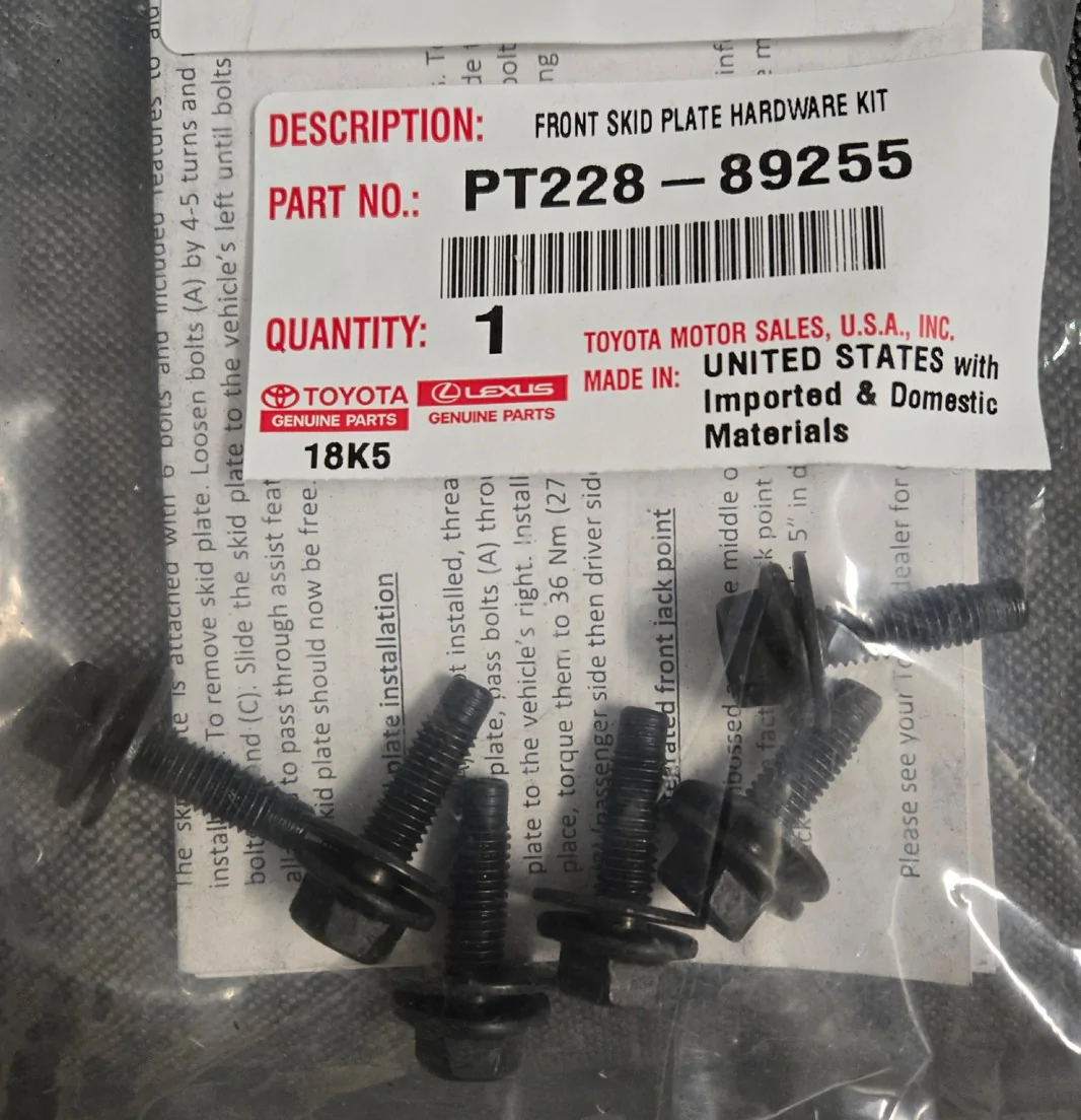

Just make sure you also order the hardware kit. It's just 6 bolts but they have to be ordered separately (you'll only have 4 bolts if you have the OEM plastic protector). It's PTR60-89252 for the Aluminum TRD Pro or PT228-89255 for the TrailHunter Steel.

Just make sure you also order the hardware kit. It's just 6 bolts but they have to be ordered separately (you'll only have 4 bolts if you of the OEM plastic protector). It's PTR60-89252 for the Aluminum TRD Pro or PT228-89255 for the TrailHunter Steel.
Install procedure (attached below) states to discard the original undercover fasteners.
2025 2026 4runner 6th gen TRD Aluminum Skid Plate installed on TRD off-road (photos & installation instructions) 20260310_204718
They are slightly different than those in the Front Skid Plate Hardware kit.
2025 2026 4runner 6th gen TRD Aluminum Skid Plate installed on TRD off-road (photos & installation instructions) Skid Bolts

One thing thats odd. The prescribed set of six are shorter than the bolts for the felt plates. Despite the skid plate being thicker.
