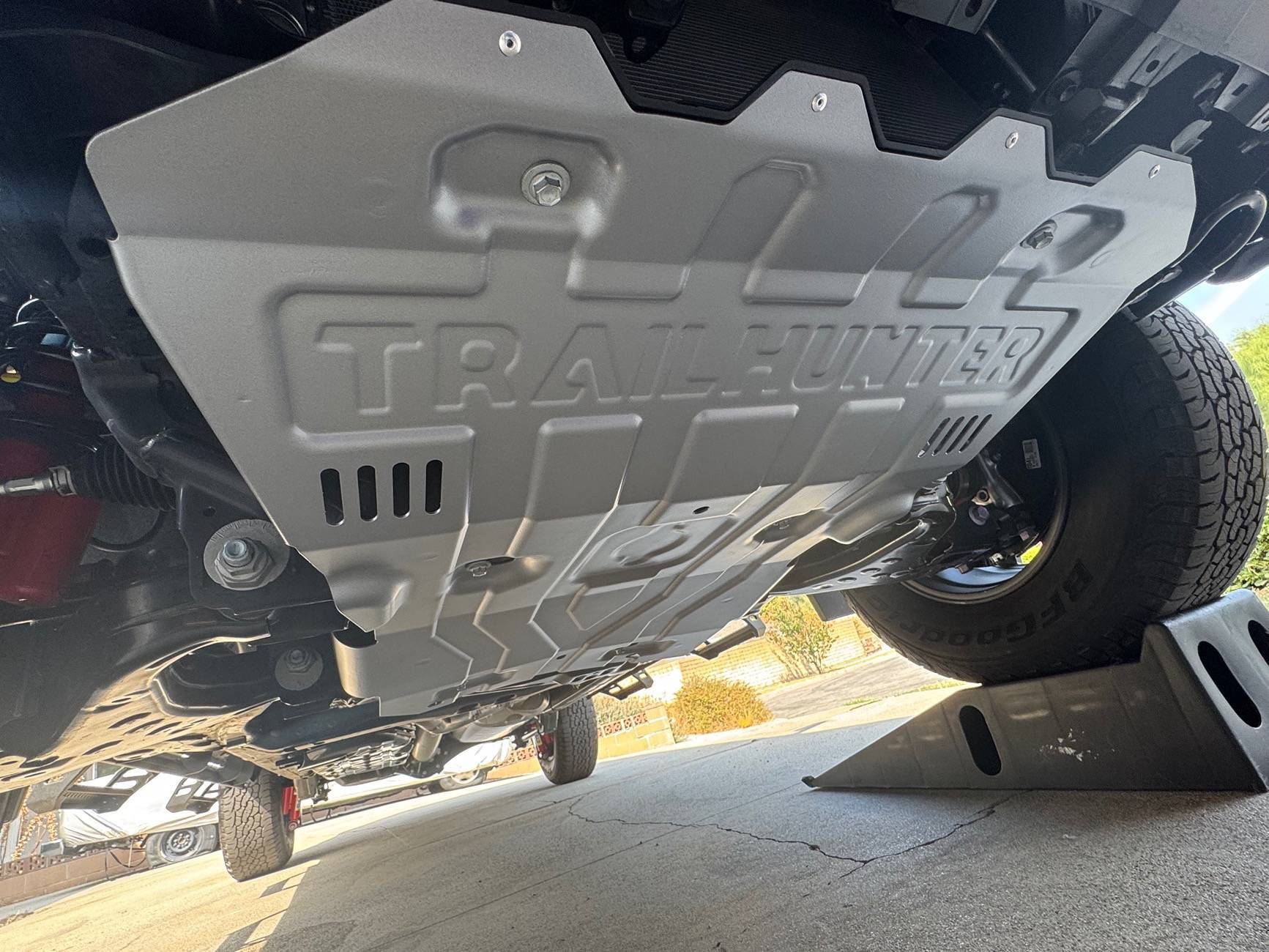

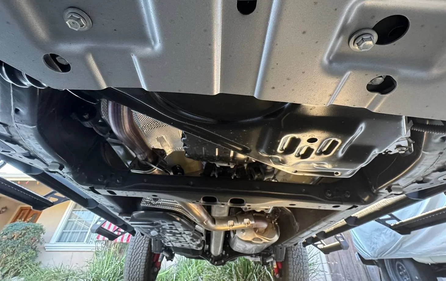

Here's all three Trailhunter skids installed a TRD Off-Road Tacoma (which shares undercarriage / underbody with 4Runner). Below are post-install photos of all 3 Trailhunter skid plates (vs. factory TRD Off-Road before install).
From Tacoma4g
I've installed all three skid plates found on the Trailhunter. Front Bash Plate, Transmission Skid Plate, and Differential Skid Plate. I've seen some confusion as to whether or not they are steel and they definitely are. They are heavy and magnets stick.​
Some important notes before buying, all the front bash plates fit every Offroad, Pro, and TH model Hybrid or not, The Diff Skid and Transmission Skid Plate are different part numbers and sizes for non Hybrids. Installation for the Diff Skid was slightly more complicated but still very straightforward and easy. The other plates just bolted on.​

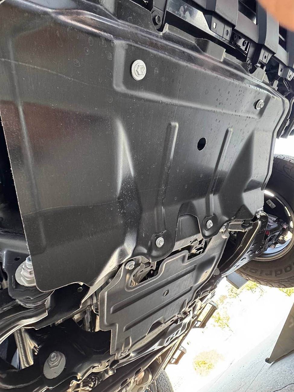

TrailHunter Front Bash Skid Plate vs. Stock Off-Road Skid Plate​
2025 2026 4runner 6th gen All Trailhunter Skid Plates install on TRD Off-Road: Front Bash Plate, Diff Skid, Transmission Skid Plate trailhunter skid plate front bash plate
Factory Stock TRD Off-Road​
2025 2026 4runner 6th gen All Trailhunter Skid Plates install on TRD Off-Road: Front Bash Plate, Diff Skid, Transmission Skid Plate TRD Off-Road factory OEM bash plate

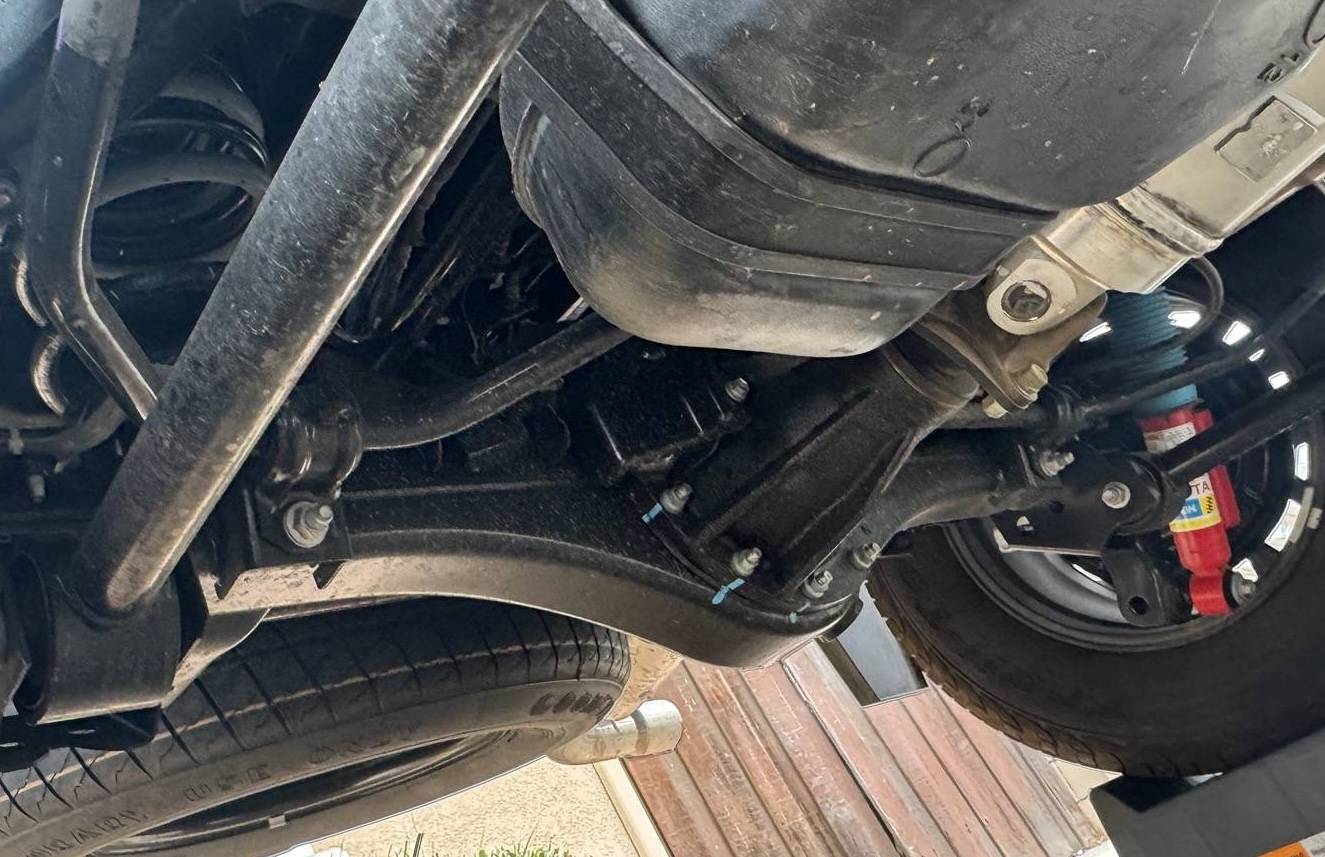

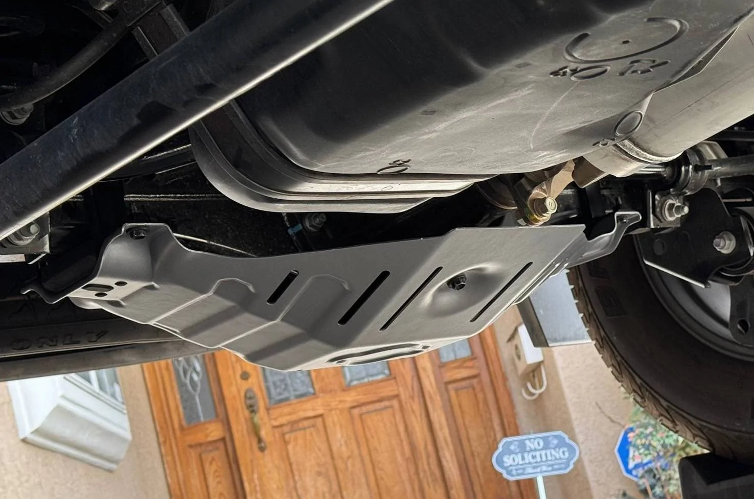

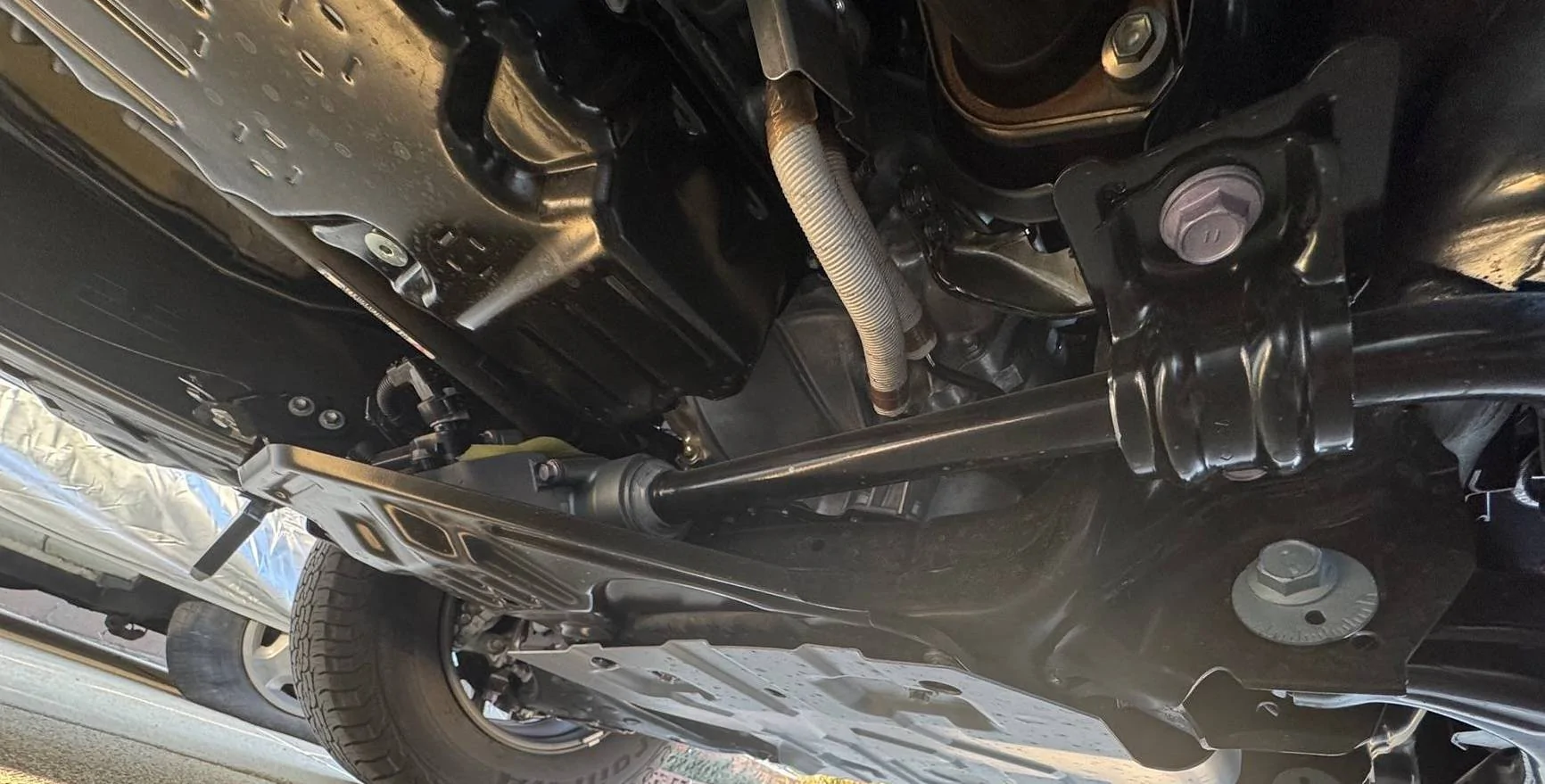

Trailhunter Diff Skid vs. Factory Off-Road (no plate)​
2025 2026 4runner 6th gen All Trailhunter Skid Plates install on TRD Off-Road: Front Bash Plate, Diff Skid, Transmission Skid Plate Trailhunter diff skid plat
2025 2026 4runner 6th gen All Trailhunter Skid Plates install on TRD Off-Road: Front Bash Plate, Diff Skid, Transmission Skid Plate TRD Off-Road diff no skid plate factory OEM

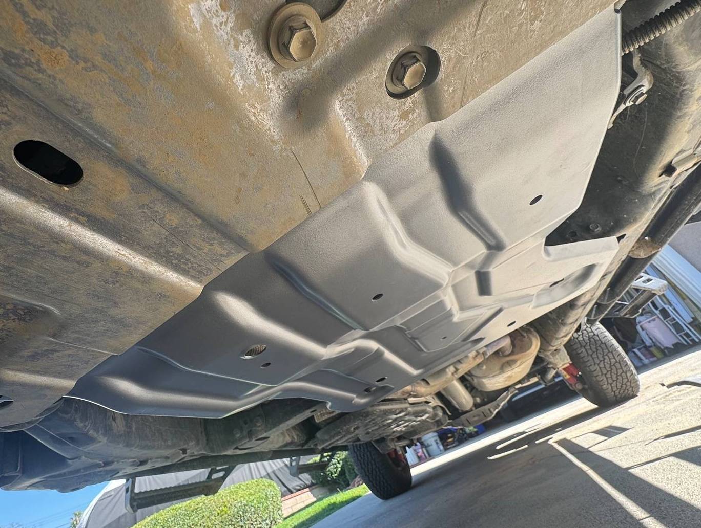

Trailhunter Transmission Skid Plate vs. Factory Off-Road (w/ SDM).​
-- The Transmission Plate plate did come with new bolts.​
Trailhunter Skid Plate​
2025 2026 4runner 6th gen All Trailhunter Skid Plates install on TRD Off-Road: Front Bash Plate, Diff Skid, Transmission Skid Plate Trailhunter transmission skid plate 3

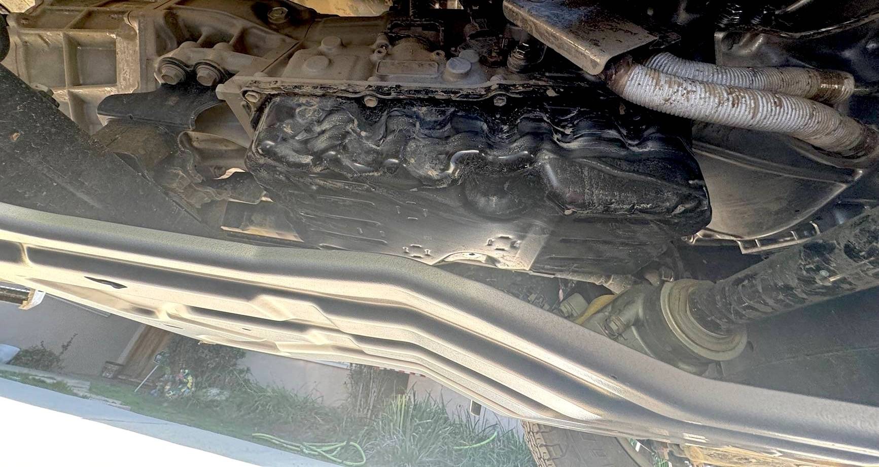

2025 2026 4runner 6th gen All Trailhunter Skid Plates install on TRD Off-Road: Front Bash Plate, Diff Skid, Transmission Skid Plate Trailhunter transmission skid plate 4
2025 2026 4runner 6th gen All Trailhunter Skid Plates install on TRD Off-Road: Front Bash Plate, Diff Skid, Transmission Skid Plate TRD Off-Road Transmission no skid plate factory oem
2025 2026 4runner 6th gen All Trailhunter Skid Plates install on TRD Off-Road: Front Bash Plate, Diff Skid, Transmission Skid Plate TRD Off-Road transmission no skid plate factory

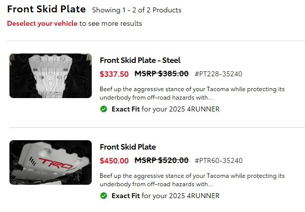

I ordered the front skid plate for my ORP. The Toyota parts website says that it's an exact fit for my vehicle, but when I checked out (online order), the order said that it "May not fit your selected vehicle". I called the a Toyota dealership and they confirmed that it should fit. It's just weird to see a discrepancy in the final order screen.
Here are the two skid plates their website says will fit my ORP:
2025 2026 4runner 6th gen All Trailhunter Skid Plates install on TRD Off-Road: Front Bash Plate, Diff Skid, Transmission Skid Plate 1742854859221-pn
Trailhunter skid plate info:
Beef up the aggressive stance of your Tacoma while protecting its underbody from off-road hazards with this skid plate. •Helps prevent damage to underbody from rocks, branches, ice chunks and other types of road debris •Easy no-drill installation uses vehicle's existing attachment mounts •Rigorously tested to maximize protection and prevent vibration, stress and noise •Won't interfere with or block cooling system •Provides unobstructed access to all maintenance points and vehicle tow hooks
BrandToyota Genuine
Part NumberPT228-35240
PositionFront
MaterialSteel
TRD skid plate info:
Beef up the aggressive stance of your Tacoma while protecting its underbody from off-road hazards with the TRD skid plate. •Helps prevent damage to underbody from rocks, branches, ice chunks and other types of road debris •Easy no-drill installation uses vehicle's existing attachment mounts •Rigorously tested to maximize protection and prevent vibration, stress and noise •Won't interfere with or block cooling system •Provides unobstructed access to all maintenance points and vehicle tow hooks •Made from stamped and formed 1/4-in.- thick aluminum •Red TRD lettering helps provide a sporty look
BrandToyota Genuine
Part NumberPTR60-35240
PositionFront
MaterialAluminum and Plastic
FinishPowder Coated
Engine UndercoverLarge
Note that one is made of steel and the other is made of aluminum and plastic.

@Gastan Thanks! What was the "more complication of installing differential plate"?
With the diff skid you have to remove a brake line to install the one of the brackets, not hard but if you're not paying attention you can scratch it or damage it. I just used some shop towels and was careful and it was just fine. The brackets are also a tight fit and getting them aligned in the correct position for the plate was a bit tetius. None of it is hard, just not as brain dead as bolting on another skidplate.
