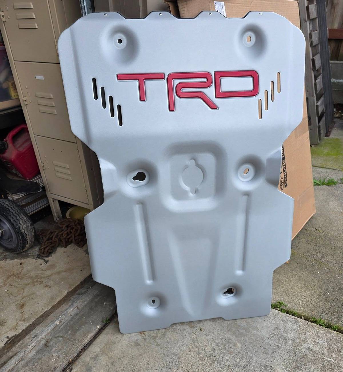

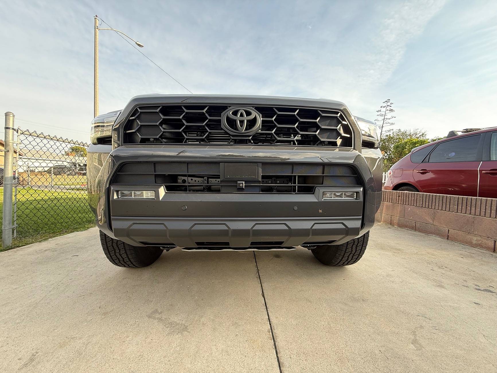

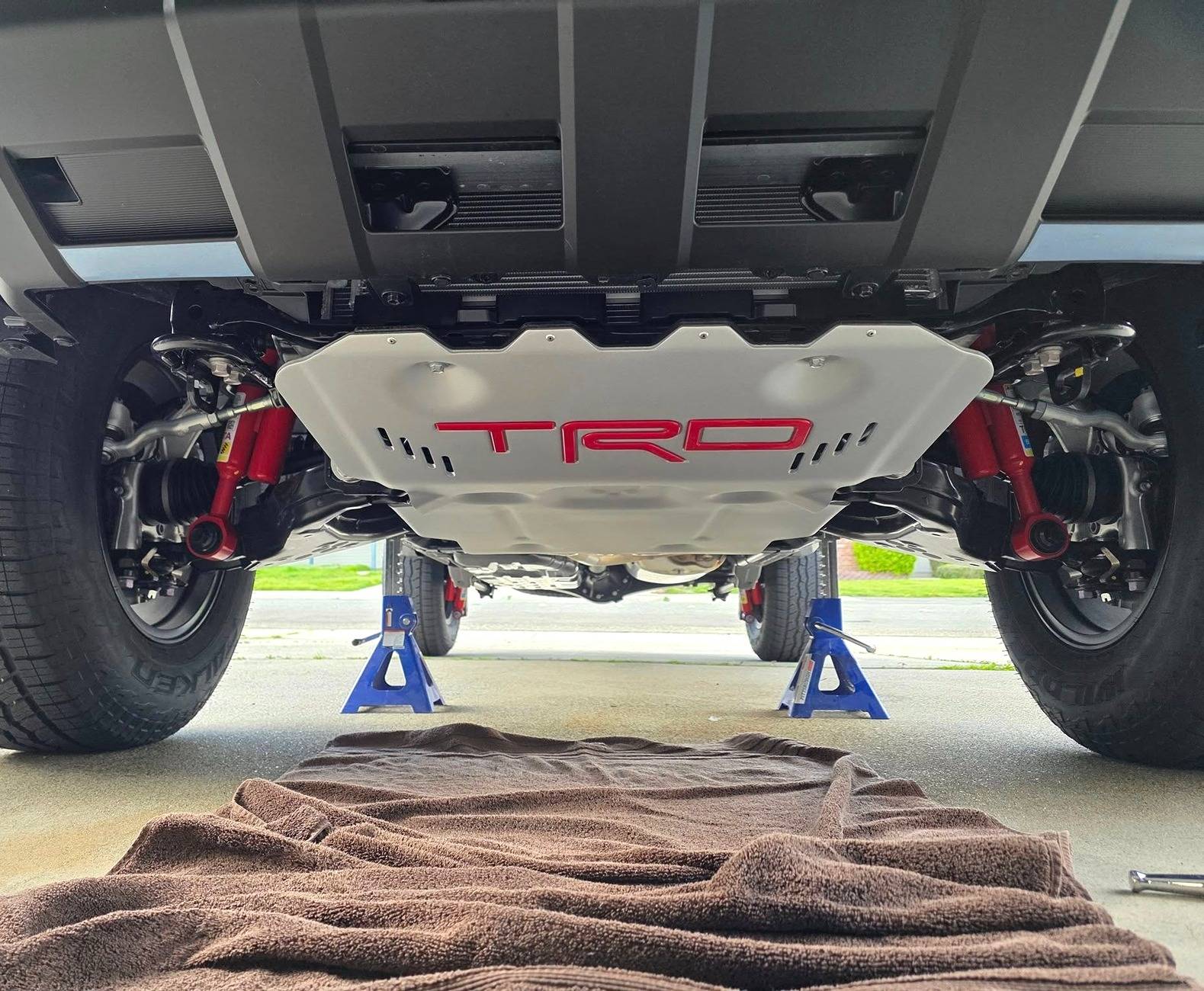

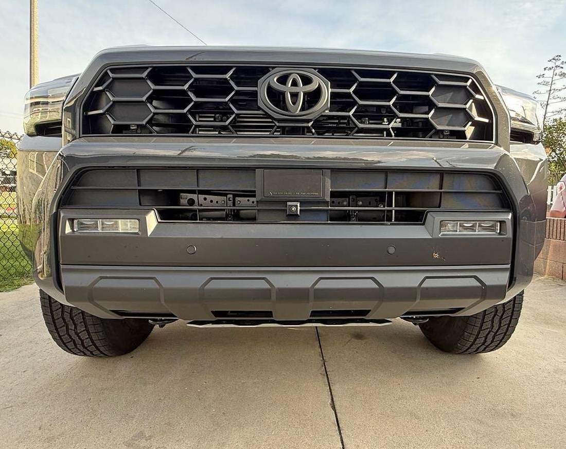

Just put on the TRD skid plate. Installation was a breeze, didn’t even need to lift the vehicle. Just had to remove 8 12mm bolts holding the 2 plastic protectors and then install using 6 out of the 8 bolts you just removed. Yes it felt weird have extra parts haha.
TRD Skid Plate Part Number: PTR60-35240.
I paid $468 at the dealer

That looks great! Can you share the part number # for the TRD Skid Plate?

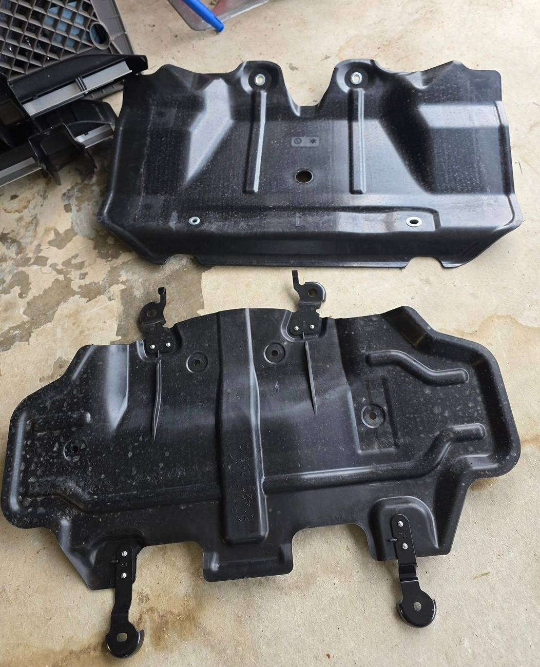

So are you saying that the stock TRD ORP skidplates are plastic?

Yes. They are a very thick plastic but still plastic. They are now in the trash.
Thanks for the reply. That is very disappointing to hear they are plastic.
I want to like the 6th gen, and I'm trying to find a reason to replace my 5th gen TRD ORP, but cost-cutting measures like that aren't helping.

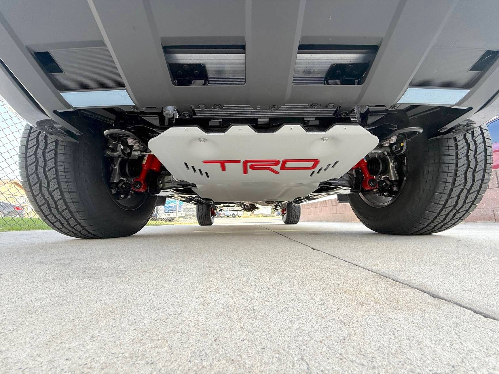

Another TRD Off-Road (@Wutabumr's) with the TRD skid plate installed.

These are the factory stock plastic underbody shield panels.

It would only take one rock puncturing your oil pan to make you wish you would have upgraded; It makes for a tough journey out leaking oil. This is cheap insurance. It certainly shouldn’t have been cheaped-out on Premium platforms!

I ordered a TRD and for them to advertise skid plates then see these is BS! Anyway, we have the TRD pro skid on our '23 but it has an access door for oil changes, and I see this one doesn't, can you change the oil without removing the skid?

I don't think you can change the oil and filter without removing it. It's only 6 bolts.
